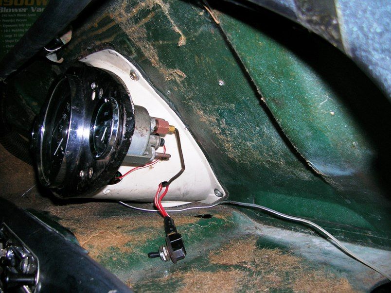

Just found a photo of mine. Looks like an after thought.
[/url]
Thanks again!
Your photo also shows where the panel light lead and oil pressure capillary comes out from the speedo shell to their locations.
That has probably saved me asking another question or 2!
Bill

Not sure if that is the correct way. Next time I have to pull the binnacle off I will try and move the panel light switch wires to the larger hole and stick in a grommet as well. This was how it came when I bought the car and I never changed it.
Edit - Here is the way I have routed the wires now.
