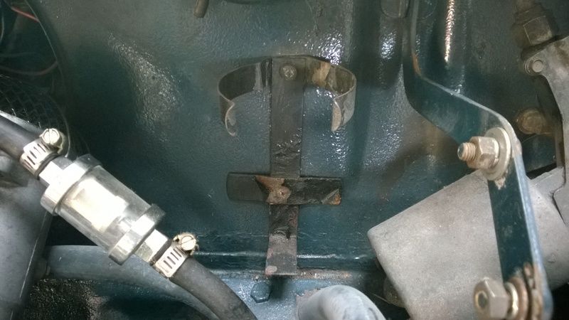

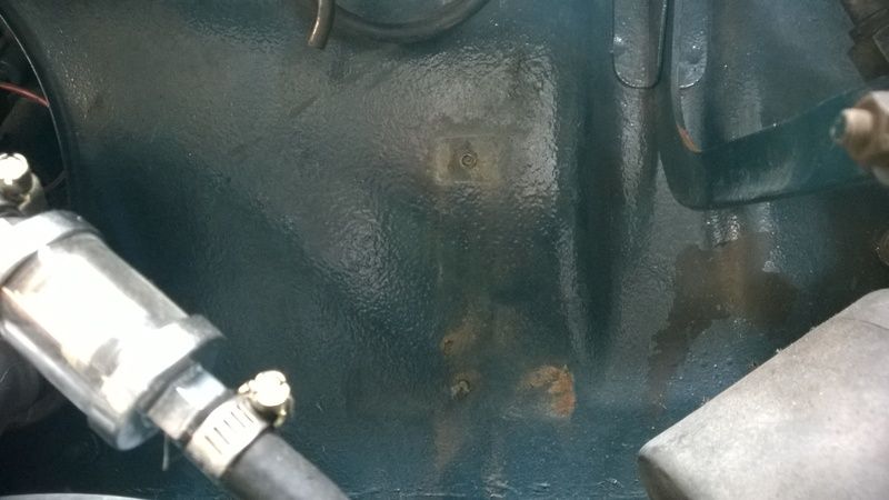

Could somebody please let me know the correct fasterners to hold the windscreen washer bottle retaining bracket to the firewall. During the repaint we inadvertently filled the holes. I assume self tappers?
Thanks in advance.

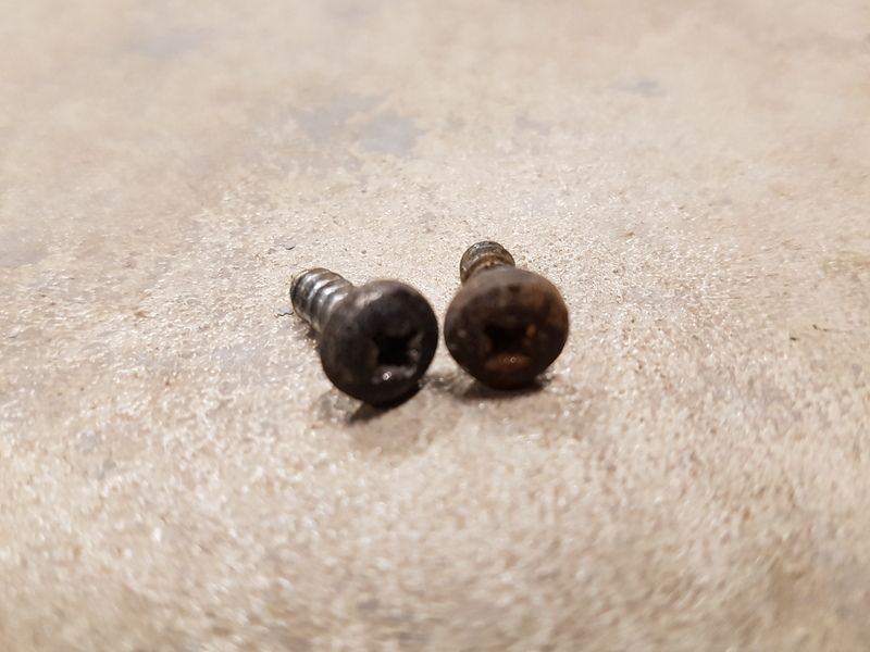

Phillips head self tappers like this.

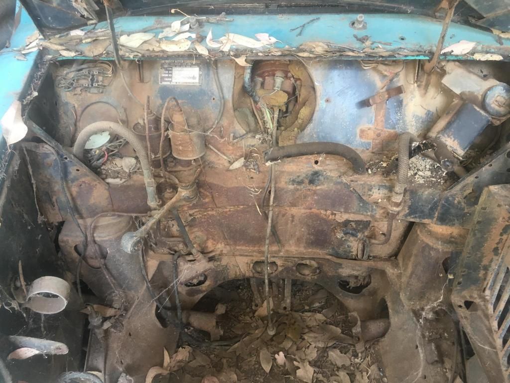

My 69 S has small holes and self tappers. No visible scratch marks around the holes from any washers or nuts. I cut up an 850 shell a few months back and it had self tappers. I remember having to get the impact screwdriver onto it because I wanted to keep the washer bottle bracket. Maybe the CKD cars had the screws and nuts. The UK cars have a screw, 2 washers and a nut listed as the fastener. http://www.somerfordmini.co.uk/eshop/in ... page&id=82

My 68 Deluxe was definitely 2 self tappers.

Maybe they did it two different ways. My '68 S has two self tappers.

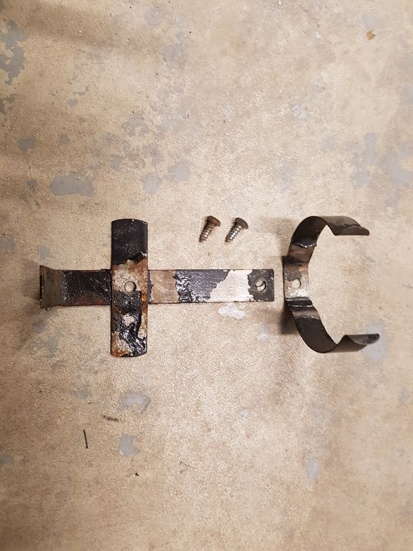

I went to a mini 850 that was a wreck but very origional, the owner gave me the washer bottle bracket & it had never been removed. It was held on with two self tappers.Cheers.

66 deluxe and 67 mk1 S both 2 x self tappers
