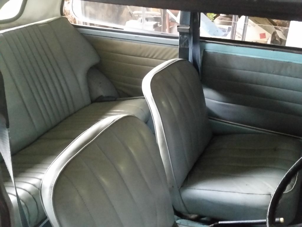

Pic for reference. Not the retractable belt model. Its early 71. This is the one i want to use.. Image

PostPosted: Sat Jan 07, 2017 8:15 pm
Posts: 424
The card you're wanting to use looks like the early Deluxe style. The Deluxe used the first style of windup door (not 'flappy handle') and so the catch area on the body is smaller.
To get around the bigger pillar on your car you may need to use cards with a bit of a cut out.
Attached is a rough cropped picture of what I think is a Clubman card, circa '72.
Note the slight cutout at the B pillar/catch. It also has an extra bit at the bottom for the base of the pocket.
Evan
