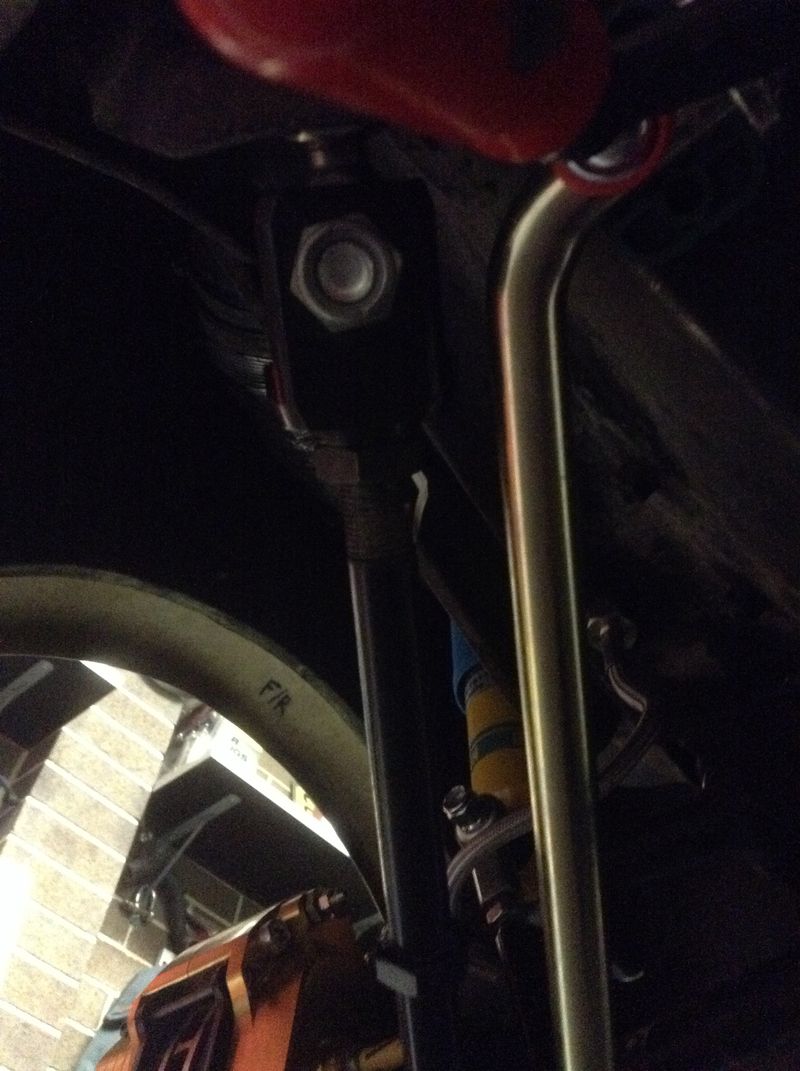

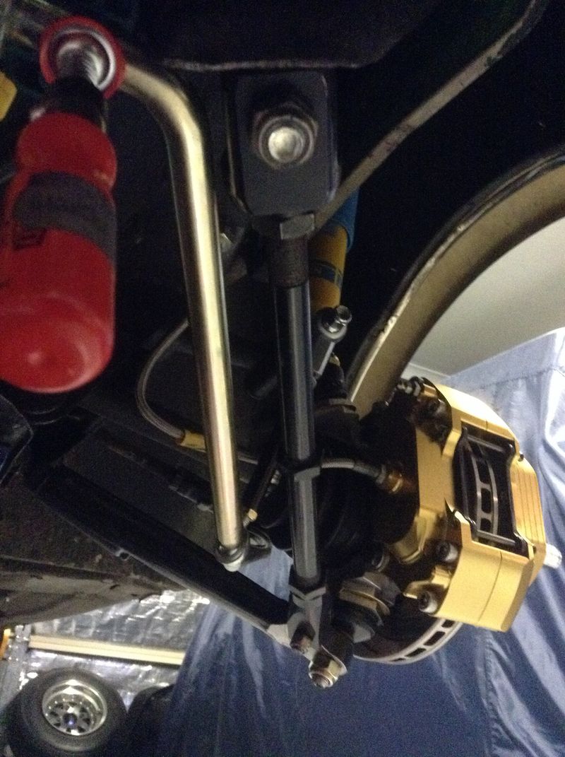

Does anyone have any pointers to installing these correctly. I have encountered a issue where l am coming close to the tie on one side??
The car is up on jack stands, the centre of the car is determined and the centre of the anti roll bar is aligned on these mark. The bar is fitted to the drop links and clamped in place with the poly blocks. All seems to measure up pretty well except at the front corners where it is close to the tie rod one side is 8mm and 15mm on the other, the photos below don't illustrate this. Is this bmc quality control or have l missed something or is this normal?

Have you checked that the bar is equal?
Easiest way would be to draw its outline, flip it and check it against itself.

If there is minimal clearance, will this really be a problem as the suspension AND the roll bar all move together. So the clearance is unlikely to change much ?

Have you checked the lower bump stops beneath the top arm on the subframe? Or if one damper drops slightly further than the other?
