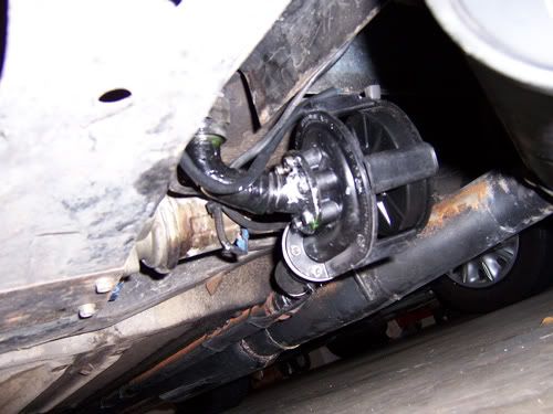

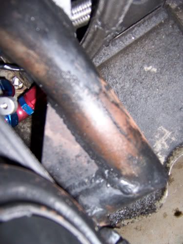

After a few weeks off the road, everything has been bolted back in and the mini is back terrorising the streets. The engine came out, bearings were checked (all good it seems) and the oil sump was resealed. The frame was re-welded with a new gusset where the crack was and a few welds were improved while access was available. Hopefully this should be sufficient to prevent any further breakages. The original plan was to make up a tensioner for the mechanical water pump but after the belt was minced on the first run with no obvious obstruction we ended up going for an electrical pump mounted near the boot. There were a few leaks that needed to be tracked down and fixed so that was also taken care of while it was up on the hoist. While everything was out all the shiny bits were treated to a quick buff. Also, once everything was back in, a wheel alignment was carried out (seems to drive a fair bit straighter now). Thanks to Scott and Nigel for carrying out most of the work for me and hopefully there wont be too many problems in the future.

I'ld be tempted to put some sort of box around that pump.

Being plastic I would have to agree JC!

I've been looking at modifying the radiator scoop so that it picks up more air when on the highway and was planning on protecting the pump at the same time.
