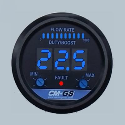

JC - the FMIC water spray nozzles actually sit in the front spoiler directly in front of the FMIC and spray a fine mist into the incoming air.
I bought a CMGS spray controller from Cooling Mist to control the spray pump for the FMIC water spray. It should work a hoot and it looks the goods too:
(Edit: New picture)!!!
