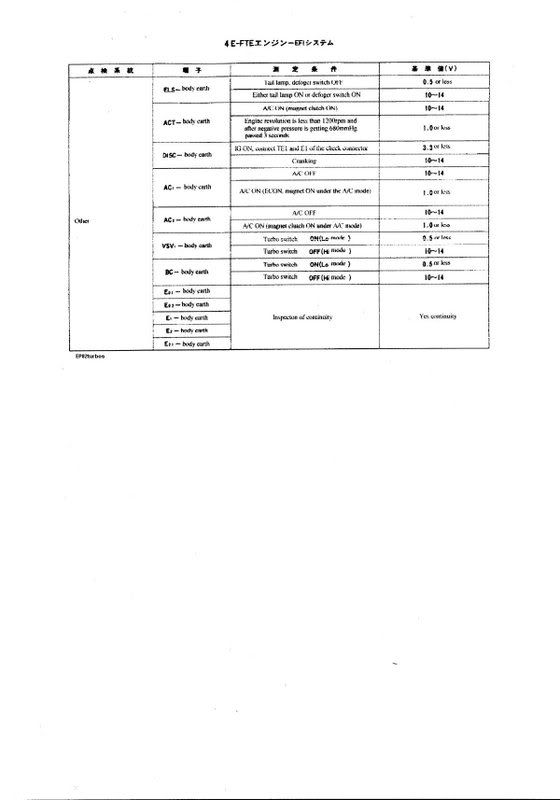

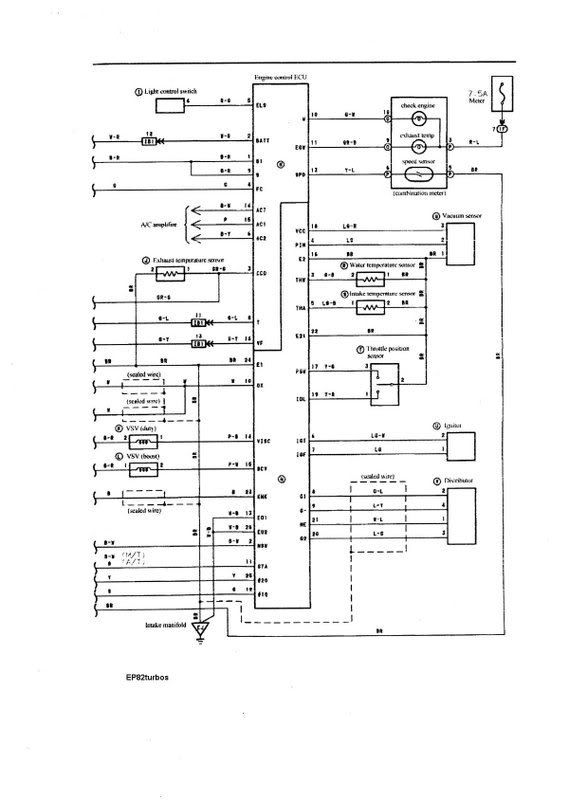

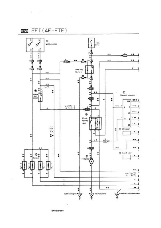

Hey guys need some help
has anyone sourced a wiring loom or documented what they have done.
cheers Hallsey
PostPosted: Wed Mar 19, 2008 7:44 pm
Forum Graffiti
Posts: 1640
Aaahh.. I had a pdf of all the looms here somewhere.. can't find it! :evil:
PostPosted: Wed Mar 19, 2008 8:18 pm
Posts: 338
try this it is what I used just have to blow them up a little and stick it together
4efte powered Clubman
supercharged 998 race car
PostPosted: Fri Mar 21, 2008 5:26 pm
cheers Hallsey
Hi Hallsey,
I have all the wiring diagrams scanned and in soft copy format.
PM me if you want a copy!
Tricky

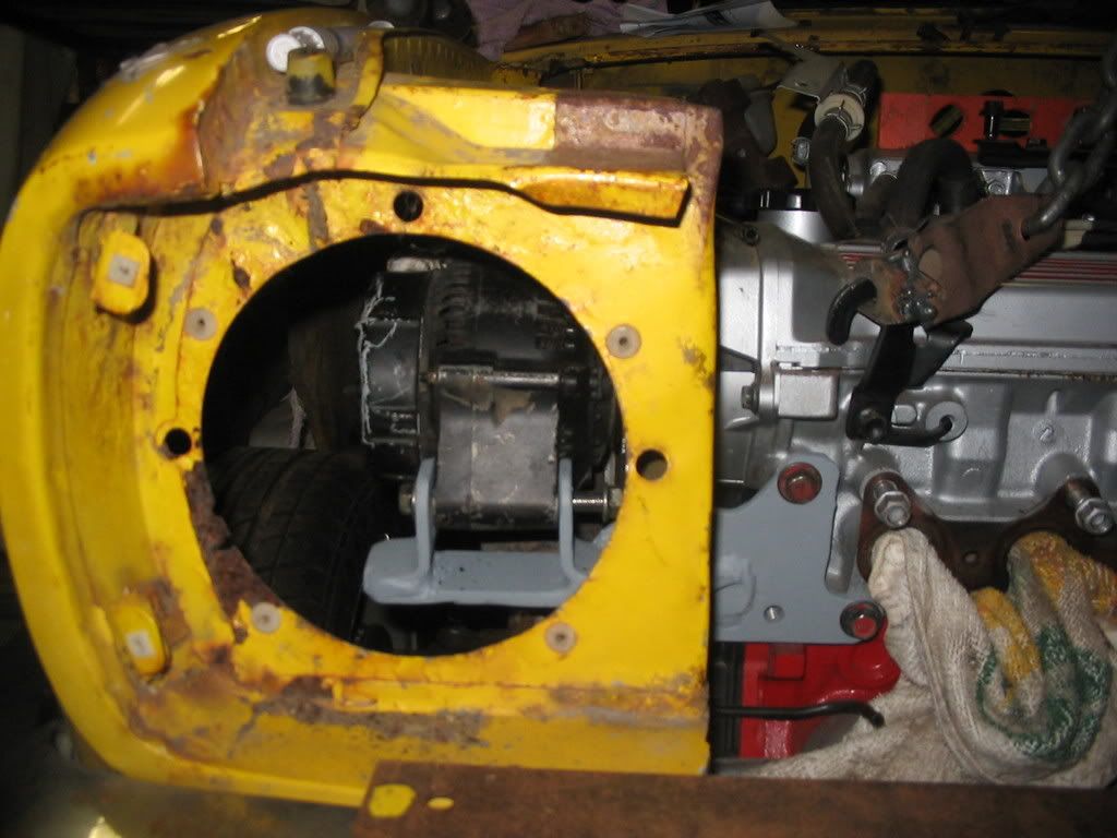

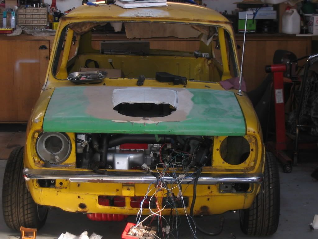

Time for a small update,most of this stuff you've seen on the other builds
but i suppose it shows the progress.

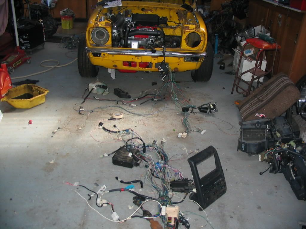

I have started some of the wiring,but it's a slow fiddly job. (Thanks Tricky and 92)

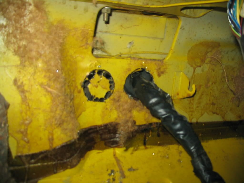

The holes for the two harnesses
Just one of the bonnet

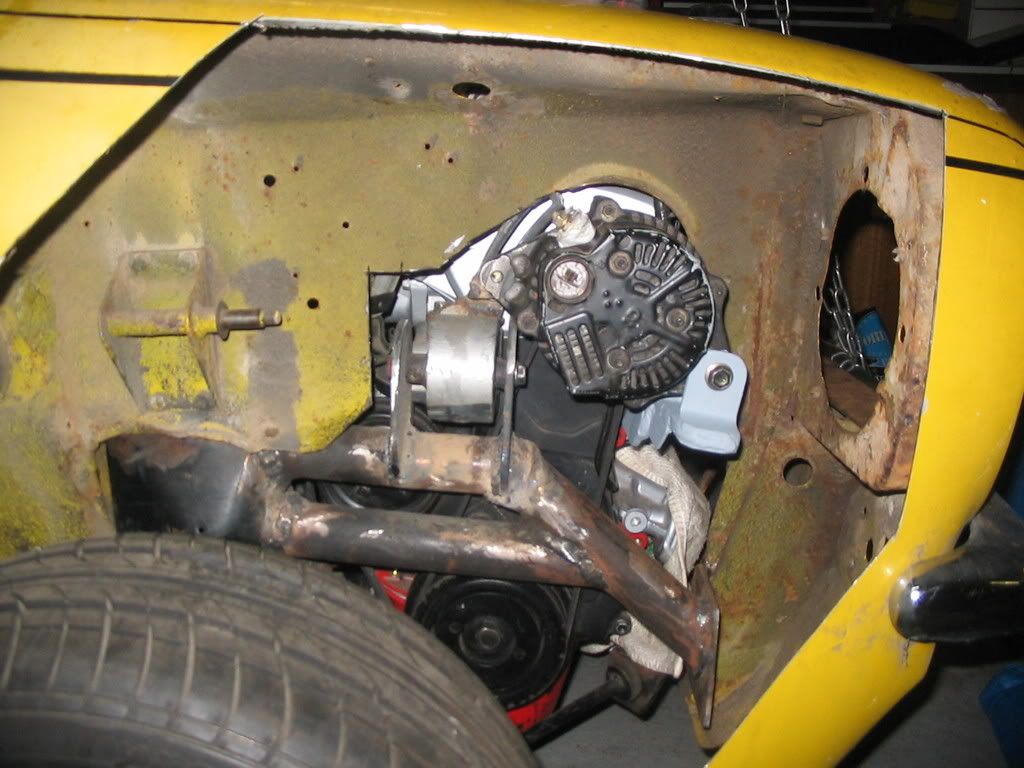

I started to fit the alternator and was finding it difficult to hold,line up etc
on my own so cut out the gaurd for ease of access
I made this bracket up for the alternator but have since changed it

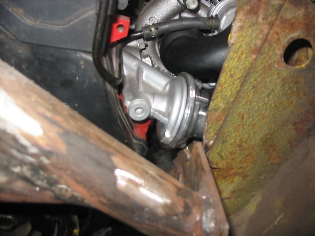

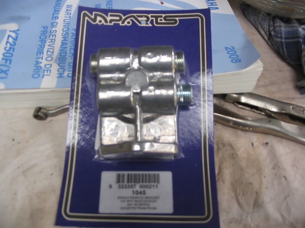

I also got part of my remote oil filter kit

geez your gunna havefun with the gaurd? how are you going to put it back in? just weld in a new one or the weld the peice you cut out

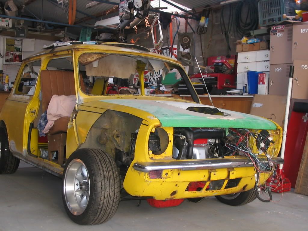

The yellow car is just a dummy - the 'real' machine is red and ready for the donor once all the fab work is complete.

I know the yellow clubby is a mock up car but that is painful to see that done to a mini :( honestly how bad is that mini :?:
PostPosted: Wed Jul 09, 2008 8:46 pm
Posts: 404
Me ol mate Tricky's right on the money there dbr11k,old yella is just the crappa drill, cut , grid and drill a hole in the wrong spot and say "woops oh well' instead of aaaaahhhhhh ive driiled a hole in the wrong spot on my
baby.
Simply Red is the car everything will be going into once i've done as much as i possibly can

I know the yellow clubby is a mock up car but that is painful to see that done to a mini honestly how bad is that mini
na i reckon it looks good "puttin speed holes in ma car, makes it go faster"
