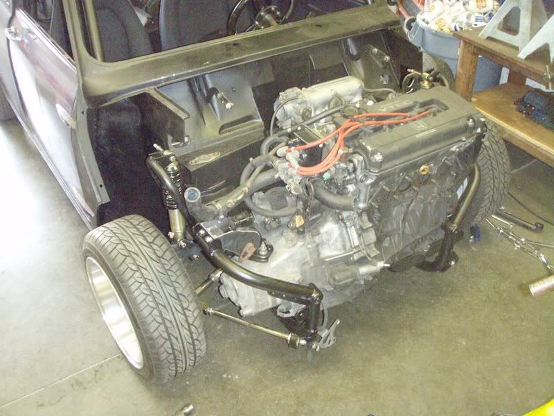

Here are a couple quick pics. I have to move my car tomorrow so I had to hammer out some work in the last few days so I didn't take many pictures. The few I did take didn't turn out too well, some settings on my camera have changed and I didn't know it.
I'm moving my car back home at least for a while, hopefully I will get some more work done on it since I don't have to drive across town to work on it any more. However I will be taking a small break from it to get my other Traveller rolling again so I can get it out of my work area at home. Then I need to finish welding a few panels in another Mini shell so I can trade it to a friend for a couple paint jobs and just to get it out of my way.
I was thinking if the VTEC thing didn't work out I will have room for other swaps. Small child power has not been done, I could be a pioneer. Not sure how quick it will be or what kind of range I will get. Lizzy is nice enough to share her shop with me, so I share my Mini with her. She likes to play in it, and she also drives it when we move it around the shop.

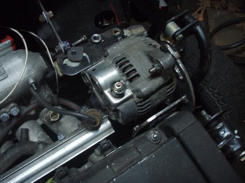

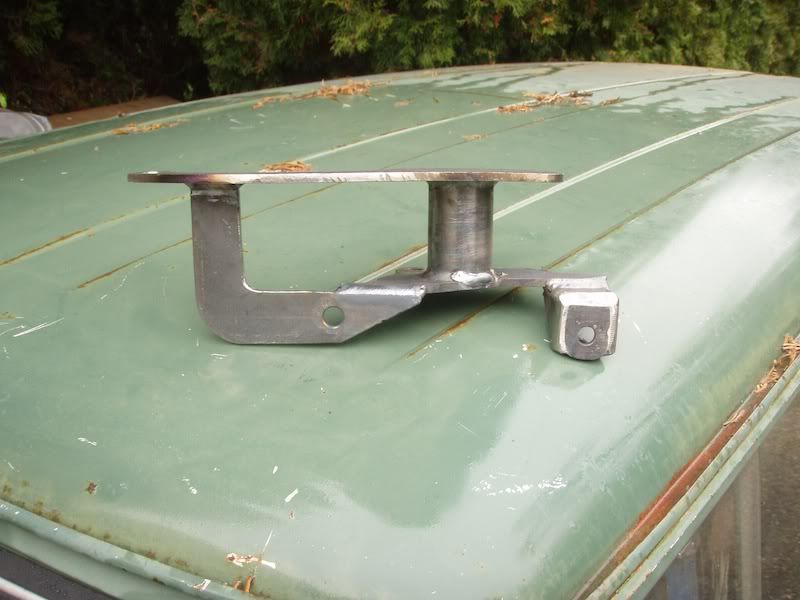

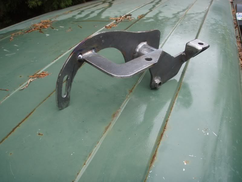

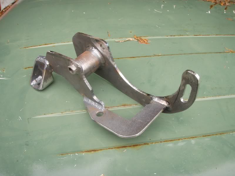

I started from scratch but based on a bracket from MiniTec I built myself an alternator bracket, I mostly just need to finish up the welding with my TIG. I cut the shapes out with the plasma then fine tuned them after. I made a spacer on the lathe and then I started tacking it together. Then I set up a laser to align the pulleys before I made the final tack welds. I unbolted the alternator and did a couple more tack welds and bolted everything back together. Everything still lined up so I will work on the final welds tomorrow after I triple check. I'll take some pics after the bracket is finished and it's off the car. I do also have to add another idler pulley to make sure the belt doesn't foul the subframe. This bracket tucks the alternator close to the engine and it kept me from mounting the alternator backwards in the fender well which will also make it easier for making inner wings later.

Here is another update, I popped home at lunch and finished up most of the bracket, just have to add an idler pulley now and the paint it or have it powder coated.
