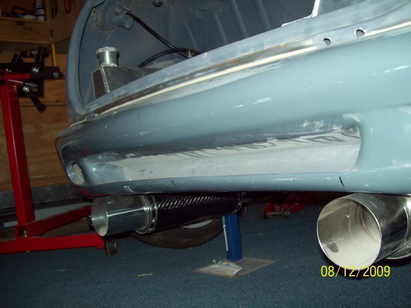

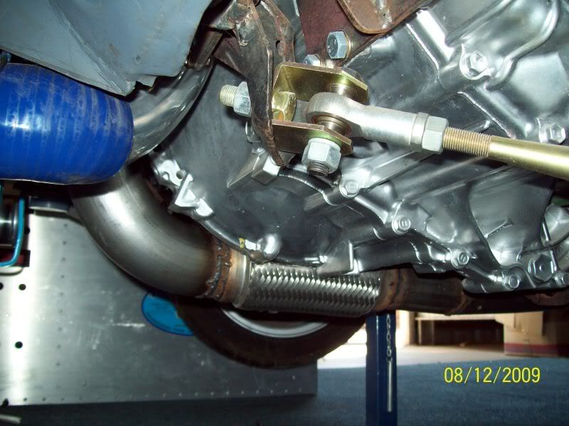

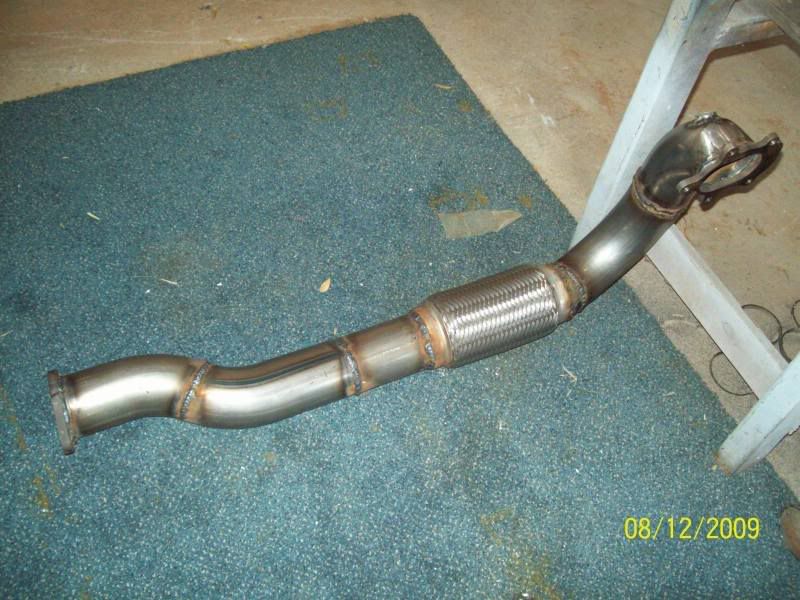

Anyway, its hot. Damn Hot!! Finally finished up the exhaust today, so now it is fully complete from one end to the other - yippee!! :D Its now a full 3" all the way through.
Dump pipe fully complete up to the 3" cat and with new stainless steel flex

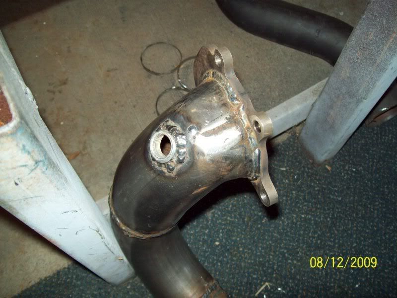

O2 sensor tap is in

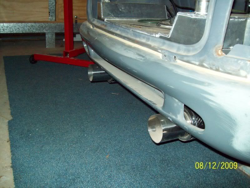

In position and bolted up - ground clearance is about the same as the rear cannons

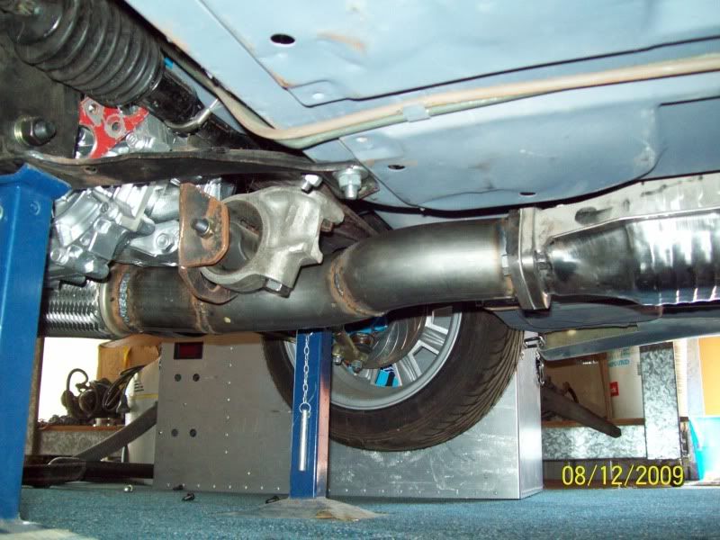

Joining onto the rest of the exhaust at the 3" cat
And for those who forgot what it looked like at the ass end, her ya go
More later,
Tricky
(Did I mention its HOT??)
