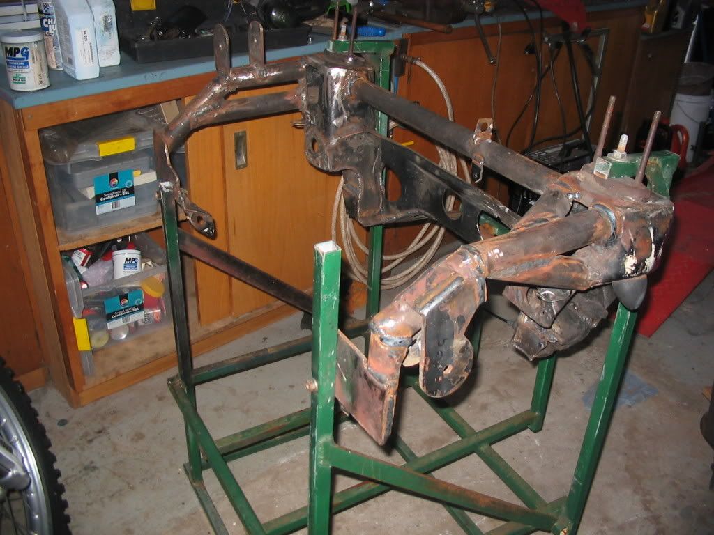

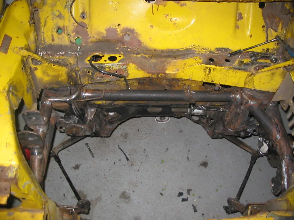

Hi guys, It's been ages since an update so i thought i better keep
you up to date.
The kids MX racing is finished for the year so i have my weekends back
and some cash for the mini

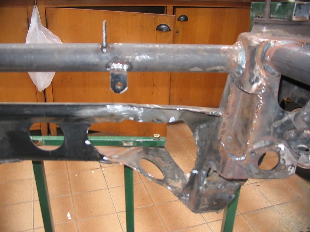

It doesnt look like much has happened but i suppose i've progreesed a
fair bit. I pulled out the subframe again to weld in some tabs for the
brake hoses etc
Then back in again so the engineer can have a look. On the subject of
engineers,i've changed engineers due to circumstaances i wont comment
on. My new engineer is Frank Fordham,the same one mad morrie is using
and he seems very helpful and even a bit excited about the build
PostPosted: Fri Nov 14, 2008 7:43 pm
Brilliant work Halsey, cant wait to see it up and running.
PostPosted: Fri Nov 14, 2008 9:35 pm
Posts: 604
Location: caboolture qld
subframe looks like its ment to be in there. good job mate.
Cheers Dan

Hey Hallsey, looking good there mate.
Frank seemed like a nice enough bloke, and every time I called him he was happy to talk for half an hour or so about things relating to the build. He was hard to get hold of for a while there (working away from home I think), but my build is progressing so slowly that it hardly mattered.
What radiator are you plnning to use? That seemed to be his biggest beef with my build in the end. Maybe it was just the one that annoyed me the most, cause I had just spent $300 bucks on a re-cored rad that he reckoned wouldn't be up to the task.
Who is doing your welding? Mig?
I'm just stick welding mine but will probably get someone else to do the final welds since I'm not trained or anything.
I still have that intercooler cover, but it is cracked so it may not help you. Anyway, yours is looking tops, can't wait to see it on the road.
Madmorrie

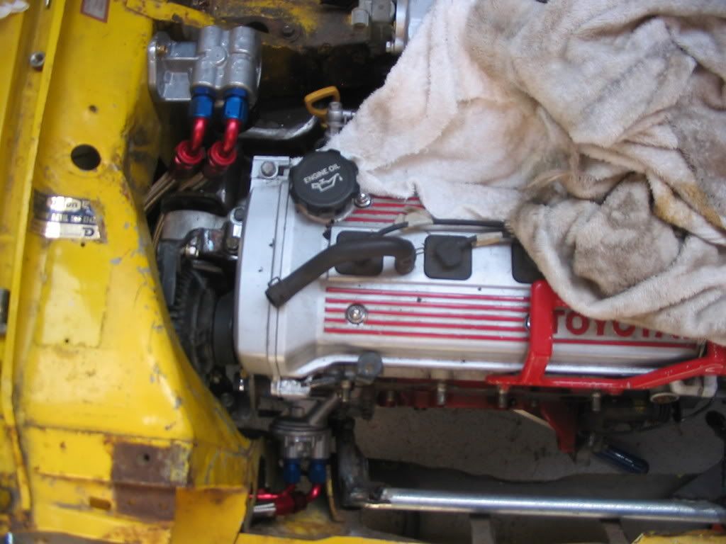

nice work there mate.. how come the oil filter is sitting so far at the front?.. I got it sitting so I didn't have to move anything...
The red car looks good.. it will look identical to Ben's car! :D
PostPosted: Sun Nov 16, 2008 9:04 pm
Posts: 3981
The filter location looks bang on the same as the 5 or so I've seen Pubs.

Woops photo's didnt work ,must have been half asleep (as ususal)
Tricky : Icant wait either, I'm "toeier" than a tiwanese thong factory
Badassmini : Thanks mate, i'm reasonably happy with it
Madmorrie : Yeah Frank seems pretty excited about it all,the first visit
went pretty well, he mentioned the rad and i just said i was going with
a custom alloy one and he seemed happy with that.

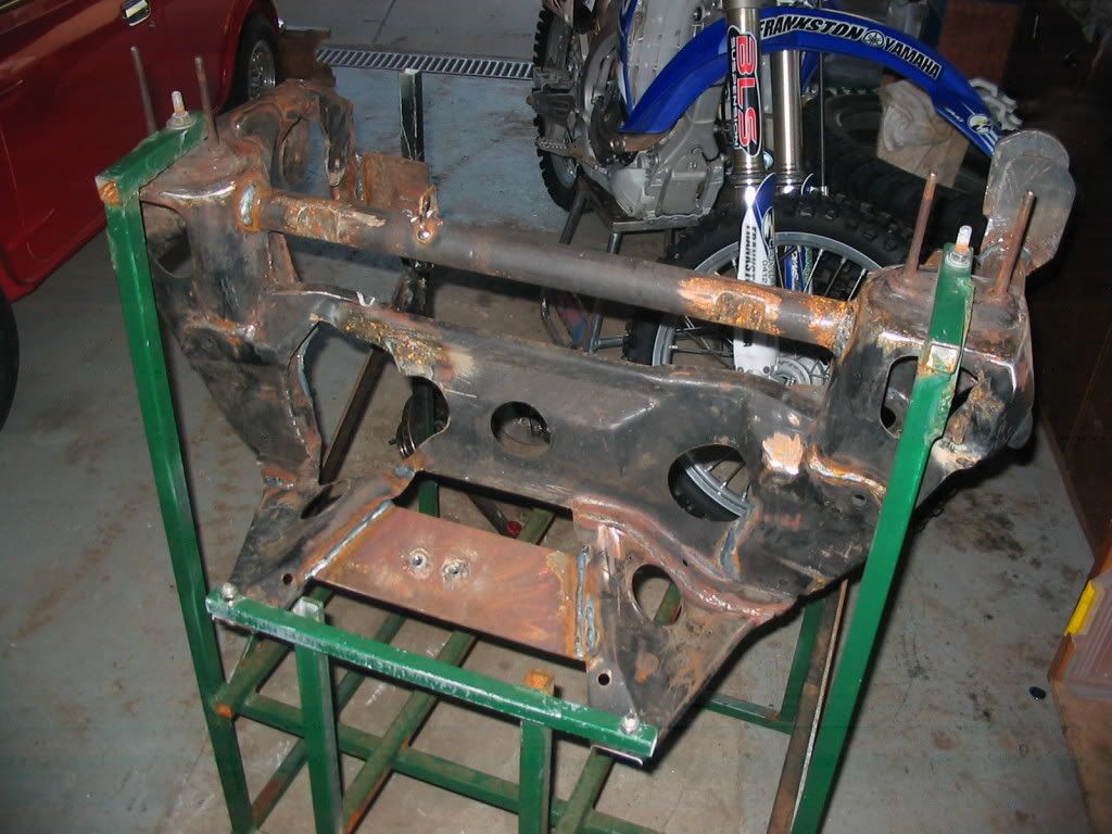

I"ve pretty much tacked everything with a mig at home, but its a cheap
crap one . we have a big ass mig at work and one of the guys i work with
is a certified welder so he done it for me.
I would have done it myself (at work) but after i was reading your page
when Frank said about getting someone else to weld it, i thought i"d play
safe and use Paul (and his ticket)
Pub : Our subframe designs are a bit different , maybe thats it,or photo angle? As JC said it has the oil reloctor on it too
cheers Hallsey

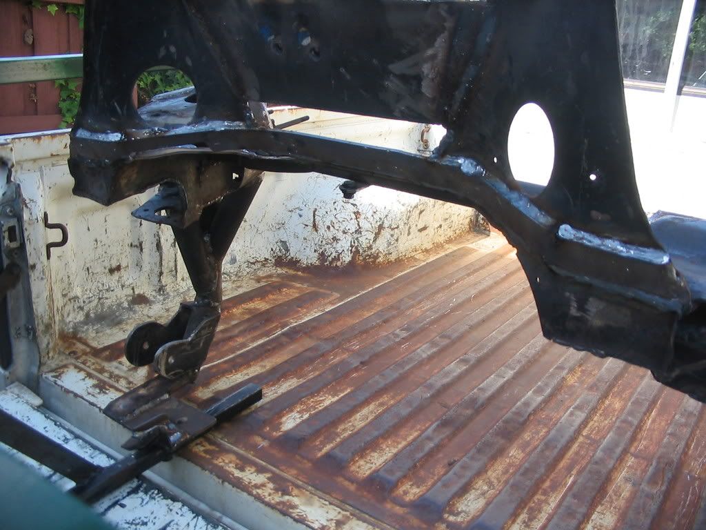

PostPosted: Sun Dec 28, 2008 7:20 pm
Posts: 404

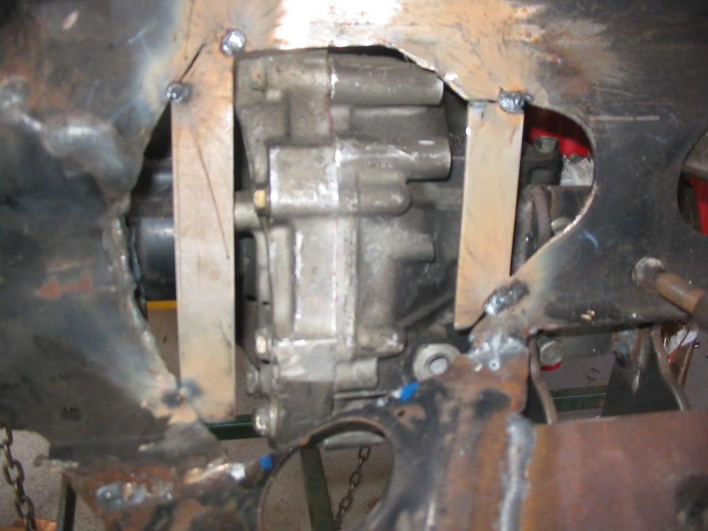

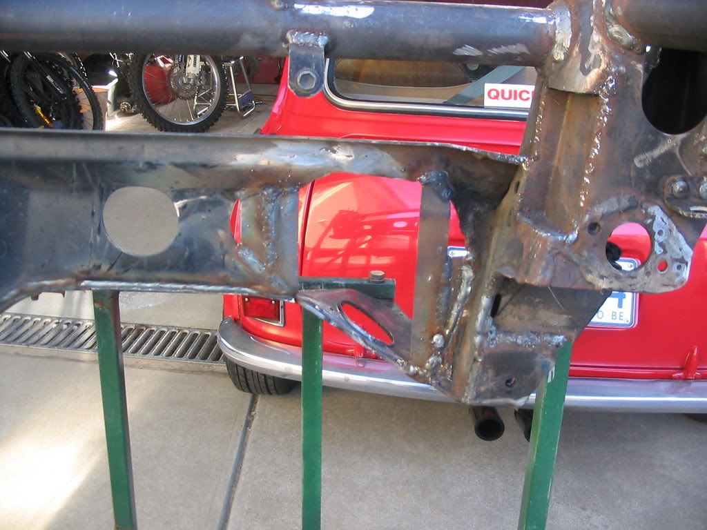

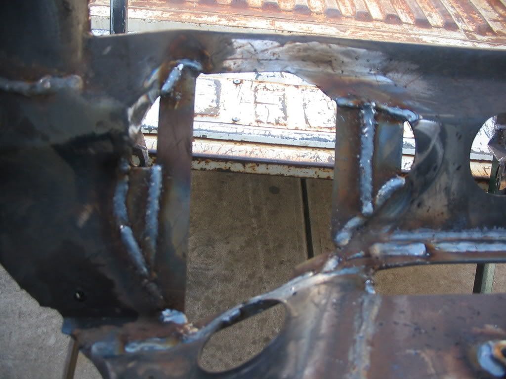

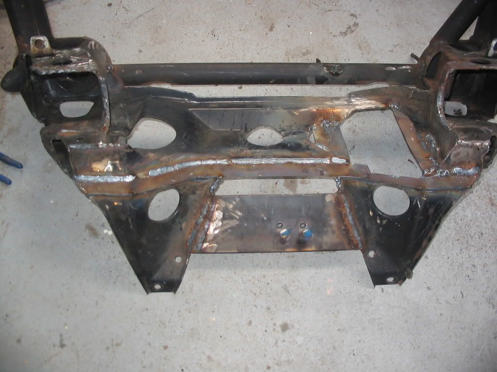

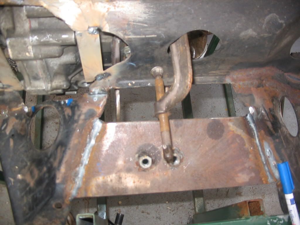

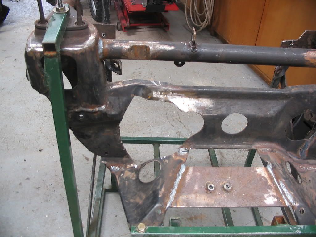

Hi guys ,been flat out with work and kids but have got a bit done
so heres a bit of an update, the engineer wanted the hole for the
gearbox filled in a bit and a full brace across the bottom
Heres a couple of shots beforehand
Filling in the hole
The hole filled in
A couple of the bracing
cheers Hallsey
PostPosted: Mon Dec 29, 2008 1:44 pm
Looking great there Hallsey!
Your welding is looking top-notch too.
Not long to go now eh?

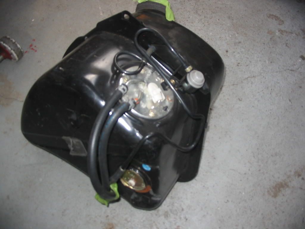

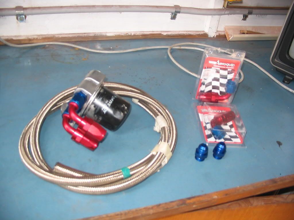

Ho ho ho merry chrismas and happy new year to all.
Santa left a couple of presents for "simply red" under the tree
Some braided line and fittings and a rover EFI tank :D
And i could'nt wait to fit them up
Progress is slow but sure
cheers Hallsey
PostPosted: Mon Jan 05, 2009 9:17 pm
Joined: Tue May 01, 2007 10:18 pm
Posts: 114
will the efi rover tank pump enough pressure to supply the fuel rail? or will you be running a secondary HP fuel pump?
PostPosted: Mon Jan 05, 2009 9:33 pm
A secondary pump i would believe.
PostPosted: Tue Jan 06, 2009 10:06 am
Posts: 4031
I was just going to run the Rover pump on my car along with a regulator. I guess we'll see if it works soon....
PostPosted: Tue Jan 06, 2009 10:21 am
I have no idea what the Rover pump is rated at, but you are going to take the pump from a car with less than half the power and possibly quadruple the power the last thing you want is for the fuel supply to lean out.
Especially for a second hand unknown condition pump.
What's ~$150 for a new Bosch fuel pump?
I'd personally look at using the Rover pump as a sort of surge tank scavenger pump that would feed a secondary more beefy pump.
