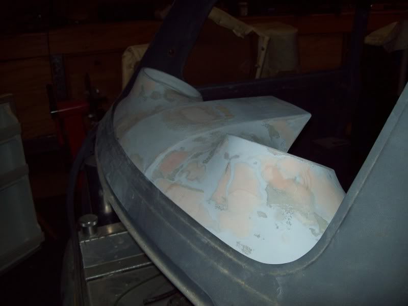

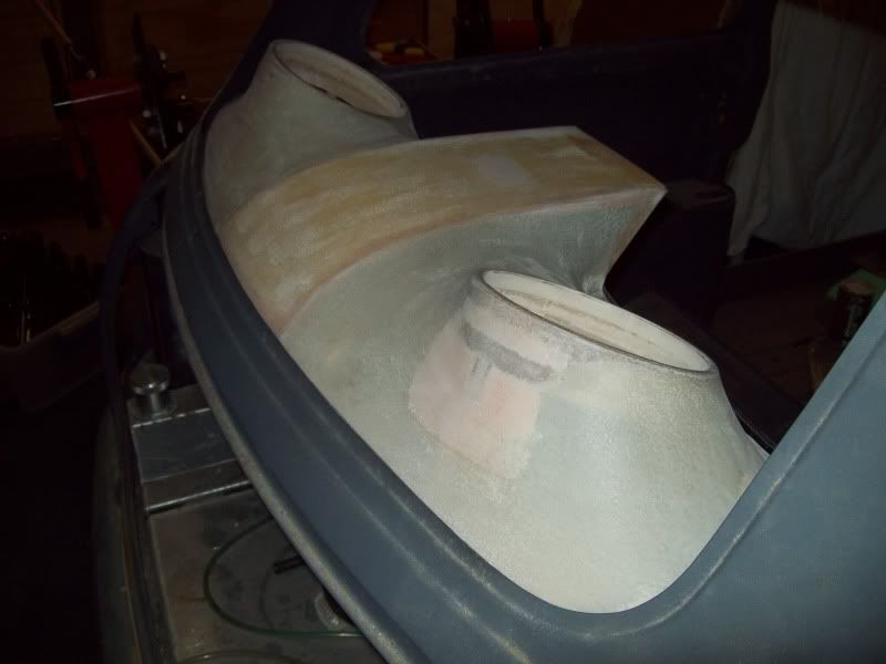

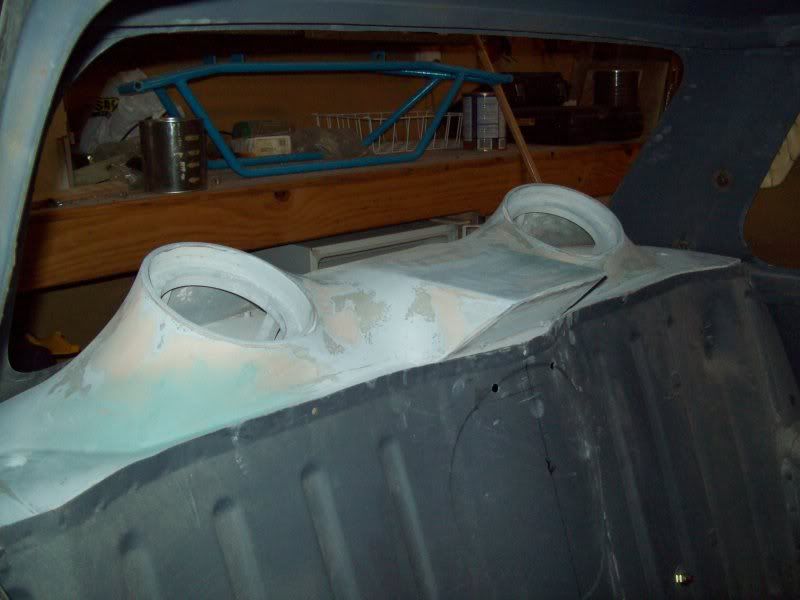

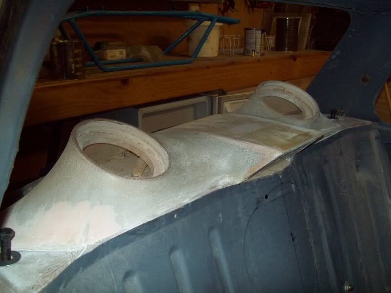

So, the first part I redid was the rear parcel shelf piece that holds the rear 5 1/4" coax speakers.
And in position on the parcel shelf. Seat belts altered to fit the new mounts.
Bogged and sanded, then hi-filled and sanded:

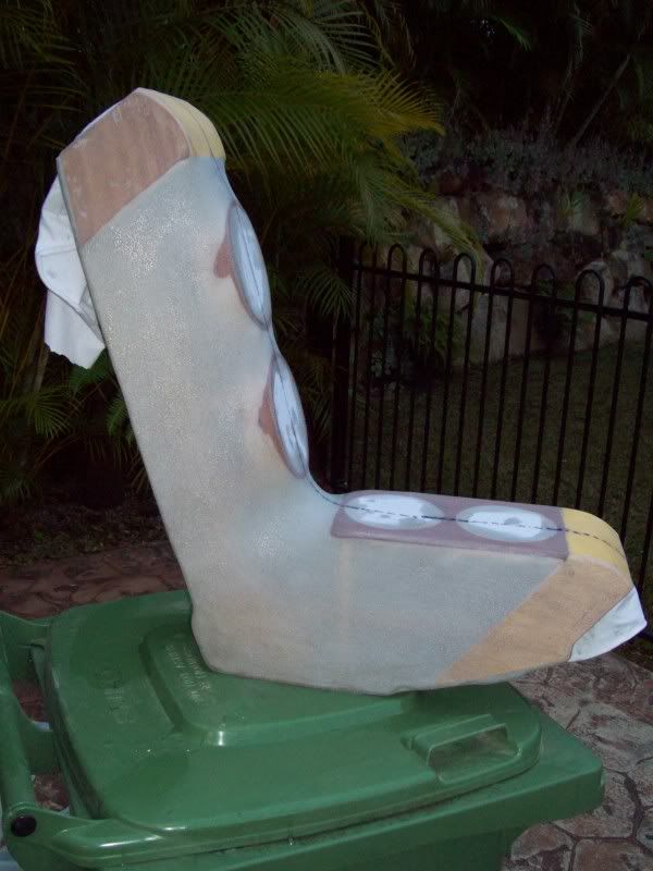

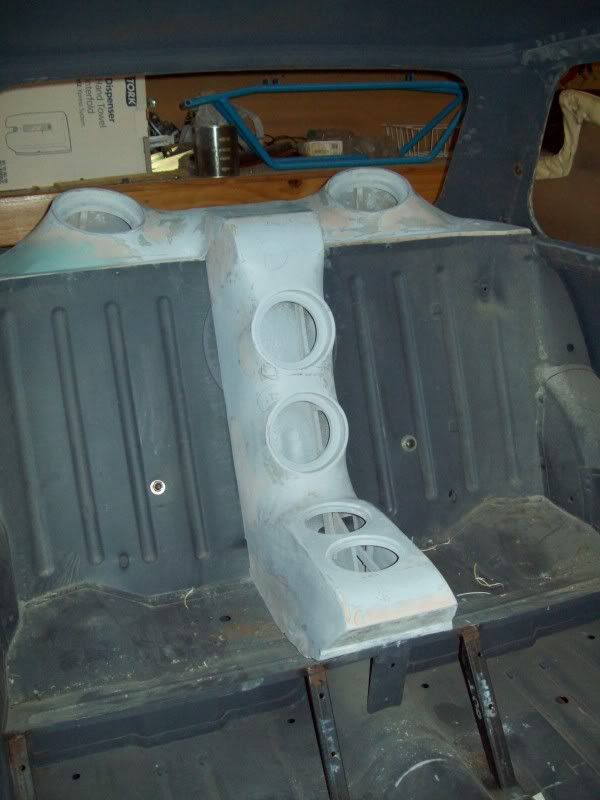

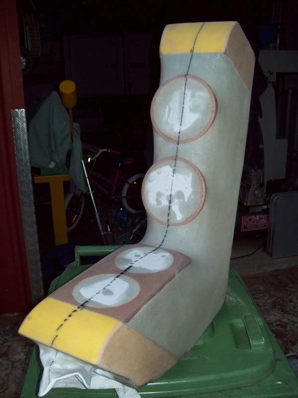

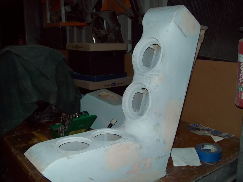

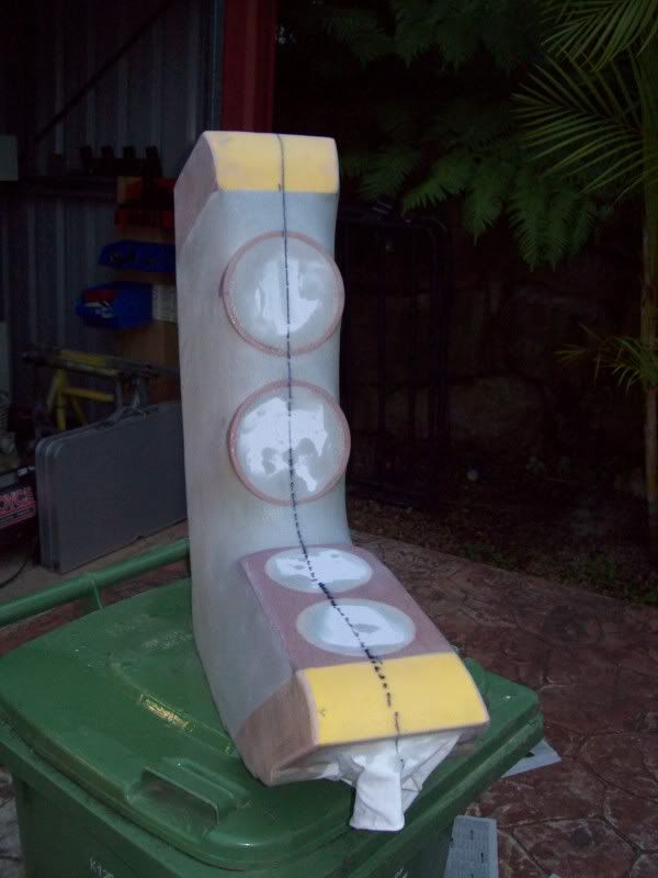

Then, I redid the centre rear console which houses the 4" mid bass speakers. Originally there were 4 of them, but this time I decided to only go with two, and have 2 drink holders instead. The other two 4" mid-bass drivers will go in the door pods to complement the splits in the doors.
Firstly, I made a back for the console by taping the seat back (rear firewall and then fibrglassing it with 4 layers of matt and then pulling this off and trimming to size. Then you have to make the body of the enclosure. you start by making the shape, them cover it with fabric, and then resin it,

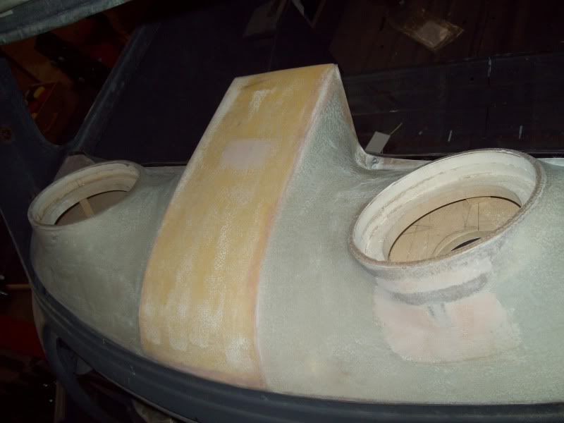

Then is a case of a layer of fibreglass and then bogging and sanding:

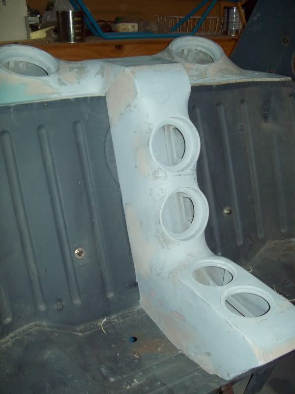

Finished and in position:
Mated to the rear parcel shelf enclosure. And because the back is a erfect mould of the seat back, its fits superbly.

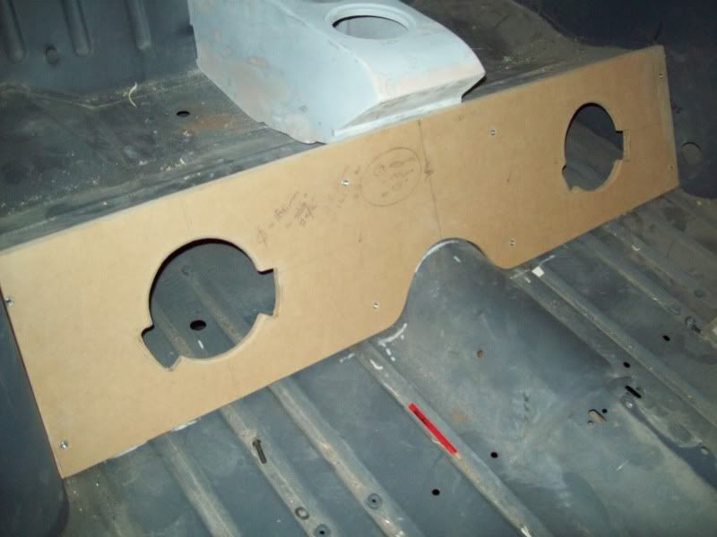

Then, I started on the bass board under the rear seat which houses the 2 x 8" subs, started that but its not quite finished yet.
