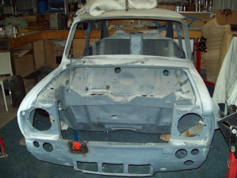

Big day today - gave the shed a good clean (ongoing) and fully stripped El Gato ready for him to be put on the dolly tomorrow morning which will allow me to wheel him outside to do all the wet sanding and spraying etc. Just a bit of interior stuff to remove.
And here he is all bare and naked:

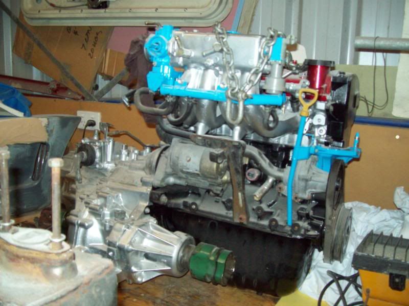

With the engine standing forlornly on the bench:

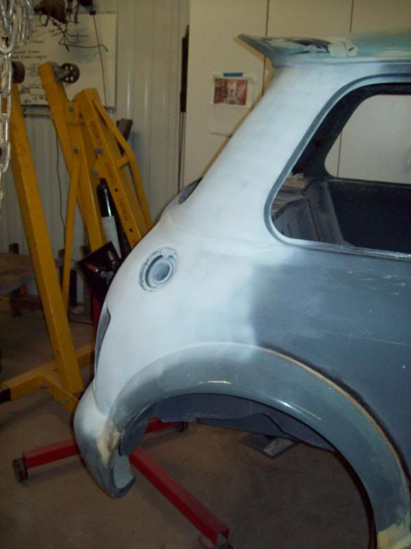

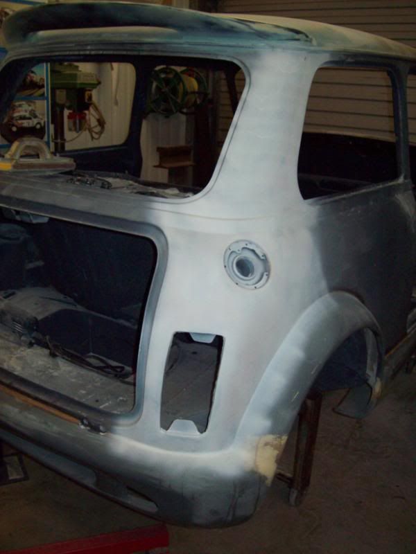

With the front drivers side guard being completed, I just decided to work my way around the car in a logical manner so I wouldnt miss anything. So, this weekend I tackled the drivers rear quarter.
This area was a bit problematic as in a previous life The Cat had a shunt in this corner. It must have only been a slight Liberace as the panel was beaten not replaced. Suffice to say that the repair was not finished by the PO.

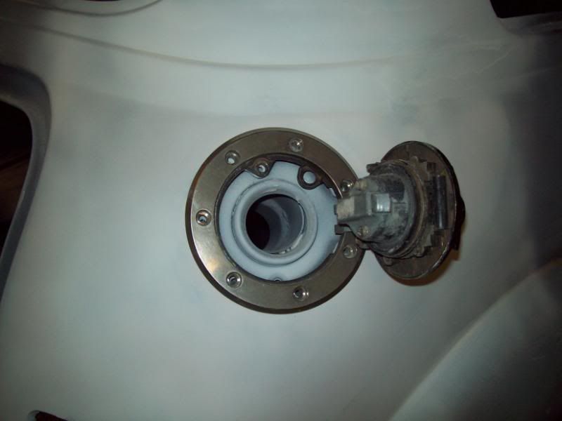

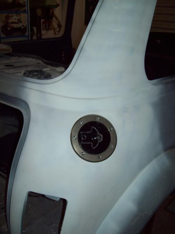

Not being a body man, the corner was more difficult than standard because of compound curves and then a flat section for the motorcycle fuel filler which needed to be perfectly flat to seal. Anyway, after a weekend worth of beating, filing, bogging and sanding I think I have it close enough so the high-build will take out all the minor imperfections:
And for those who haven't seen the motorcycle fuel filler in situ:
This weekend, being a four day weekend, I am hoping to have the other corners finished and the first coat of high-build on the whole car. Its getting there slowly, but I am happy and very excited with the progress. Hope you guys are too!

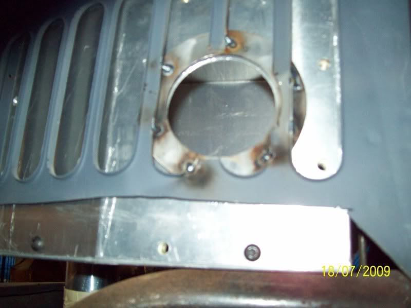

Tricky - I just had a quick look back through a few details and I have a question about the air filter box (mounted in the Mini radiator position). You mentioned there will be a K&N filter in the box but it looks like the whole thing is sealed/welded. How do you get the filter in/out of the box?
-Alan
PostPosted: Wed Feb 01, 2012 8:19 pm
Thanks Hallsey, mate your encouragement keeps me going!!
Hi Alan, there is a K&N air filter inside the air box. The face of the box that mates to the radiator grill of the guard actually detaches. You would never know that unless you actually looked up inside the passenger side guard. The reinforcing ring that you see is welded to the inner guard to reinforce the grill.
Here is a pic showing the removeable panel in situ:
Because the airbox will be pressurised by ram-air, there will be a foam gasket around the opening to seal it off. So basically, you install the air filter, seal the air-box, and then install the air-box into the car, before the brake booster.
Hope this helps.
Tricky
