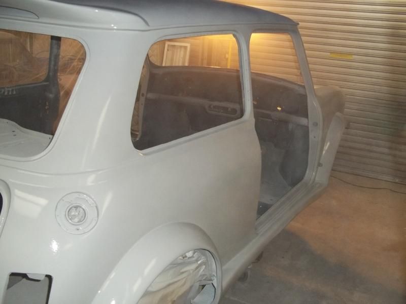

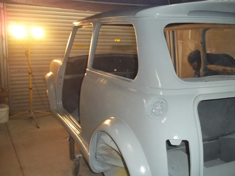

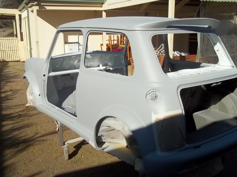

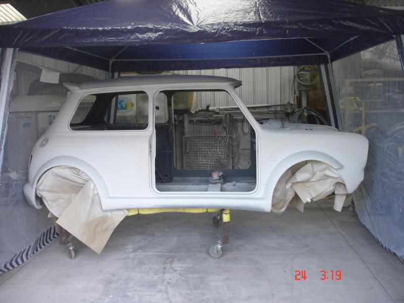

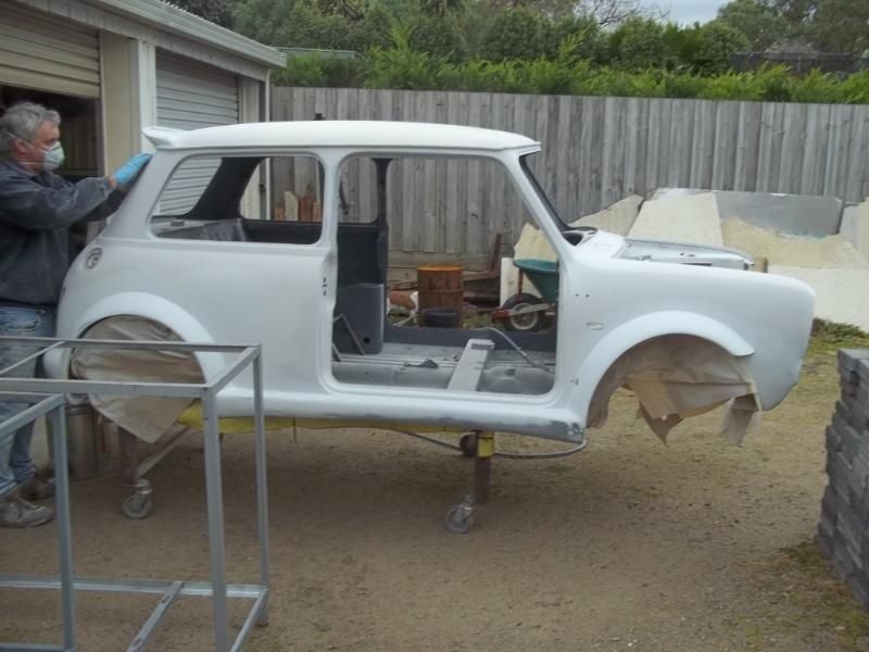

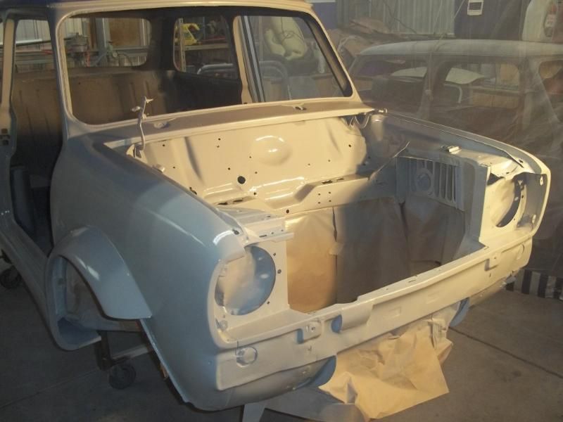

The guys continued on with the bodywork last weekend, and had the car in epoxy and sanded. Next week shall be more of the same with hi-fill and more sanding prior to the colour going on.
Its now straighter than when it left the factory - and looking so damn good!!

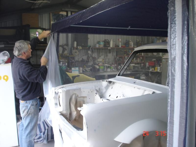

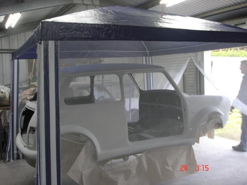

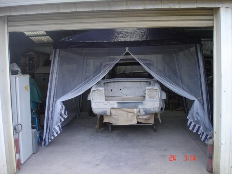

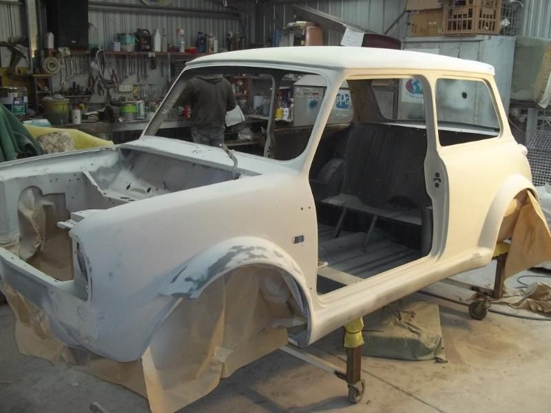

And here is the "Taj Mahal" for housing El Gato when the lads need to keep him incubated and dust free:

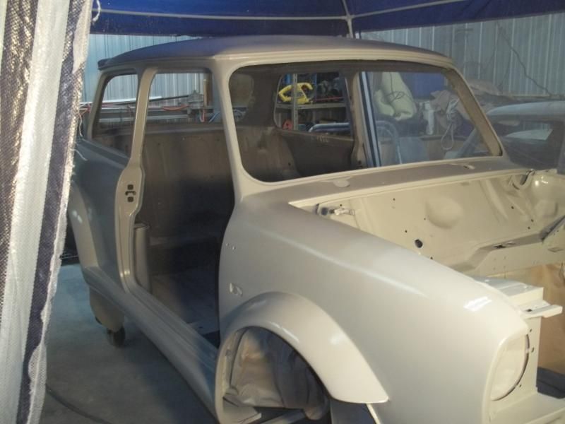

And finally side-profile - damn he looks sooooooooooo good - no seams and oh so straight!!

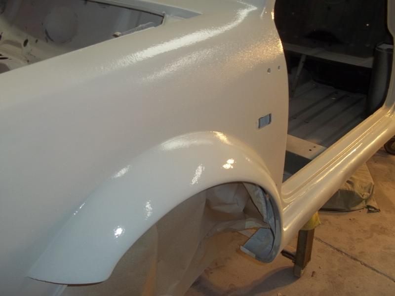

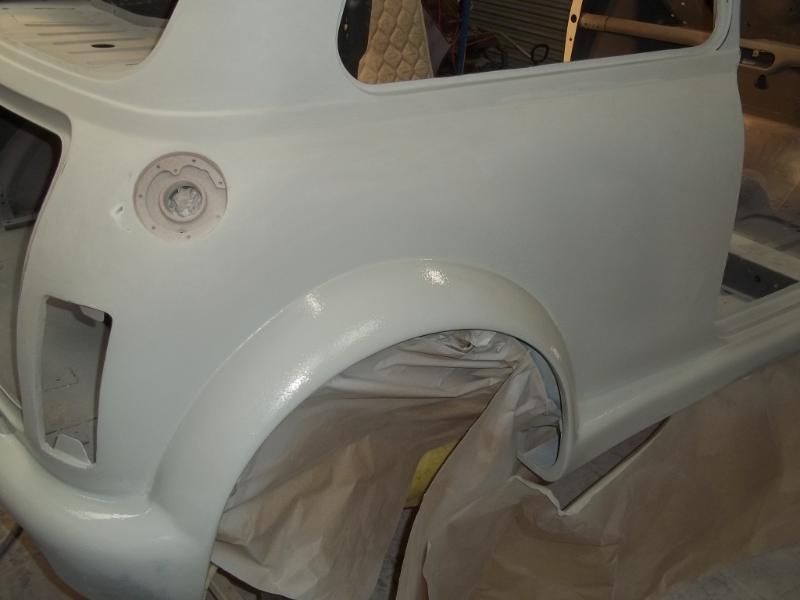

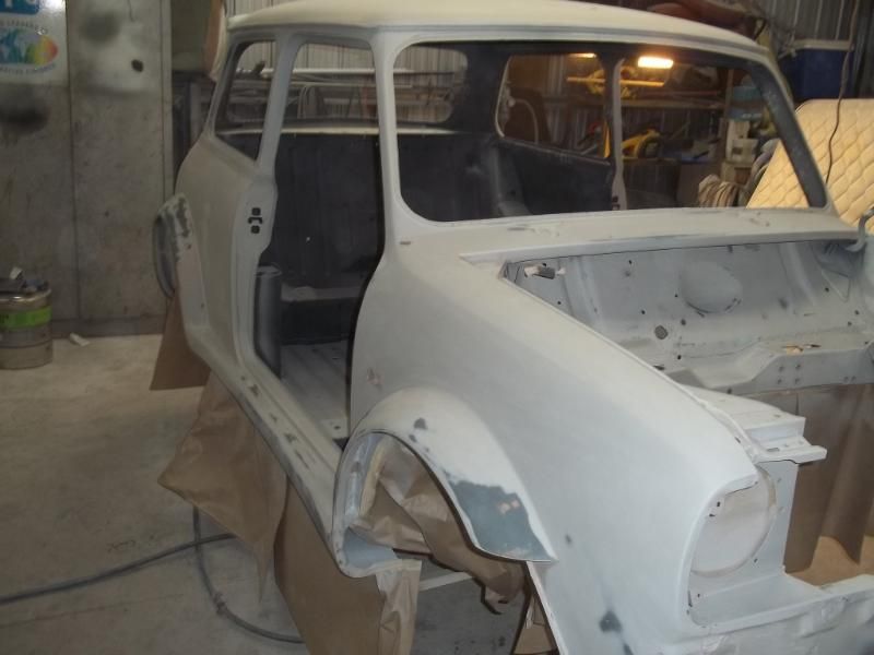

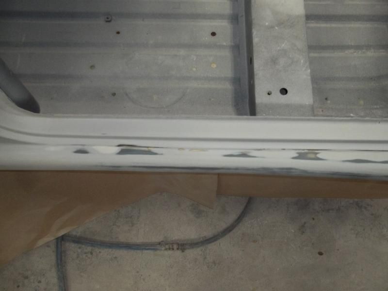

The lads sanded off the last of the epoxy yesterday:

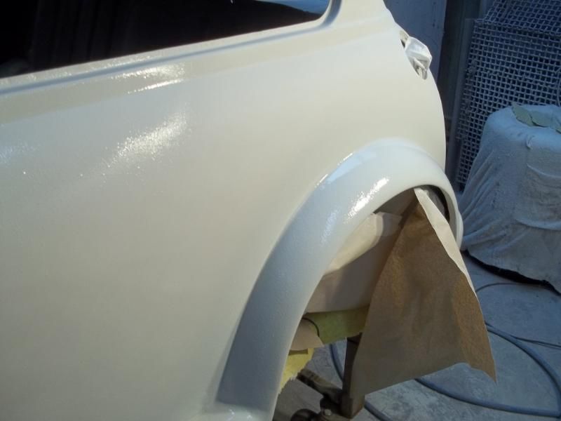

And then on went four coats hi-fill (it might seem a bit boring but these are the steps you need to go through to get the bodwork perfect):

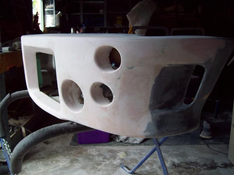

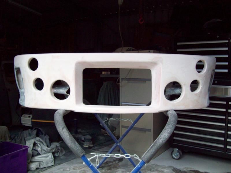

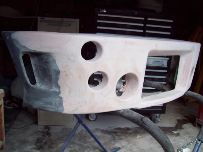

And while Ashie and Hallsey were doing the hard yards on the body, I was hard at it getting the front spoiler finished. I have now finally finished with the rough shaping and sanding and its now ready to recieve a few coats of hi-buld to get it super smooth. Then its off to the fibreglassers to get a mould made from this plug:
More later.

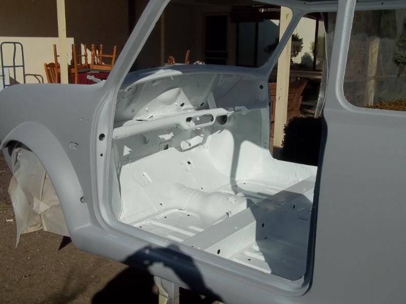

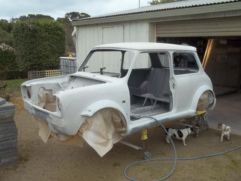

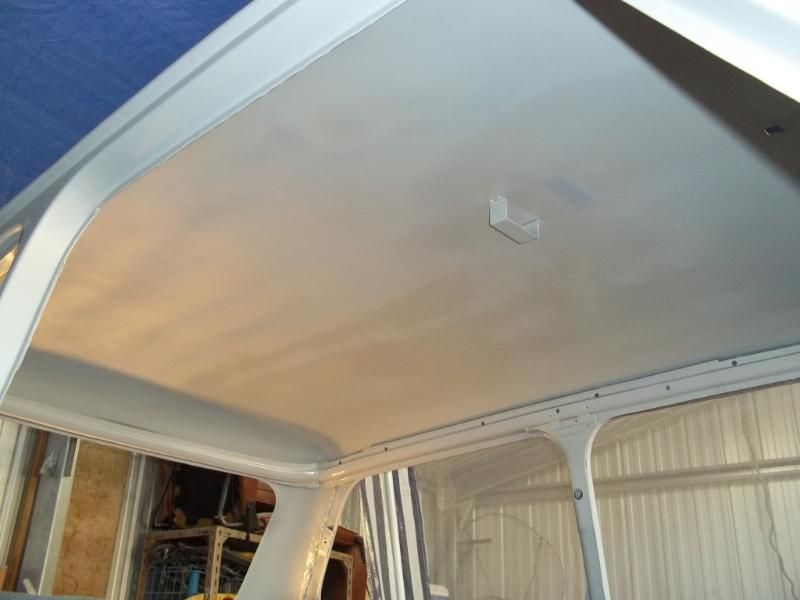

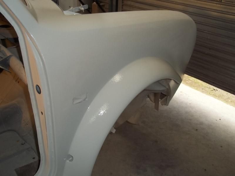

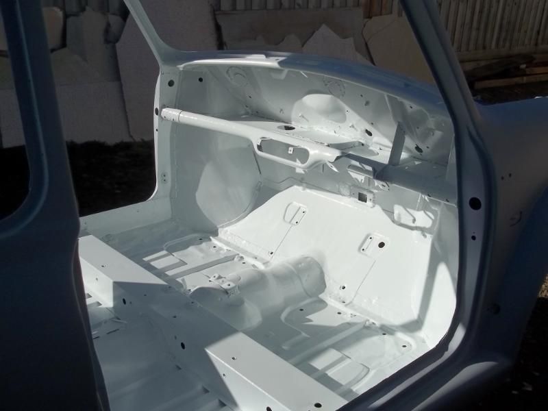

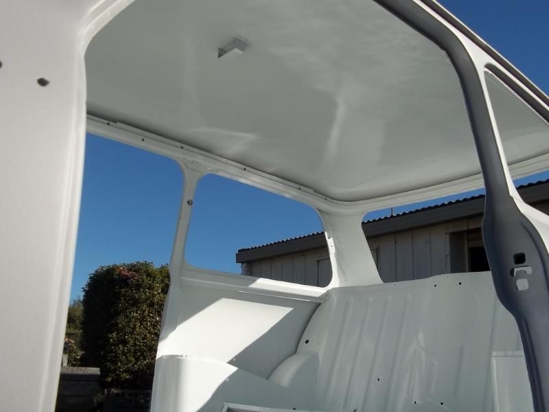

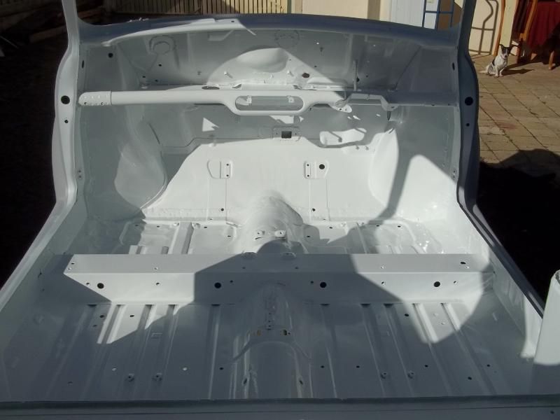

The guys laid down on Sunday some colour in the interior, and yes its white! The exterior is now flat, smooth, faired and ready to receive colour! But, thats another story. So, without further adiue, here are some action shots from last weekend:

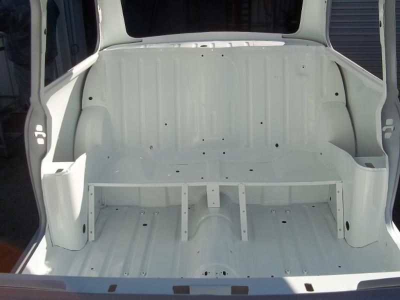

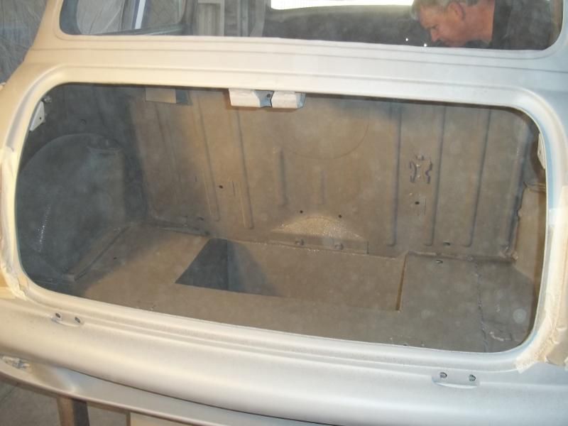

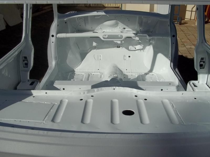

Wurth SKS applied to inside the boot, to keep road noise down and help stop drumminess and make the boot spill resistant:

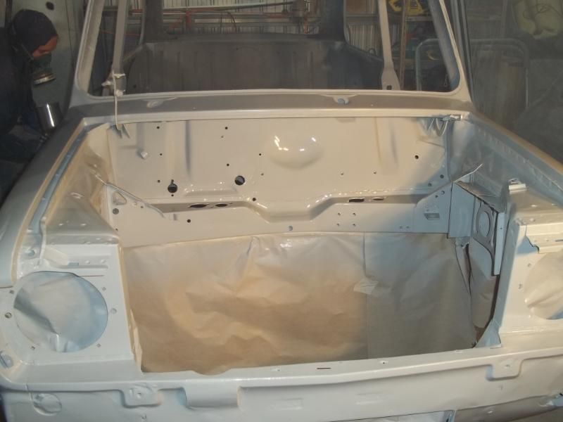

And then some hi-fill on the inside:
Bodywork now completed, and ready t take the colour coats:

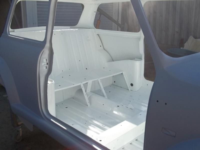

And then some colour on the interior:
