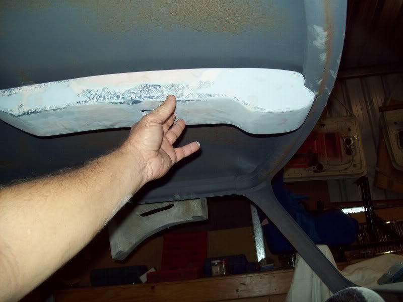

Whats the bracket welded to the inside of the roof?

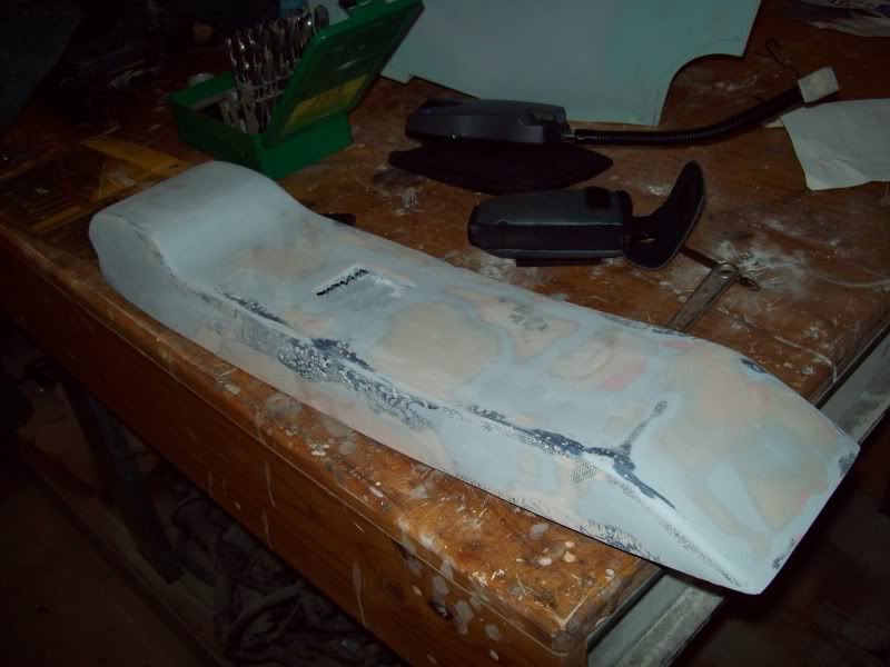

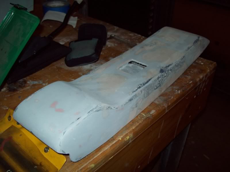

Harley, the bracket on the roof is for the roof console, which houses some idiot lights, and my arm/disarm keypad and an interior light. This is it on the bench:
And in situ:

Whats that thing weight? It looks heavy, and the support doesn't look like it has bracing.
Did you measure to see if the roof pulls in at all with the weight of all the stuff in there?
PostPosted: Wed Jul 11, 2012 6:53 pm
Hi Harley,
It weighs in at about 350 grams!!!
The bracket is plenty strong enough for the weight it has to hold up!! The construction is a spruce ply skeleton with resin impregnated cloth as the covering. Its light, very light but very strong and it can support its own weight.
There would be no deformation of the roof, its simply not heavy enough. The components weight virtually nothing as well - some LED warning lights, a timer dimming circuit for the interior light and the LED interior light itself, and the arm/disarm keypad which weighs 3/5ths of 5/8ths of SFA!
Seriously, if it all come in at 0.5kg with wiring and fixings I would be very surprised. Plus, if you take into account that the front of it will be fixed to the windscreen top bar, then the bracket only has to support half the weight!! :wink:

You'll have to forgive my ignorance and memory after 95 pages, for some reason I thought it was fibreglass and bog which would be considerably more than 300-500 grams!
:lol:
PostPosted: Wed Jul 11, 2012 8:32 pm
Nah, light as a feather!
I was going to do it out of fiberglass but when the fleece became impregnated, it was amazingly stiff.
The grey you see was one light coat of hi-fill to get it a bit smoother.
