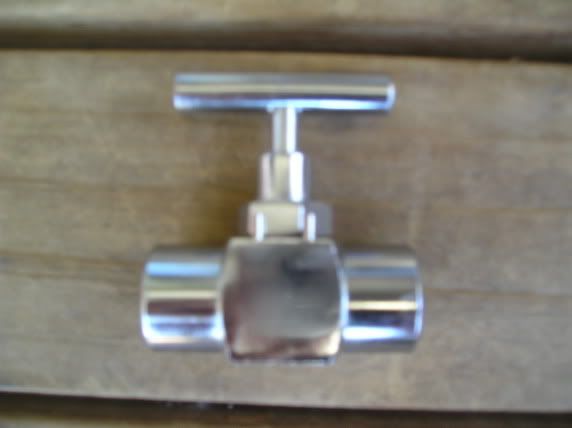

Ok guys i cant hold this in any longer... All i need is 4 batteries to power it all up... :twisted:
And the rams just straight replace the cones or hi-los
The hydraulic Rams, for the front and rear
The adapters for the rams to the rubber cones
The pumps
The dumps/switching gear and connection lines
