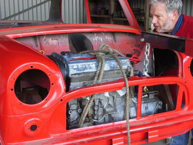

Bit of an update, engine test fit, result - not so good. I've decided to remake the front end of my frame which is half done at the moment, replacing the seperate engine mount housings with a main c section across the front, this will bolt up directly to the body, that way i dont have to worry about spacers. I will keep most of both arms and this front piece will bolt to each arm with 4 bolts each side. I hav folded up a c section and bolted it in, i have made up and pretty well know the position of the back mount, and have a good idea of the front left mount, so i think i'll tack those and test fit, while the engine is in next and roughly in position i'll work out where my last mount will go and mock it up. Here is a pic of roughly where the engine will sit when its done. Thanks to dad for helping to get the engine in.

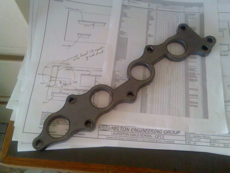

As for manifolds, intake i'm not sure, depending on what i do for the alternator, i will just use a stock one, otherwise there is a custom made left hand one i can get, which will probably be better for the turbo entry, i was thinking about putting the turbo above the gearbox with the intercooler in the side panel like boostedminis one (except the other side). As for the exhaust, I've got the flange laser cut. I might make up a simple log that runs out to the gearbox, or i might make something with a bit more spaghetti. There is only a short distance to the turbo and then if i can run a short pipe to intercooler and then back to intake, the system whould work pretty well.

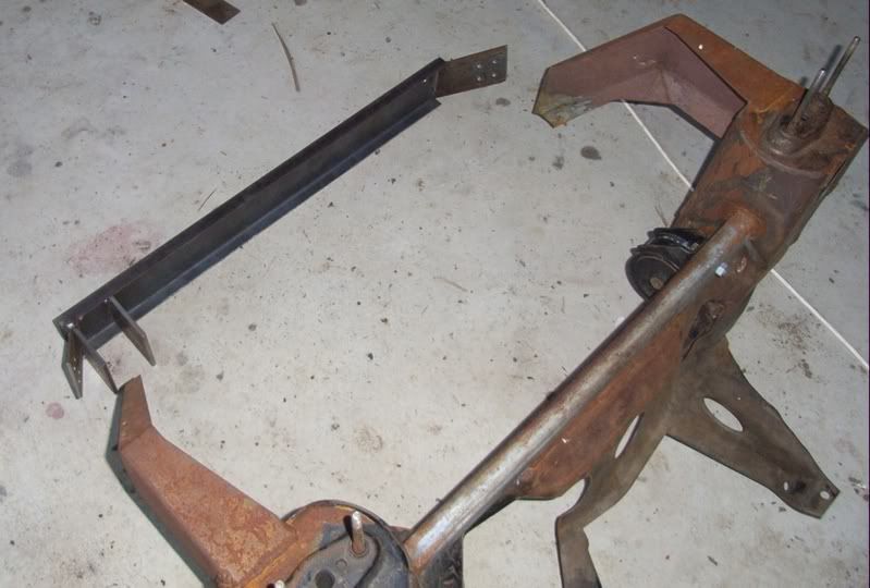

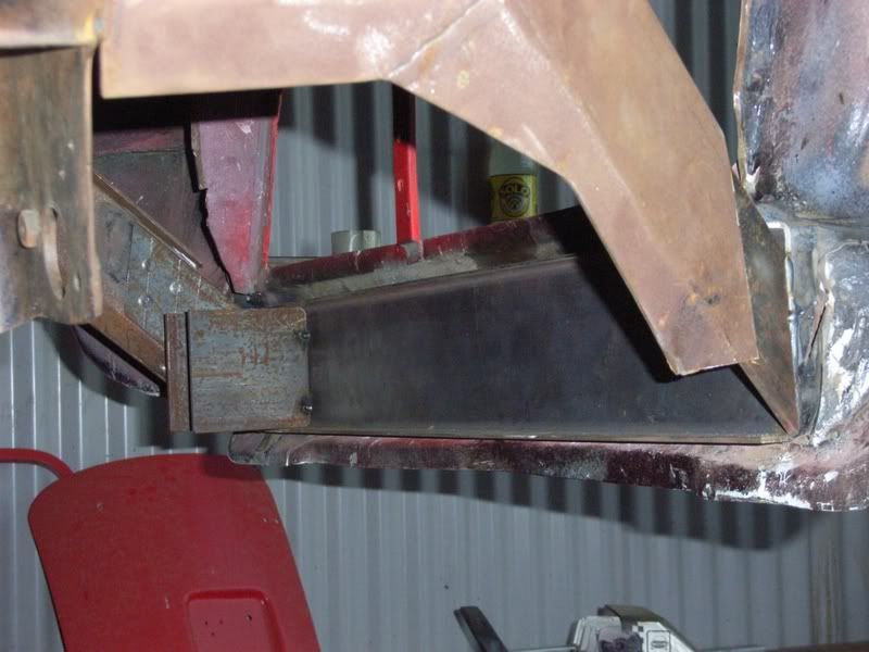

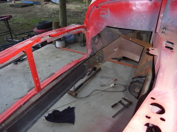

Engine mounts were a bit in the wrong place and my frame was starting to look abit makeshift. I wanted to put in a brace between the two arms and it was going to look awful. So i decided to start again (kind of). I just cut the front off my subframe. That means both engine mounts and the 2 body mounts are off and I decided to fold up a bit of 3mm steel to a bit of a C section, then mounted it up onto the body to subframe mounts at the front. I have a little lip that comes out under where the mount is (supposed to be spacers) so i couldn't make up one piece and go directly up. So i folded up this C section and made two arms on each end, these will bolt up to the existing arms of the subframe i had made up. Its all looking ok at the moment. I have bought a new engine mount for drivers side front and will test fit the engine and find out where it goes in the next week or so.
Dan: Yeah that is exactly where i was thinking about putting the turbo - did you make up a mount bracket or is it just sitting there on the manifold? Are your runners(4 pipes out of the head?) going directly out or are they 90's that have a bit of a radius and direct the exhaust gases out to the turbo side?
This is my C section - you can see on the left where it will bolt up to the side arms. the piece that is just tacked on will be the gearbox engine mount. I still need to brace the drivers side arm on the front piece, and clean up the arms on the main part of the subframe.
Just a shot of how the drivers side looks. Rear engine mount just the same as original frame.
New frame out of the car, thought i better make sure the engine fits well before i clean it up and finish it off so it looks good.

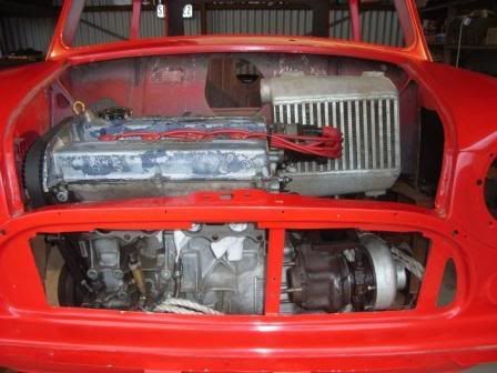

Engine is in the right spot.
Found a good spot in front of the gearbox for the turbo.
Found a good spot in behind/on top of the gearbox.

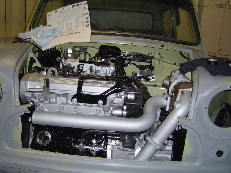

So basically the flow will go straight out of the log and one bend into the turbo, out of that and almost directly into the intercooler, i need to get a custom intercooler made or find one that has the intake on the front and one on the side. I am in the process of machining the intake manifold. I have shortened the runners about 20mm and it fits without any trouble. So i'm chuffed about that. I have tacked it up but am having trouble welding up the aluminium with the TIG. So i'll probably take it to someone. I have started machining the end as well so i can reverse the intake. This will mean the intercooler outlet will almost butt against the throttle body. So i'm pretty happy that there isn't much distance between the intercooler and the intake.
On friday i bought some 1 1/2" NB pipe and buttweld fittings so i'm waiting for that to arrive and i can get going on the turbo manifold. I have bought some 2 1/4" exhaust tube along with hi flow cat, some flex and some flanges, I still need to find a muffler. I have already laser cut a main flange from the head but will need to make up a flange for the turbo.

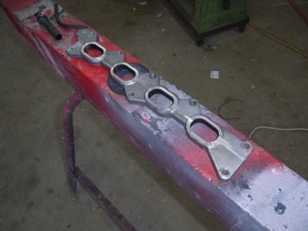

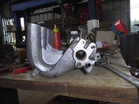

Intake Manifold :
Cut Runners to shorten length - machined so flat and level. Shortened to fit inside the firewall.
Machined flange side as well. I decided to butt up parallel but i may need to put a bit of angle in it so i can fit the throttle body.
Just tacked it up - still playing around with the TIG, the tip seems to melt whenever we try so bought a mini roll of MIG wire to try. Good spot though.

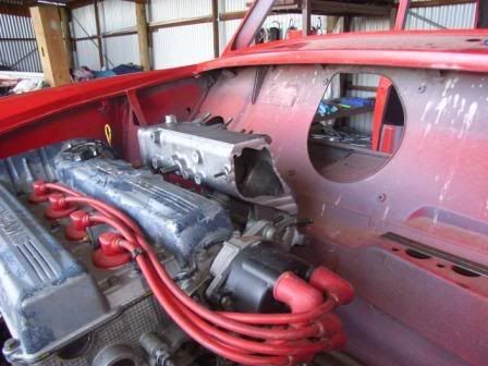

Reversing the manifold so the throttle body is on the passenger side - hopefully meaning less piping and more room for everything else.
Turbo Position :
This is what i was thinking for the turbo and the intercooler, the log would come out and do a little bend, then the dump would go back and down under the manifold.
Roughly where the turbo is going to sit. Looks like its going to fit inside the grill and away from the clutch mechanism. Hopefully keeping that semi - stock look.

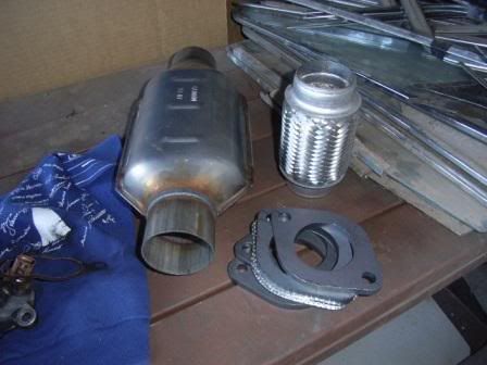

New hi-flow cat and a bit of flex, also bought 2 1/4" exhaust tube.

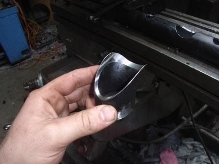

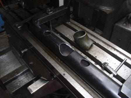

Supposed to have got more buttweld fittings during week as well but they haven't arrived yet. So i had to make do trying out with only one. Chucked it in the mill and took out a big chunk of the 90 Degree.
These are the holes i'm grinding out to match the holes from the cut down 90's.

The cat converter looks nice.. Where did you get it from if you dont mind me asking? and also $$?? is there a specific brand? how big are the inlet/outlet of your thing?
The exhaust is the next thing on my list so have to get into that.
