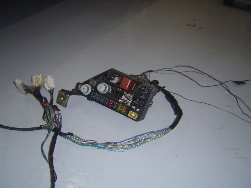

Need your winsdom again.. does anyone know what this is??? ( picture below)
The one of the left is the stock fuel filter I'm pretty sure since it seemed to connect to the fuel rail when i got the half cut. This line was chopped in half when I got it.
The one of the right.. I have no idea. Looks like some fuel tank vaopur pressure gadget since it connect to a line which comes from the back of the car. It has a vacuum type solenoid attached at the bottom and also has two very small lines going from it to the intake plenum as seen in the picture. What is this and do I need it?

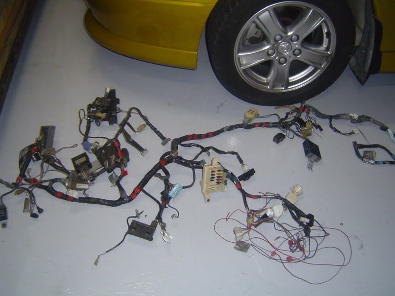

I spread out the wiring harness on the shed floor last nite.. doesnt look that bad with a diagram in hand. Looking at the internal loom, I can take out the door delay chime box, door control box and wiring??? is this correct? also there seems to be another black controller box in the A/C branch. Is this the A/c controller box? can I take this off too?
When I say take off, I mean I'm going to take off the insulation and trace back the wires to their source and nip it there. Seems like a lot of wiring to get rid of! wont be much left after this! :?
Uploaded some more pics on to picasa.. have a look if interested
http://picasaweb.google.co.uk/pubudug/
Cheers fellas!
PostPosted: Thu Jun 21, 2007 8:11 pm
Posts: 776
Location: Concord West, NSW
All correct, you can remove all of those items. The item on the right is the pollution canister. You do not need it but my engineer wanted it in, so it is in the boot with hoses coming off and going ....... :lol:
Dan

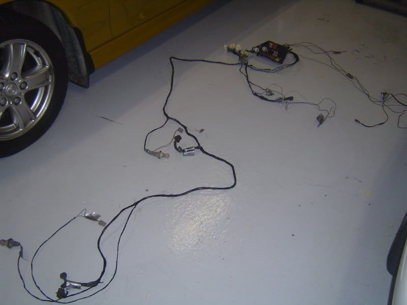

modified loom below
PostPosted: Thu Jun 21, 2007 9:49 pm
Joined: Wed May 30, 2007 4:30 pm
Posts: 158
Thanks Dan
By the looks of it you removed a crap load from the outside loom as well!
There is a seperate box containing two relays AC fan No2 & AC fan no3 Whats the deal with these? can I chop them off? :wink:
The main big relay box has already got a relay for the "fan" ( i'm assuming this is the one I want to keep) and there are two more in there called A.C MG and A.C fan!!! how come so many relays for the A/C??? can I get rid of these too???
You relay box is slightly different to mine :? but the idea should be the same I guess.
Cheers for all the help ( more needed! :lol: )
PostPosted: Thu Jun 21, 2007 10:08 pm
Posts: 776
Yes you can remove these relay's.
I pulled out only one relay from the box, i'll have to see which one- if i remeber correcty the fan relay stayed.
You relay box is slightly different to mine but the idea should be the same I guess.
Correct.
Dan
