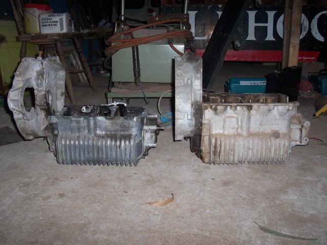

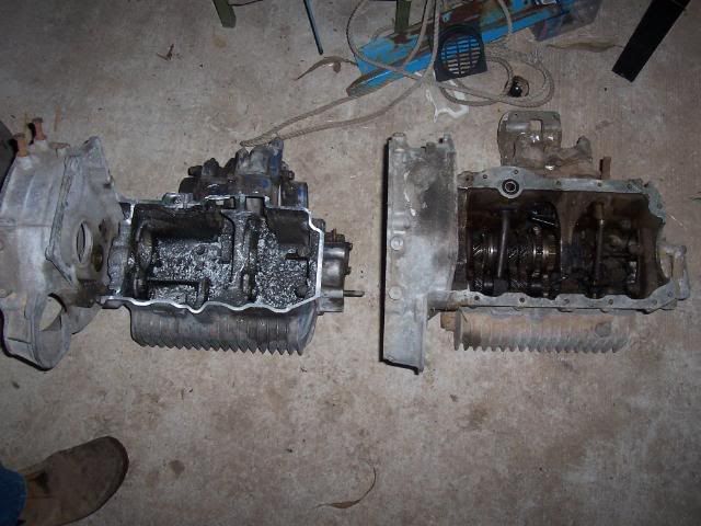

Ok I finally got off my ass and did a bit more. I took the gear box (rod change as remote will not work for this project) down to the machine guy and had the top section chopped off, a total of 49mm. As you can see from the pics the mini oil pick up is dead but the Suzuki pick up is at the opposite corner so no worries with that.
Machined rod change on the left , std remote on the right for comparison.

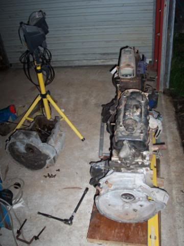

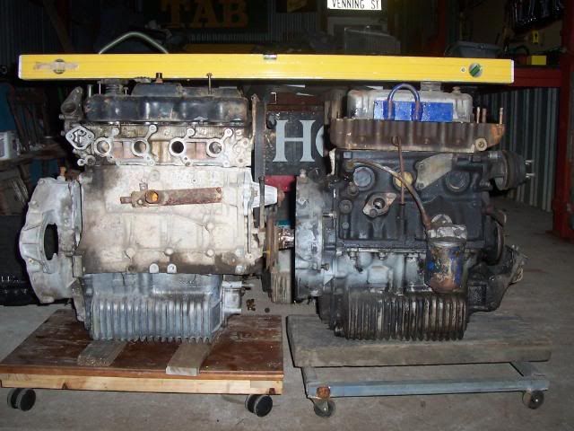

Then complete engine compared to an A series.
If anything theirs 10mm or less difference in height :D
The engine overhangs the speedo drive a fair bit but I knew that, just means I'll have to modify where the radiator sits.
