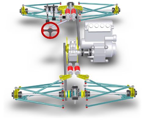

PostPosted: Wed Jul 21, 2010 11:00 pm
Posts: 2002
Why not go for something like this
Put a diff in all 3 centres, or spools if your built like a gorilla.
Not road legal but its what im planning to build as a track special.
Simplify and add lightness
