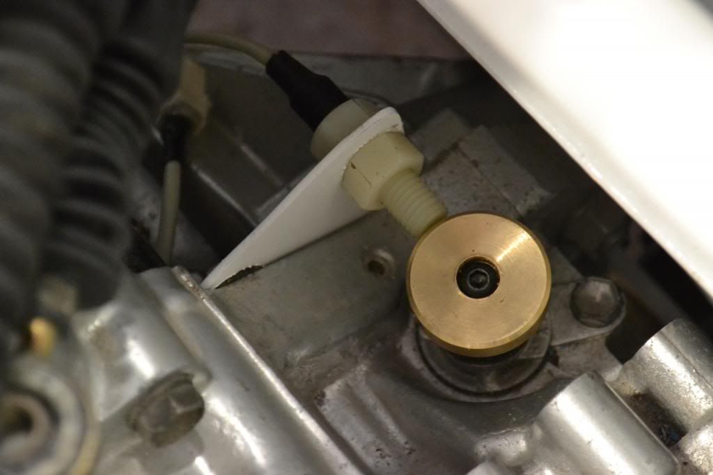

Picked up where we left off yesterday on the speedo pickup. Happy to report that the little engineering exercise we undertook yesterday was a complete success. It works perfectly.
So, continuing on where we left off, time to make a bracket for the Hall effect sensor for the speedo. It was a very simple affair, and there was a locating bolt close by that helped affix the scatter shield - perfect. So, using some 1.2mm aluminium sheet, some simple measurements, and voila, its done. Its very rigid, and will have a consistent air-gap of <1.0mm:

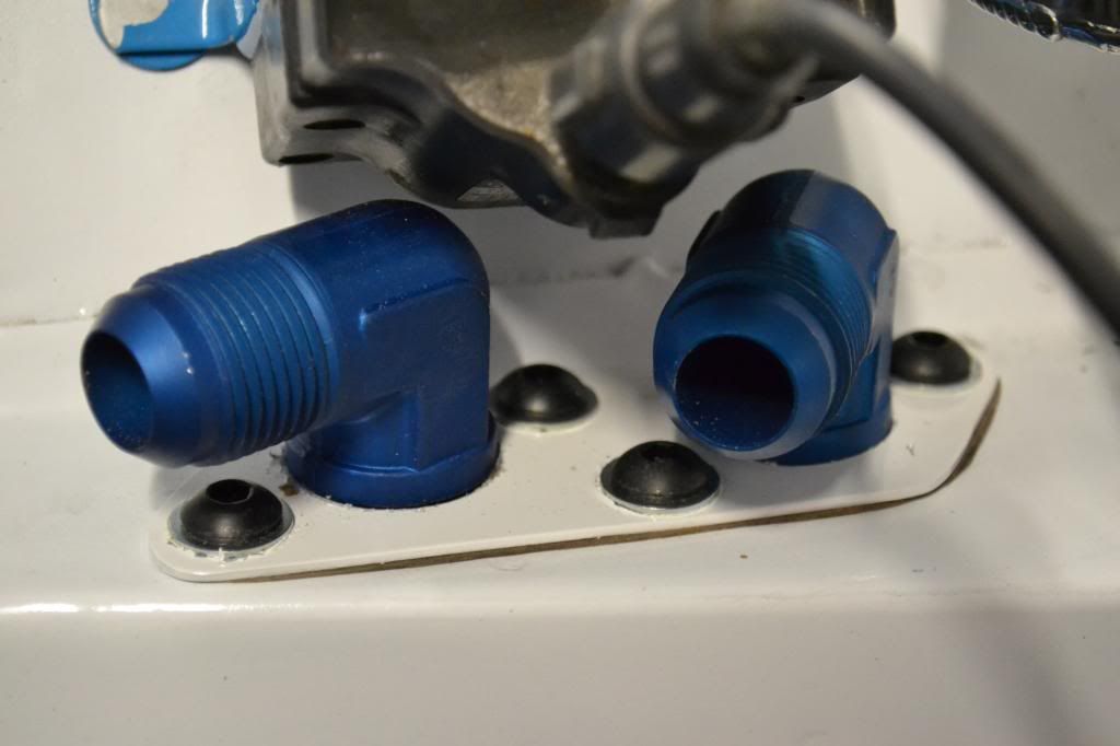

Next, was to install the heater hose through-bulkhead fittings - simple just had to paint the cover plate and install the fittinhgs:
And underneath:

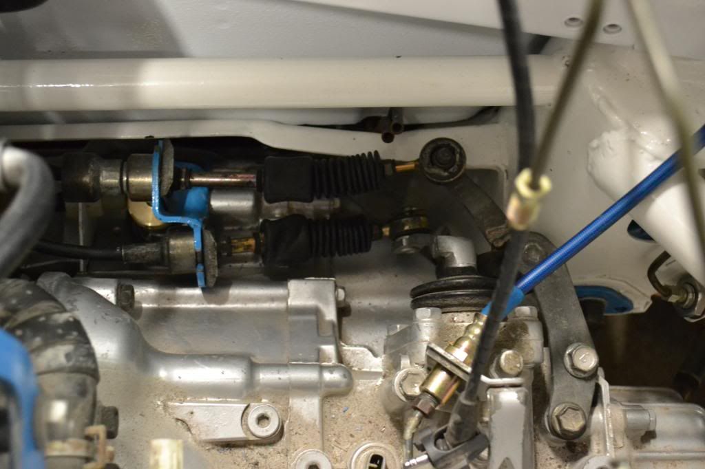

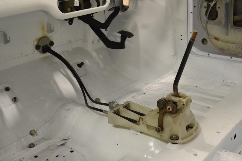

And then installed the gearshift mechanism onto the gearbox, and then the shifter and linkages in the cab and onto the mechanism:
And in the cab (it will come up again when the dynamat and carpet goes down). The brown stuff is Tectyl, a wax-based rust preventative:

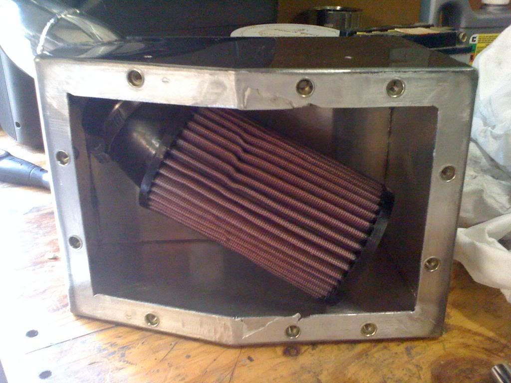

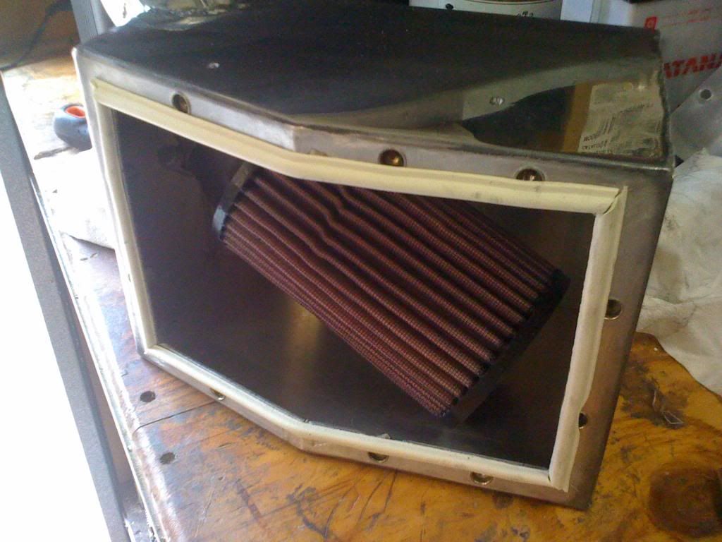

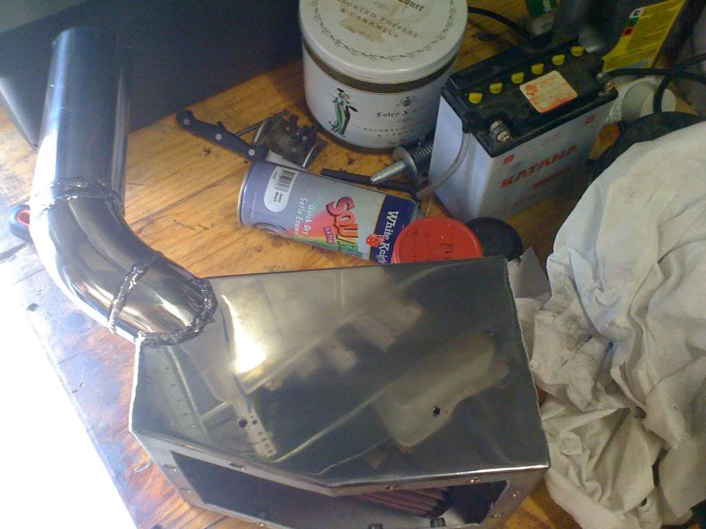

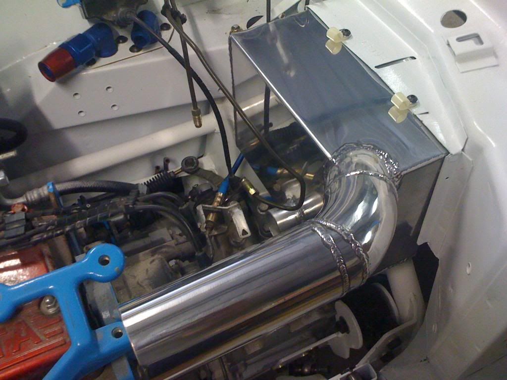

Finally finished polishing the airbox (after experimenting with sanding, polishing etc to get the best process) and I think it came out ok (I can easily see my reflection):
Installed the K&N hi-flow filter:
Then applied a rubber gasket seal to the outside face to which the cover plate attaches to:

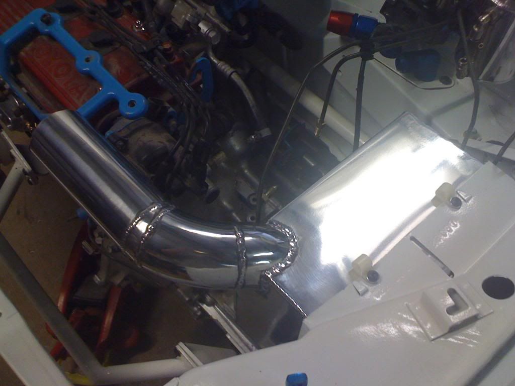

And then installed it into the engine bay - the clips that you see are to locate the 6mm overflow hose from the radiator to the overflow tank:
Before much else gets done in the engine bay, the heater hoses need to be run (waiting on some fittings from Earls), booster installed and the IM needs to come out to install the water-methanol injection nozzles

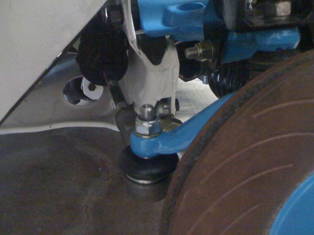

Then, did some work to the front end , after some parts arrived from the UK. Replaced the old worn out track rod ends with new long ones, installed the bump stops that went missing (I think I threw them out because they were knackered) and shortened the adjustable tie-rods so they wouldnt bottom out on adjustment:

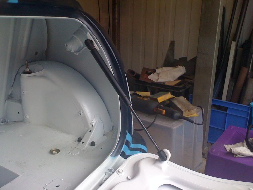

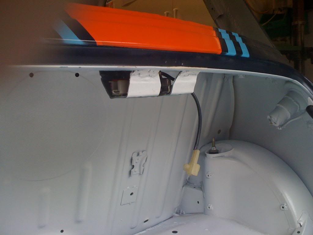

Then I turned my attention to the boot space. Installed the lock and latch mechanism (out of the old Honda Civic Shuttle) so that the boot has a push-button remote release feature:
Then installed the gas strut for the boot lid:

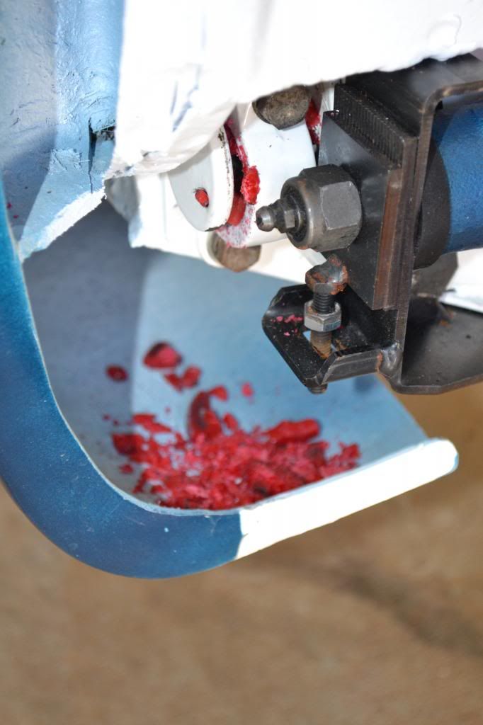

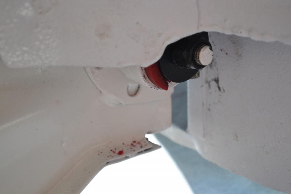

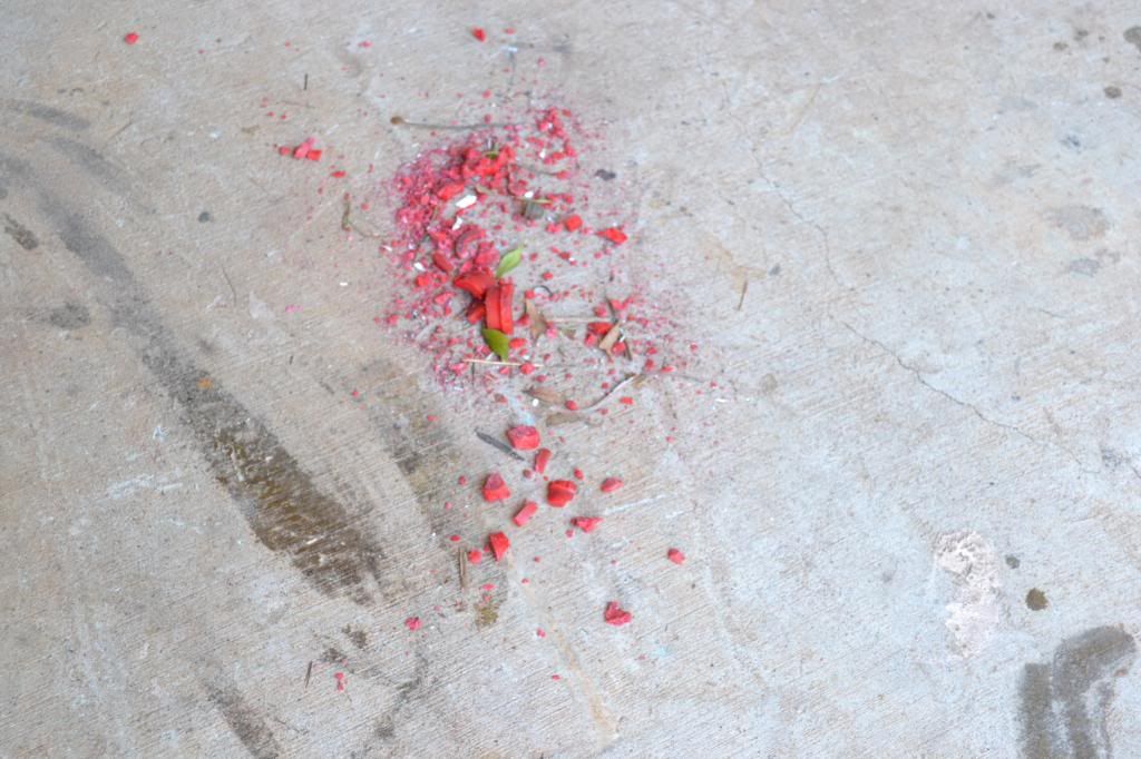

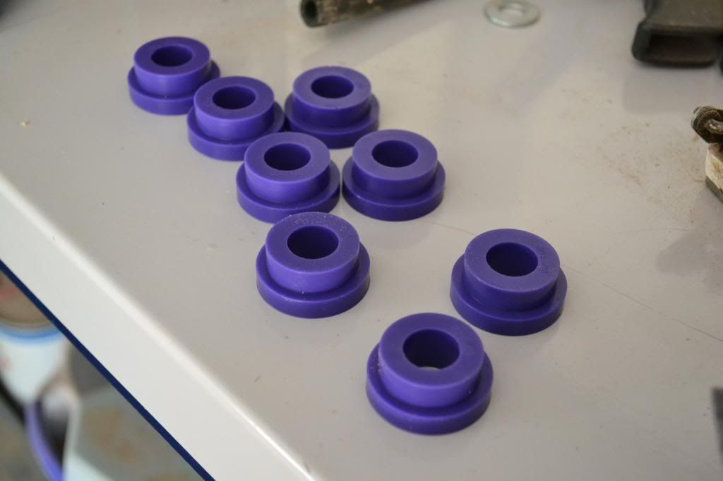

El Gato Starring in THE CASE OF THE DISAPPEARING BUSHES!!

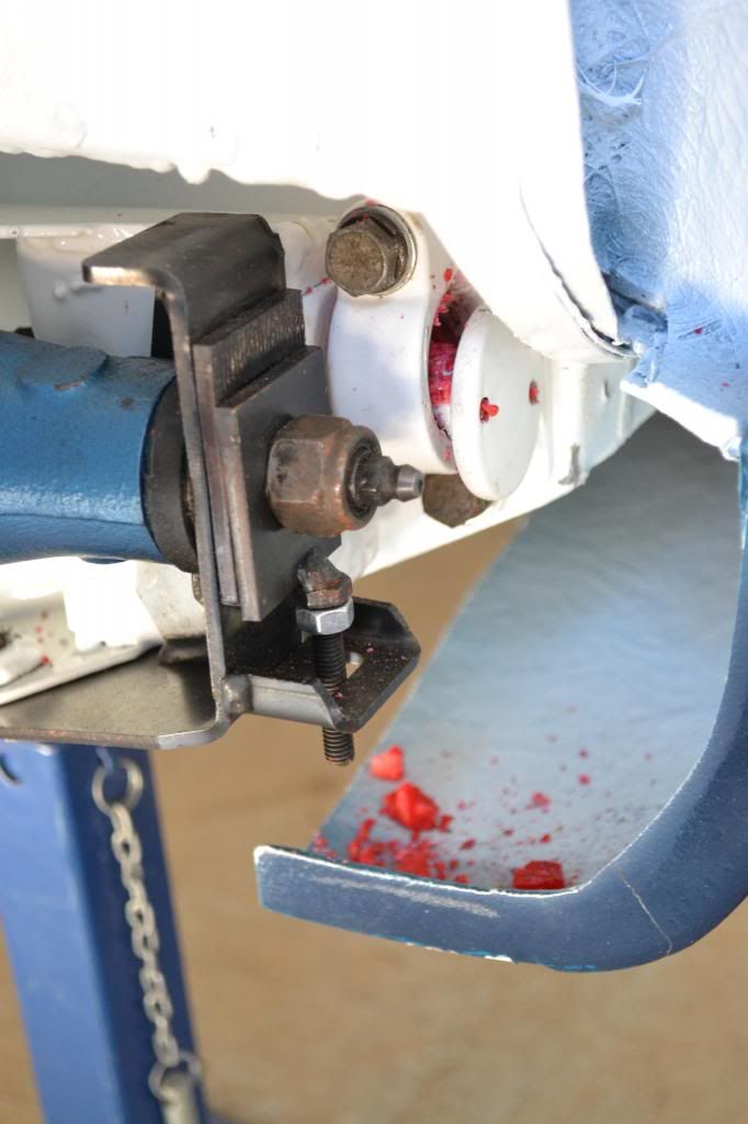

I just couldnt believe it!! There was these bits of red rubber everywhere, and when I mean everywhere, I mean everywhere!!

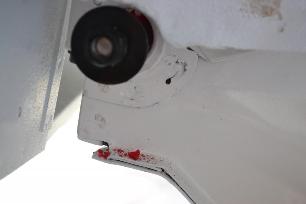

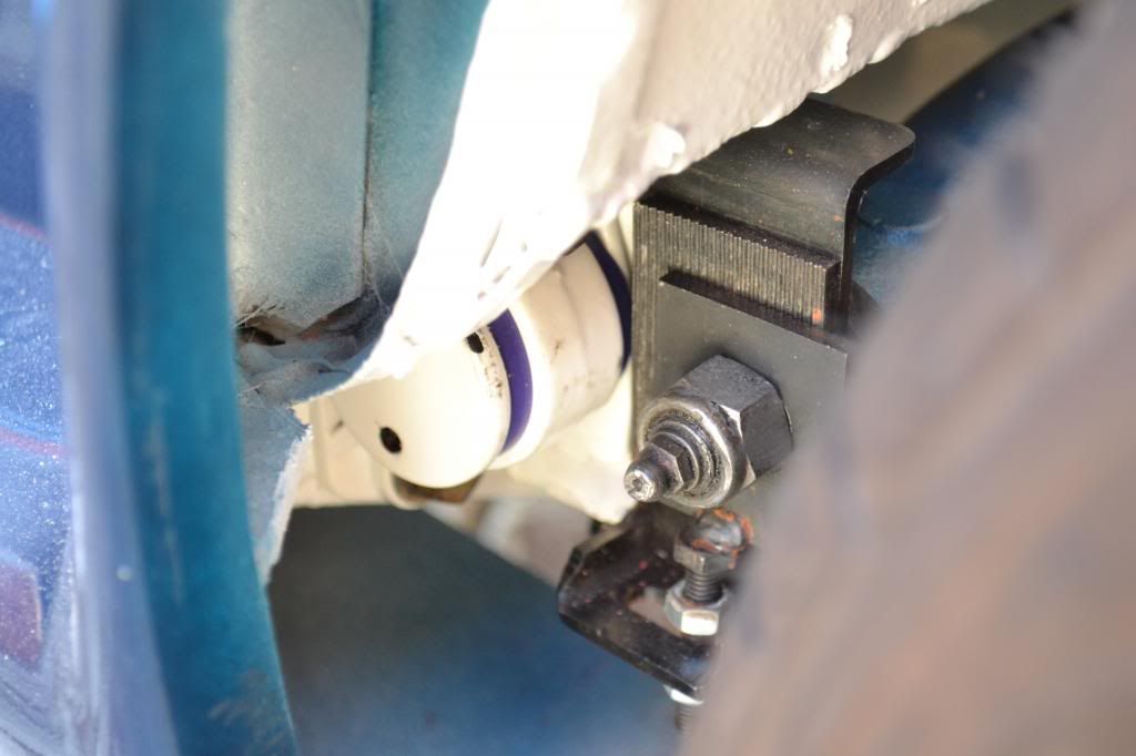

Pumping the rear of the car up and down produced a load knock, on both sides. And upon investigation I found the the rear subframe bushes had totally disintegrated. What really confused me was, they were new! They had been installed in the subframe about two years ago and never saw any road miles.
So this meant that they were ever exposed to the elements - no sun, rain, oil, fuel etc, but here they were, disappearing faster than sand through your fingers!! I ended up buying some new bushes from the UK, and installed them this weekend.
Here is a shot of the left hand rear, and the mess of red rubber inside the side skirt:
And the other corners were just s bad - wtf was going on?? It was like these bushes just disintegrated into nothing!!
And these are the replacements, and yes, colour coded of course (hope they last longer than the last ones!):
So, after a few hours of disassembly, then reassembly, the new bushes were in. Hopefully for good!
And this was all that was left of those red bastards (obviously bits of red rubber swept up before, over an extended period)!! Ok, just to get this out there, these items I sourced from Pedders. I am not sure why this happened, maybe it was a bad batch, but I would be very reluctant to order another set from Pedders again. Be warned!!

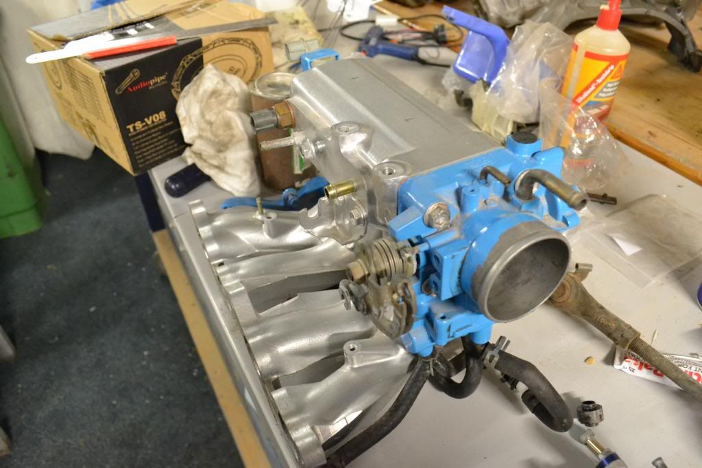

While I was in the mood, I decided to remove the IM, so I could install the water-methanol injection nozzles into the manifold, and also connect the heater hose at the back of the block. Once the IM is removed, there is a fair bit of space at the back there!!
And here is the IM on the bench, notice the marks for the nozzles. These are super fine atomising nozzles that produce an ultra fine fog of water and methanol. The Toyota IM design bunches cylinders 1and 2, and also 3 and 4 together so one nozzle will feed each of the two runners, therefore, two nozzles in total. I will also plug some of the superfluous vacuum take-offs in the IM that arent being used now that I have it out.
Thats it for now. Finally received my 1/8th NPT tap in the mail this week so I can drill and tap for the 1/8th NPT nozzles. Had to order the tap from the US, as to buy it here cost $25! Got a tap and die for the same price from the US including postage. Will do this tomorrow.
