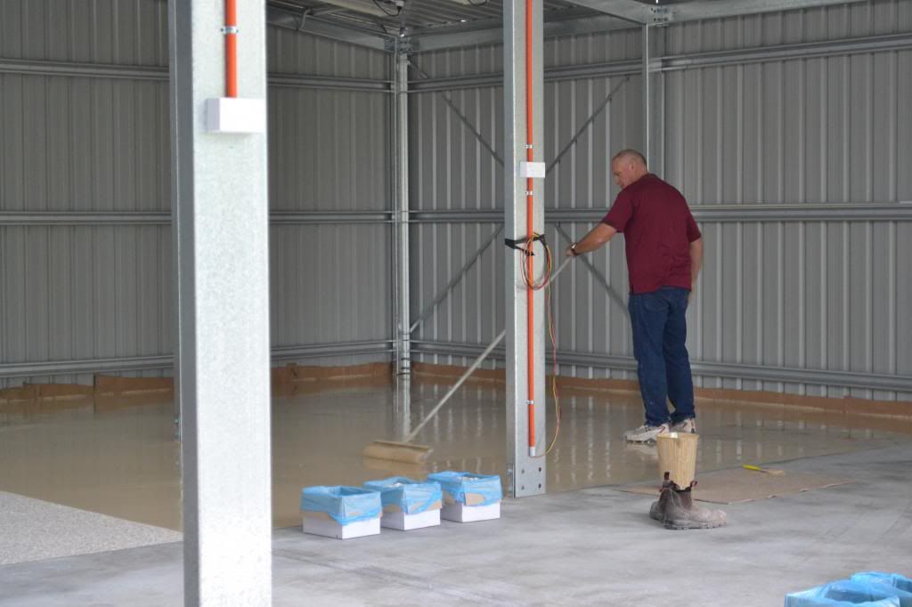

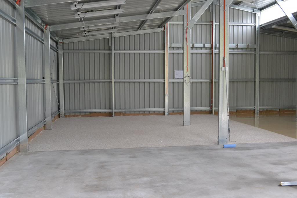

Chris (the flooring guru, from Clean and Coat) decided that it would be a good move to do the floor in sections. Firstly, the epoxy base-coat goes down. In my case, with the colours I have chosen, a beige base-coat is required. Here Chris is applying the base-coat to quadrant 2, after puttting the paint flakes on quadrant 1:
Quadrant 1 with flakes on:

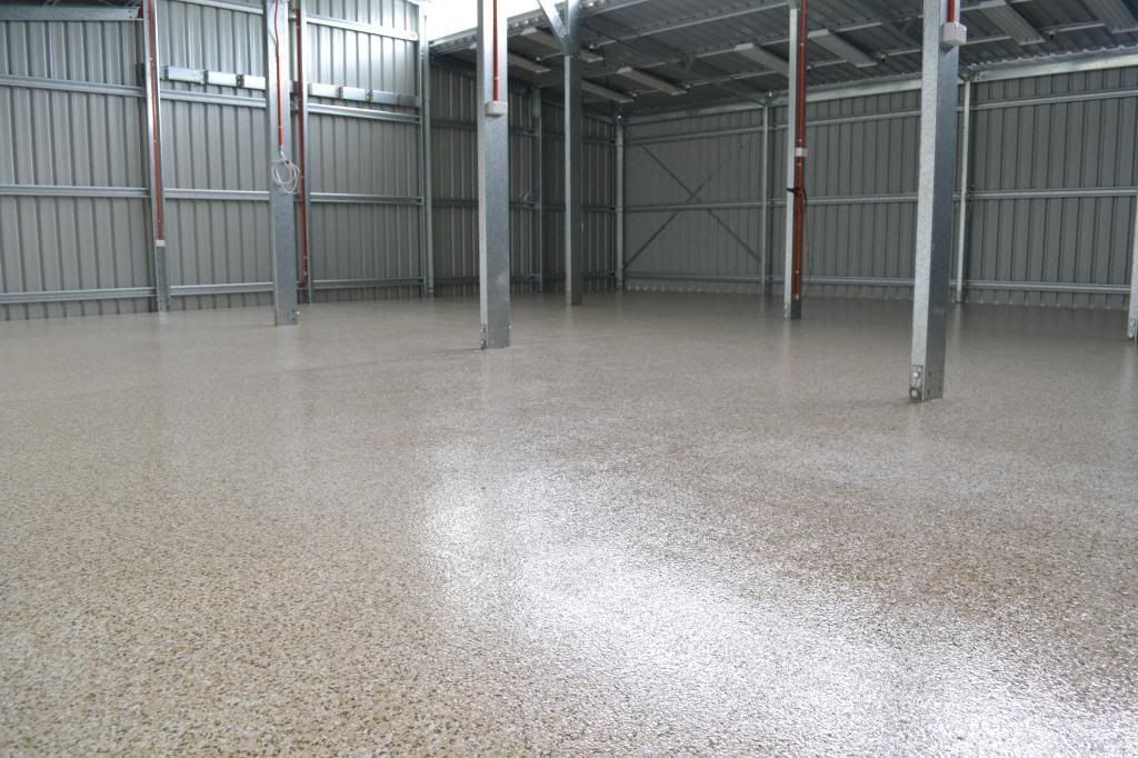

And here is the floor completed, with the two coats or polyurathane on. This is the toughest and hardest wearing urathane on the market. Because of the weather, one coat went on Friday, and one on Saturday:

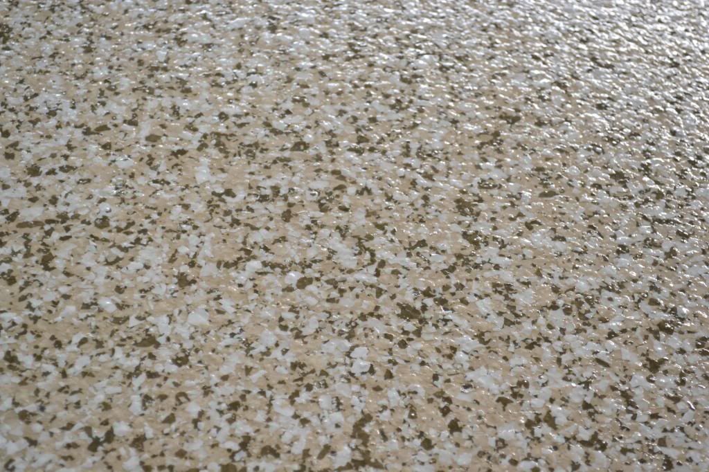

Its quite a tactile surface, and a semi-gloss finish:

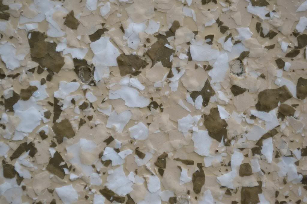

And a super close-up. Here you can see the individual paint flakes:
