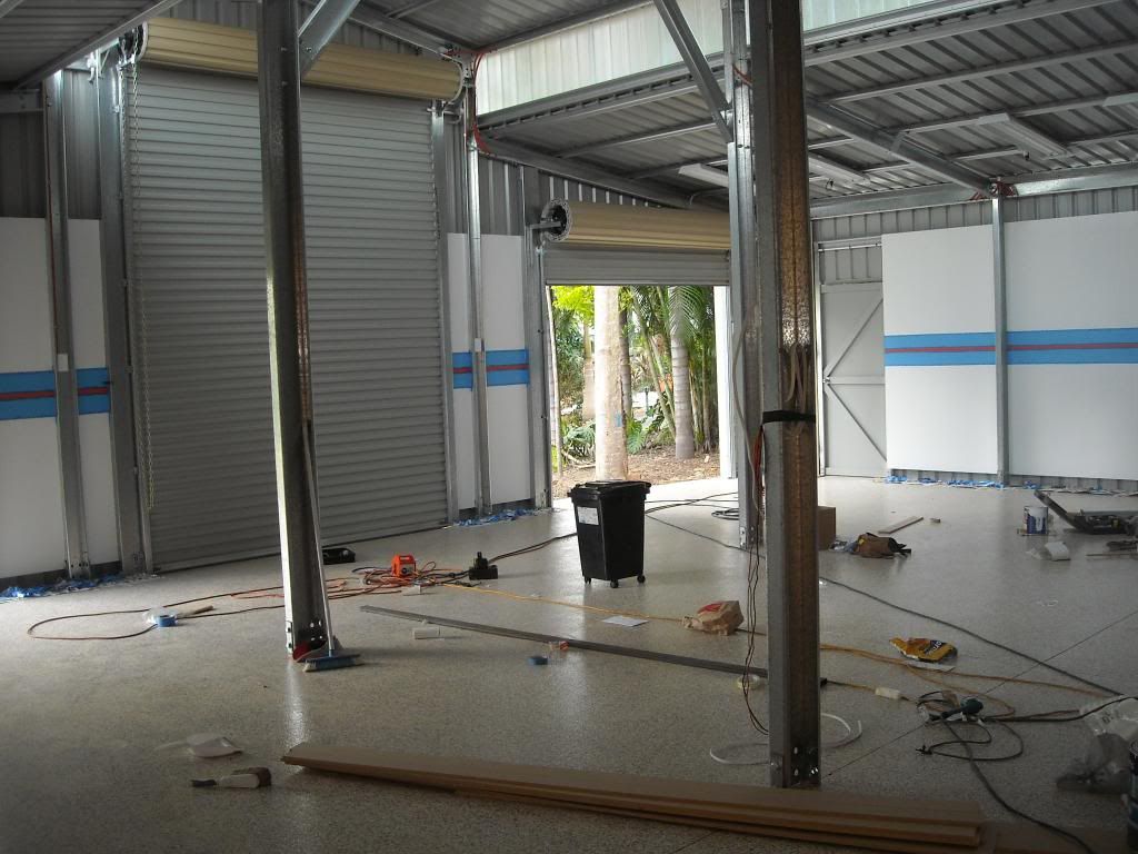

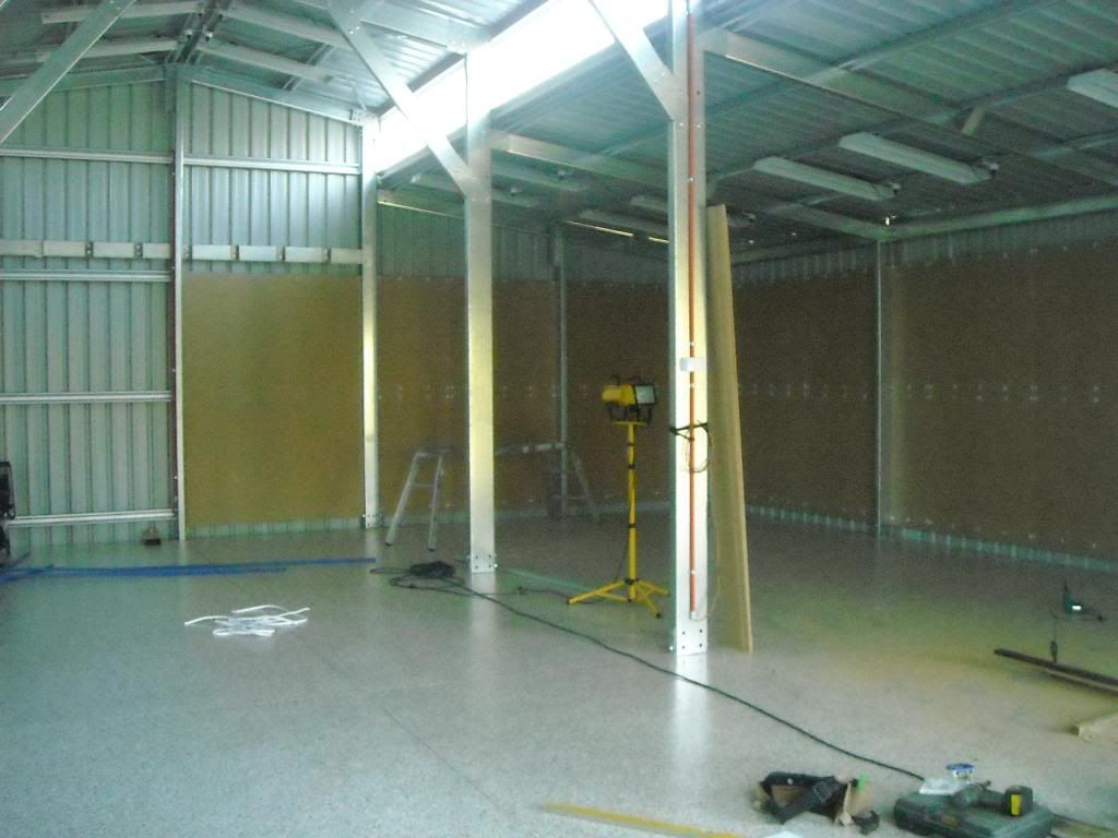

Anyway, have been doing some work on the shed while I have been waiting for stuff to arrive. The steel for the mezzanine was supposed to arrive today, but looks like it is going to be Monday now. Which is a bit of a disappointment as I really wanted it finished this weekend. Looks like a job for next week now.
I dug a trench and plumbed the overflow for the rainwater tank, seeing as it is already 3/4 full from the recent rains. Wednesday Pete (850pete) came around for a few hours to help out with the design of the spray booth. Such a wealth of information that man and he gave of it freely. Thanks a bunch Pete!!
Yesterday and today I having been hauling ass lining part of the shed with MDF sheeting. I am only lining the areas where the workbenches are going and the machinery room and paint prep room. This is for a few reasons:
1. There is nothing worse than stuff rolling off your workbench and being lost for ever down the gaps in the wall sheeting. By butting up the workbenches against a flat panel this stops that from happening
2. Gives a little bit of heat insulation on the northern and western faces
3. Gives some noise insulation as the northern and western face the road and the neighbours property respectfully.
So, grabbed 16 sheets of 2400x1200x12mm MDF and lined the walls. It was a big job for a single person but its almost finsihed now,. Ran out of sheets though and need 5 more to complete the job. I then filled all the screw holes (20 screws per sheet!!) and will sand them back tomorrow, ready for a nice coat of semi-gloss white. This should make the shed look lighter too! Maybe a racing stripe or two wouldnt look outta place...???
I deliberately left a gap on the bottom in case I ever need to hose out the shed and the gap will allow this to happen without damaging the MDF sheets.
The pics:
So, should have this all finished tomorrow and the first coat of paint on!! Once the lining is done, I can then move all the benches in, and I wanted to do that at the same time as moving the machines to limit the time I have the forklift hired. Also, once the lining is done, I can run the air lines and finish the electrical outlets on those two sides.

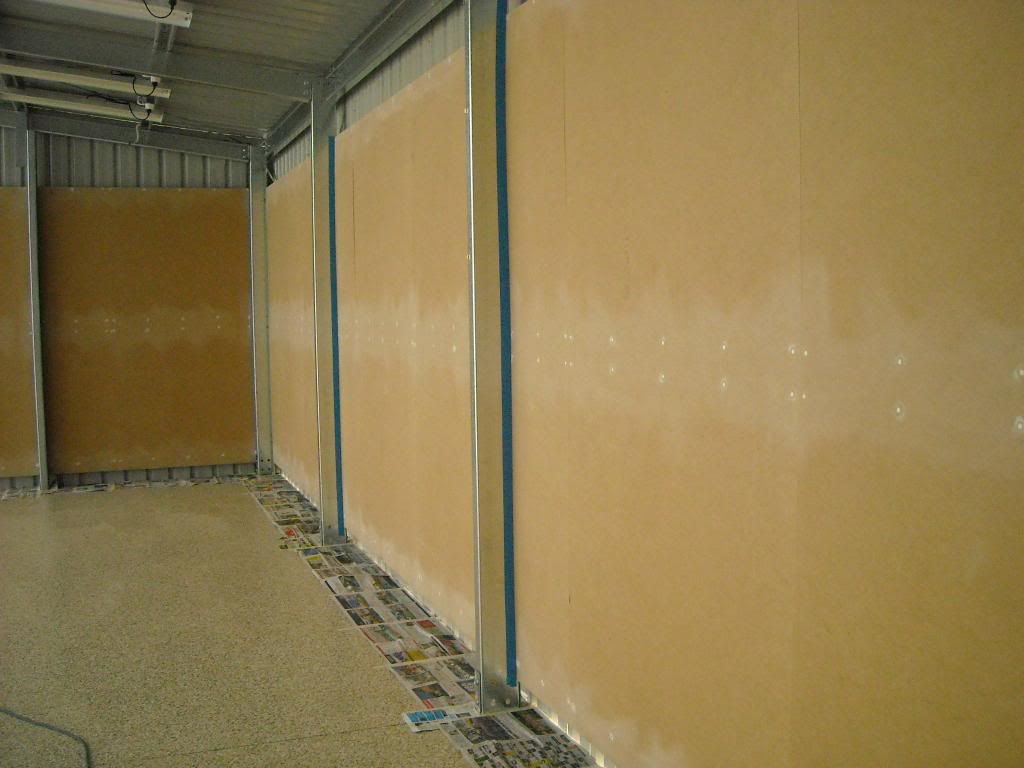

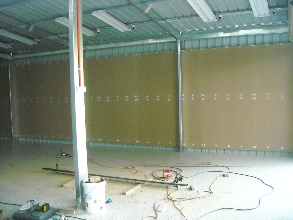

Spent Saturday and Sunday finishing off the shed lining. Grabbed five more sheets from Masters and put them up. Then filled the holes andsanded all the filler (that took a while, up the ladder, down the ladder!). Then masked off the steel and put paper down on the floor to catch any drips or spills. Its now ready for its first coat of semi-gloss white. Should have time to put that on today, then off to pick up the mezzanine steel while its drying. Not sure if I can get two coats on today. But then again, being an unemployed vagrant, there is always tomorrow.
Had a great start to the morning though, jumped on the pushbike and road with the kids to school - magic! Its the little things in life really, isnt it!!
Anyway, pics - ready for the first coat:

Did you know that orange conduit cant stand UV ? Looks like the sunlight is coming in there, dunno if its shining on the conduit, might be something to look at.

Norton - Even though the HD conduit (orange) isnt UV stable, it is not in direct sunlight. Any sunlight that comes through from the upper storey is filtered through the polycarbonate sheeting, so UVA and UVB is filtered out to the value of about 95%. Should not be a problem.

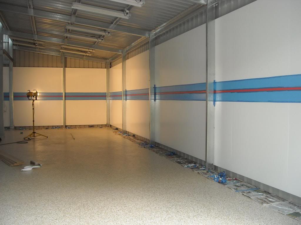

Updates - been working like an absolute beaver on the shed. Spent most of last week filling, sanding, undercoating then top-coating the MDF sheets. It took three top-coats to get any kind of opacity, in the end it looked pretty good.

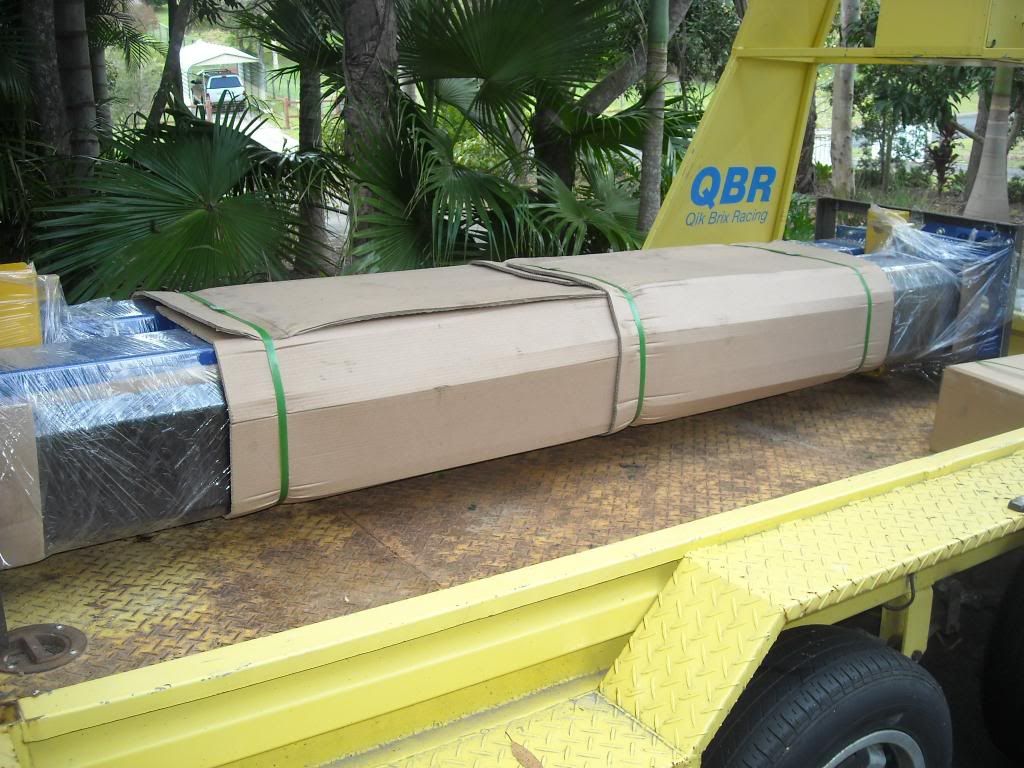

Wednesday I took a trip to Pinkenba to pick up the 4T 2-post hoist. Its still in the trailer while I finish up the painting in the shed, or it will just get in the way. Man, it weighs a bit!!

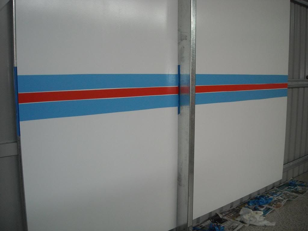

Then it was back into the painting. First it was on with the red. Rub back, mask, three coats. Then is was on with the light blue - rub back, mask, two coats. This is what it looked like Thursday afternoon.

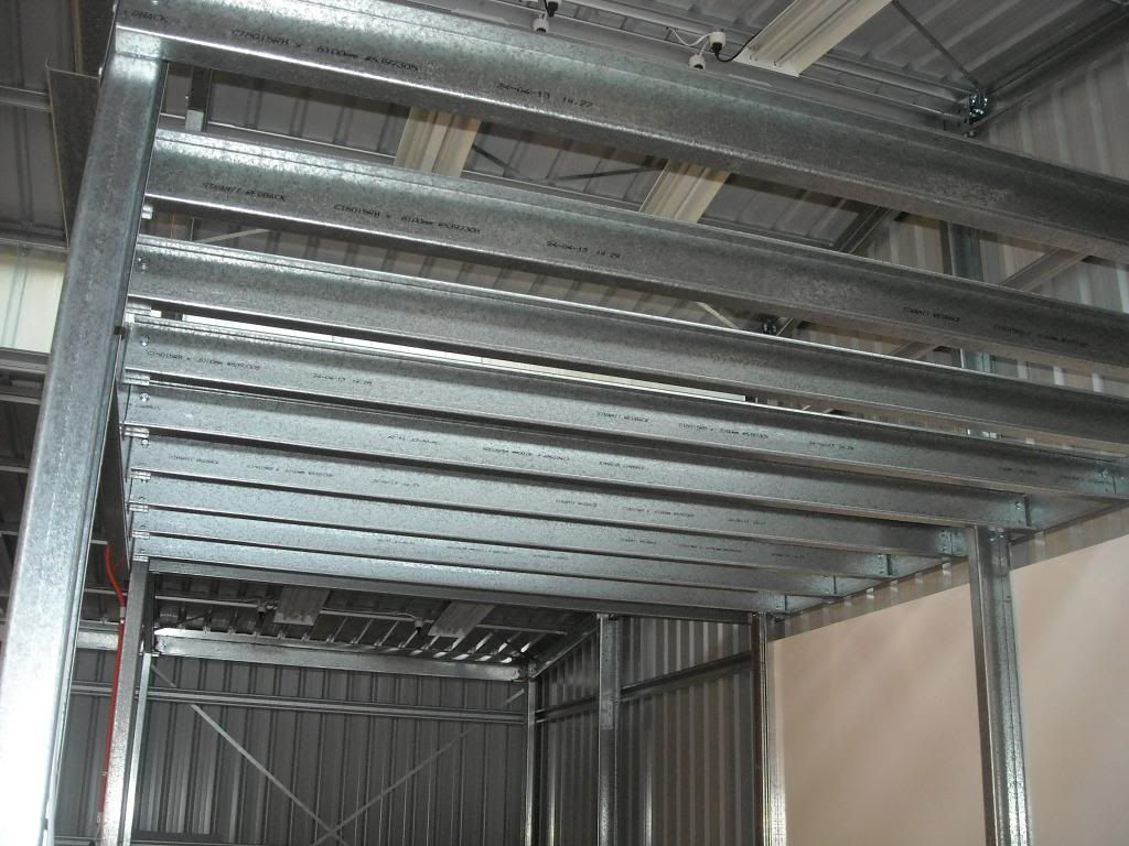

Friday the wife and I completed the bearers and floor joists to the mezzanine. Andy doesnt mind a bit of hard work, and after about 4 hours we had it knocked over. It just needs the yellow-tongue flooring to be installed now, handrails, and then its done:

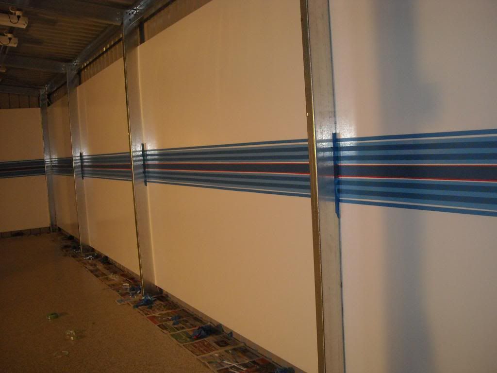

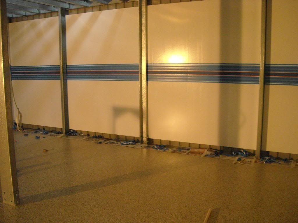

Sunday morning unmasked the stripes to see what they looked like. Had a bit of bleed-through under the tape in places but all-in-all not too bad. These lines dont have to be particularly straight and level, as the dark blue is yet to go on!!
Anyway, spent all of today, yes that's eight hours, measuring, drawing lines and masking for the dark blue - it has to be dead-on straight and level with no waves, or it will show up like dog-balls on a mouse!! It took ages:
I did a quick stocktake today of the consumables I have used to date - 4 litres of undercoat, 20 litres of top-coat white, one litre of each stripe colour, and nearly 500m of masking tape, and its not over yet. Tomorrow its on with the blue, and I hope to get both coats on tomorrow - then unmask and voila....Martini Racing stripes!!
