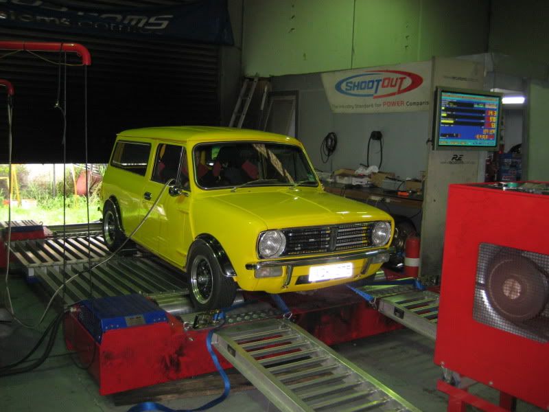

I have recently been to a couple of dyno day shoot outs. One with Ausmini at Dyson Automotive in Geelong and the other with the club that I've joined who organise track days, which was held at RE Customs in Springvale.
For the Mini Day I just pulled the mini out of the garage, filled it with fuel and put it on the rollers.
It was running 11psi boost and I got 120.3 Hp at the wheels.
[When I scan it the graph it will go here!]
Anyway I checked the tyre pressures afterwards and was only running 24&25 psi, which apparently zaps a lot of power on the rollers. :roll:

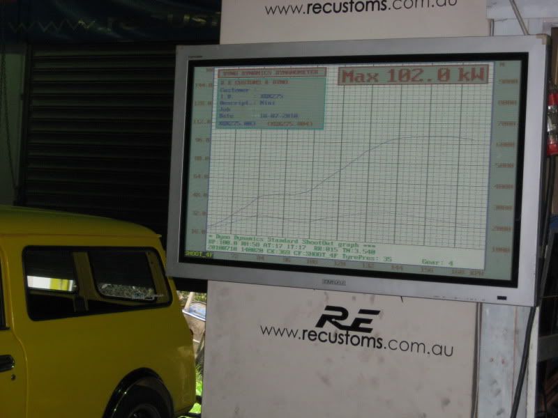

For the next dyno day I pumped the front tyres to 35psi and increased boost to 12psi (still easily within the safe range for the standard ct9 turbo (they tell me up to about 14psi is good)) and achieved a scorching 102.0 kw (136.8 hp) at the wheels.
For the 2nd day they also took the car to a bit higher revs as the graphs will show. This might have got me a smidge more killawasps.
At both dynos they said that from experience they usually see between 25 and 30% loss from an engine dyno, so taking 25% it converts to about 160 hp and 182 hp at the flywheel. :D :D
Standard power is 133hp at the flywheel.
To say I'm stoked is an understatement. For info on the mods, see previous posts. :wink:

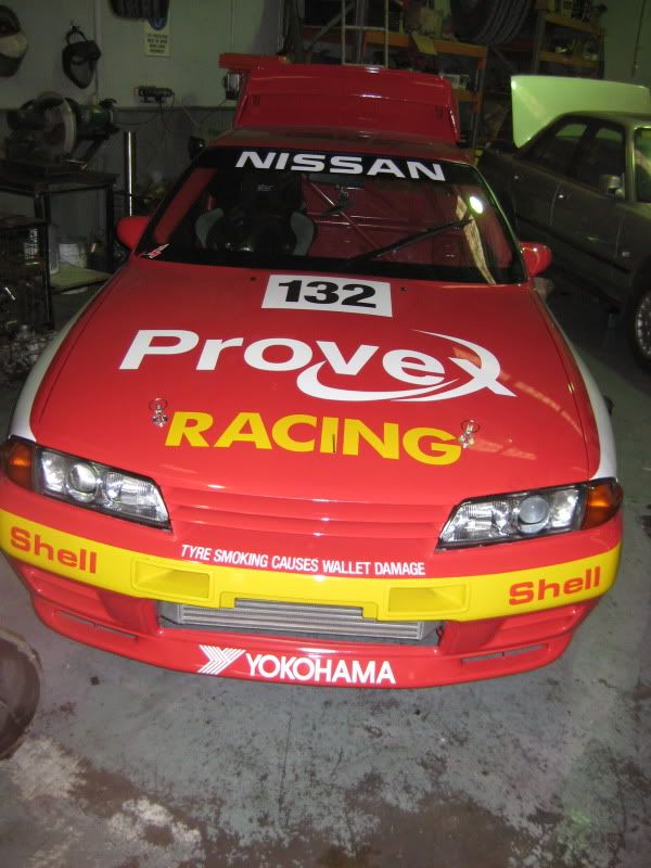

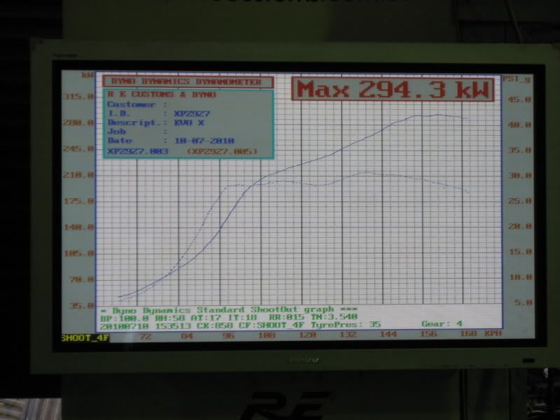

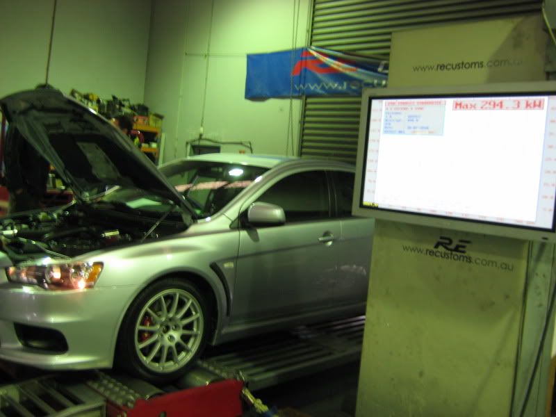

The car of the day. This subtle evo X had 294kW at 4 wheels! :shock:

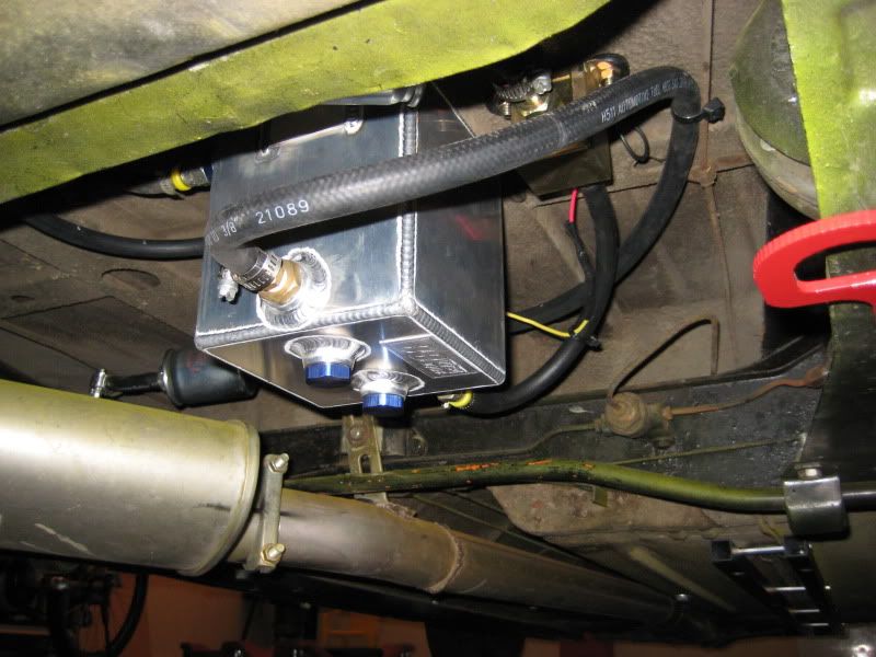

The main thing: fuel surge tank
Under the load area floor where there is heaps of room. This should allow me to corner with less than 1/2 a tank of fuel without worrying about starvation. Its just a shame the alloy tank wont look like that for too long under there!

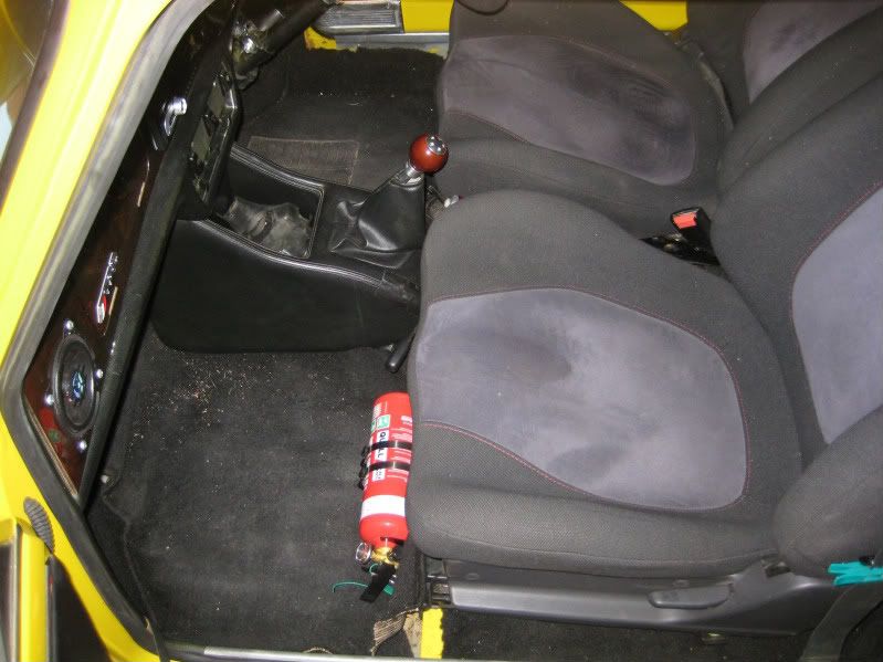

Also a bit more safety never goes a stray:

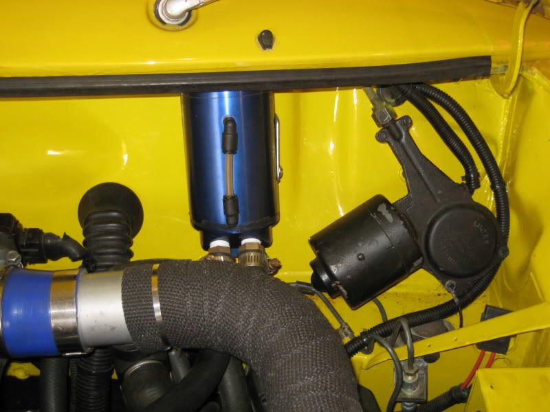

I have a extinguisher behind the driver's seat, but this is easier to get to if I ever need it on the track.
I also hooked up a LCD thermo couple to measure the inlet air temperature, as I've been running a fairly small capacity resevior for my water to air intercooler and it tends to warm up a bit when I'm driving it hard for extended periods.
Basically I wanted to quantify the temp and check to see what if any improvement is made as I make changes to the system.
[Current w2a i/c resevior ~0.6L + rad, heat exchanger, hoses etc]
The main thing I'm going to try is to increase the water capacity of the system, as I found the air temp goes from a steady 30 deg C (ish) off boost up to about 45 when I'm really giving it the berries.
It cools back down prettty quickly when I'm off boost again, so hopefully more thermal mass in the system will keep the air temperature a bit more consistent. i guess I'll find out how well it works. :D
