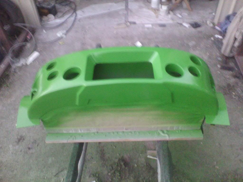

Had a phone call from the guy that is doing my front spoiler, to say that the mould is finished, and ready to take a part from. This is great news, as I had finished my work for him (getting power onto his shed) at Xmas 2012 - yes, 8 months ago!!
Anyway, he assures me that the first part will be ready for fitting up and painting by the 20th August - fingers crossed!!
Anyway, some teaser pics of the finished mould. The tooling gel coat is an interesting colour. They will be made available to the public soon. Apologies for the quality of the pics, they were from his phone.

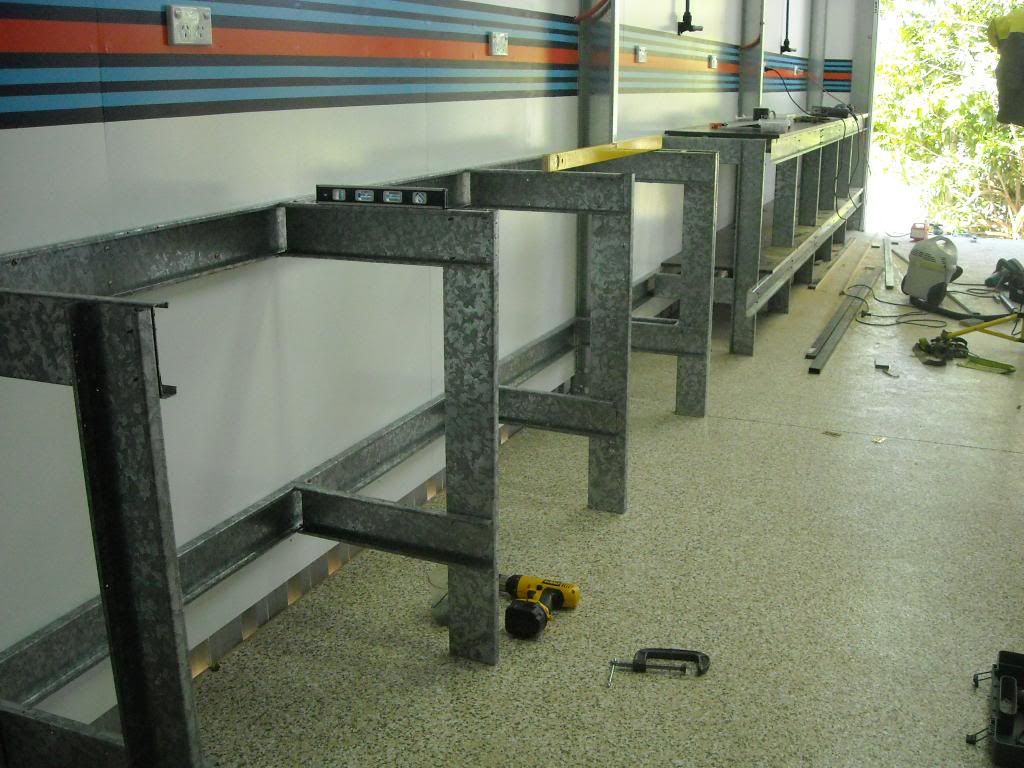

It has take me two weeks to do the benches, to a point where I can use them. This is because I decided to recycle the old benches from the top shed, as they were very sturdy. The problem was though, that the benches in the top shed were custom built for that shed in those spaces, so had to disassemble the benches, transport them down to the bottom shed, modify them to suit the new spaces, and then reassemble.
It started by deciding on how much bench space and where. I wasnt going to make the same mistake as I made in the old shed by putting benches everywhere, only to have limited floor space and have bench tops piled with shite (you know what its like, the more bench space you have the more shite you have on them). So, the benches were only going to be down one wall in the reassembly bay. I also learnt another lesson from the previous attempt, the bottom rails were too low to allow the engine crane legs to get underneath - this made it very hard to get an engine up onto the bench. So, raised the bottom rail by 50mm and all is well.
Started with cutting the steel to size for the new space, and screwing it together:

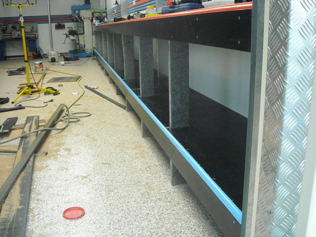

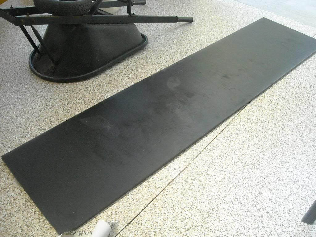

Then, once the frame was all together, it was time to put on the bench tops. I am using film-faced ply. It is 17mm thick, and comes with a nice black veneer that is easy to keep clean. No, this is not form ply!

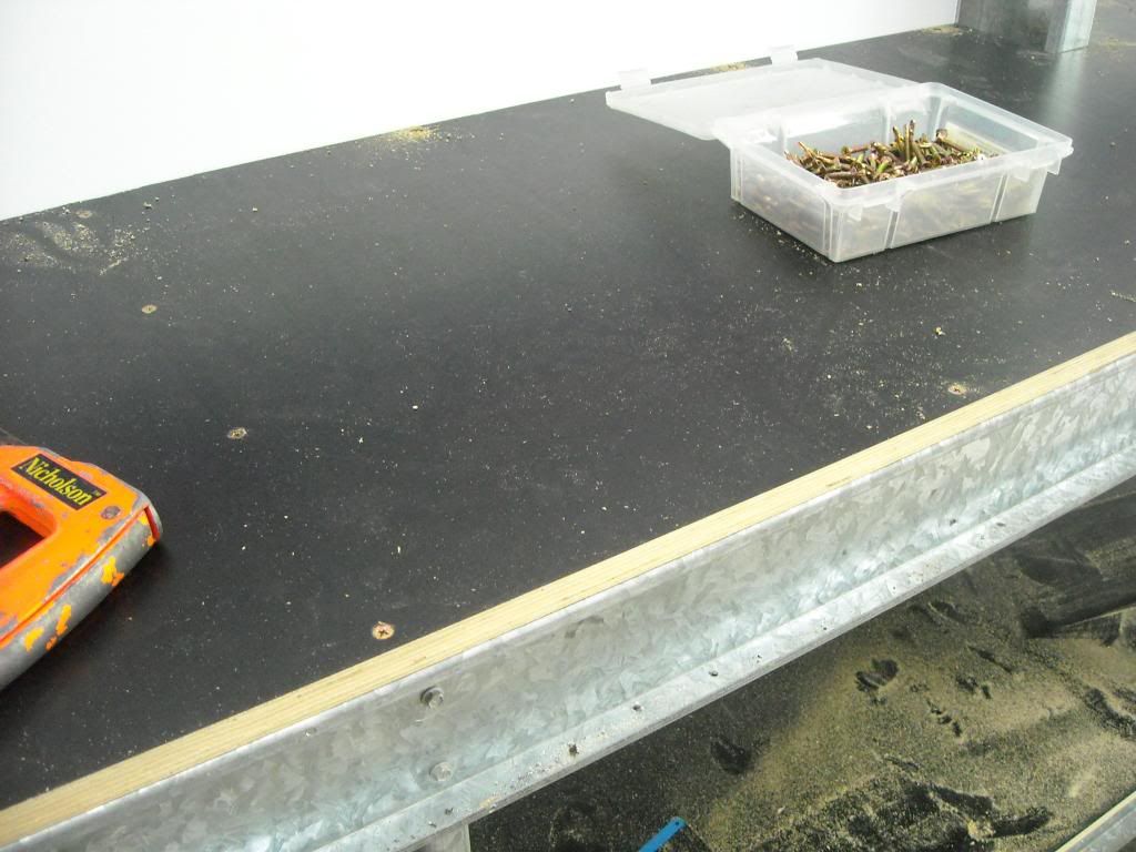

Wing-tip, self-drilling, countersinking screws are used and finished flush with the surface:

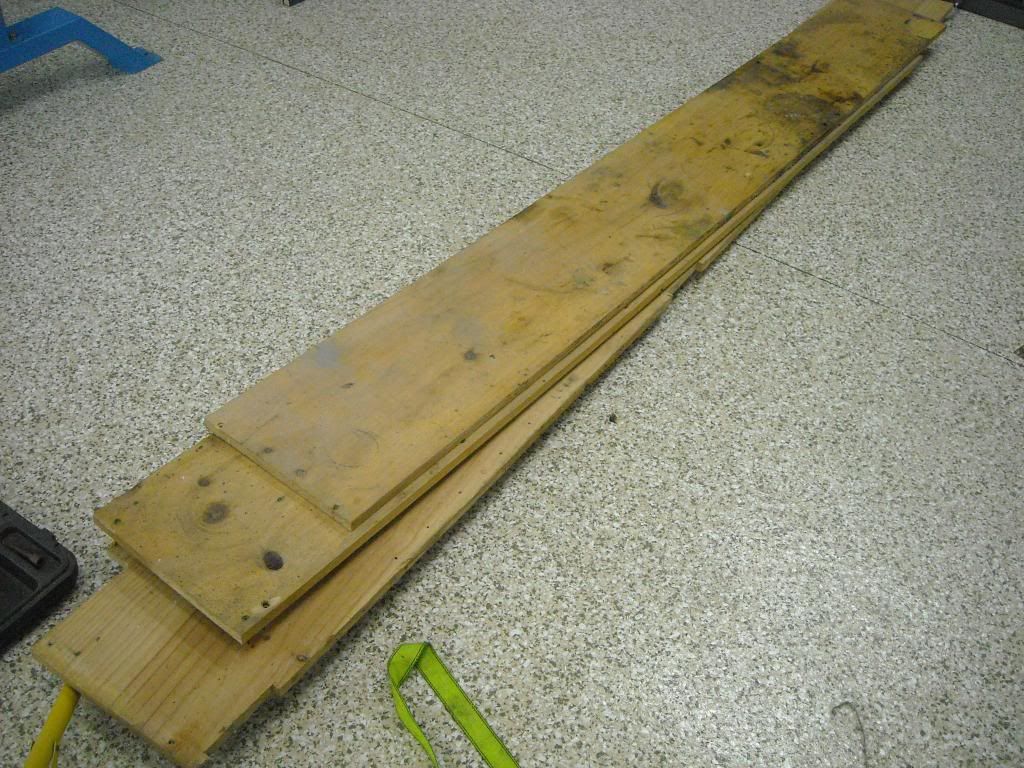

This is the old tops from the old shed - 20mm pine. It was not a good choice. I bought it originally straight from the mill, slightly green, After a while it shrunk back and left gaps between the slabs, not to mention knots and other irregularities. Also, some of the slabs bowed and split and the surface was uneven - I had to go back and screw in timber under the joins to help level the surface - crap choice really. The ply is much better:
This is what was left of the benches I pulled apart - a good bit of recycling:

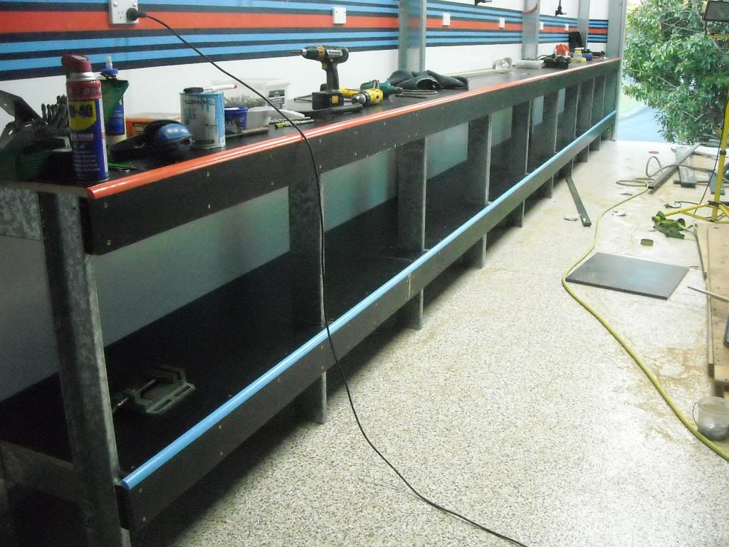

Work in progres with both top and bottom benchtops on. The bottoms were a bit difficult as they had to be fed through the legs of the frame to be put into place. I needed to ensure that the cut-outs for the legs etc were bang on. The ply itself had to be trimmed about 50mm, so not a lot of wastage was involved, which I am pleased with.
And the finished benches sans the doors (or whatever I am going to use). The infill pieces between the front face (which is also film-faced ply) and the tops is 17mm quad, glued in place and then masked and painted, to match the Martini Racing stripes on the walls. I am kinda pumped how they turned out, and they are a good height to work from, and the film-faced ply just wipes clean:
Hope you like them. Just got to sort out what I am going to do with regards to doors now...

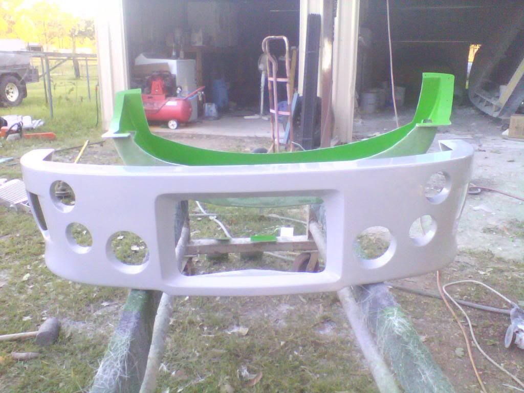

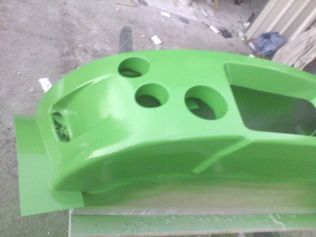

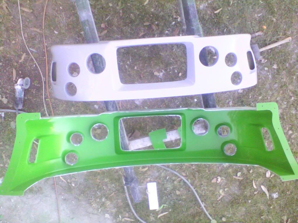

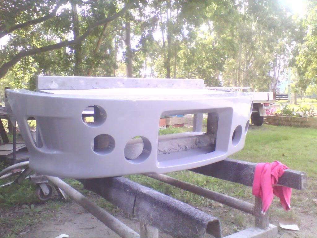

Anyway, quick udate with regards to the front spoiler - its FINISHED!!!!
Yep, Royce rang me today and sent through the pics. After nearly 9 months, both the mould and the part are now done. It arrives tomorrow for a test fit. I havent seen it in a very long time so I hope it fits with minimal trimming. Not to rubbish Royce, he has had a very rough trot over the past 6 months, and his work is absolutely top-class - well worth the wait I am sure.
Without further adue, here are the pics...
Will do a quick test-fit tomorrow, when it arrives. Yee-Haa!!
