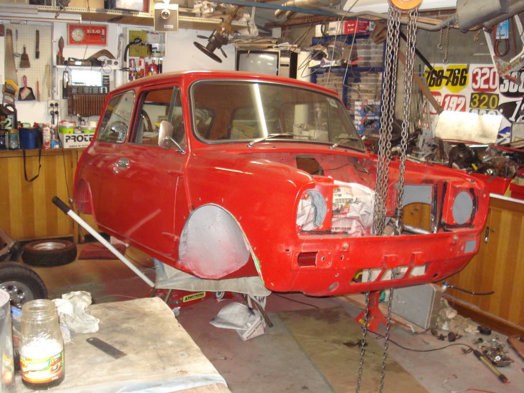

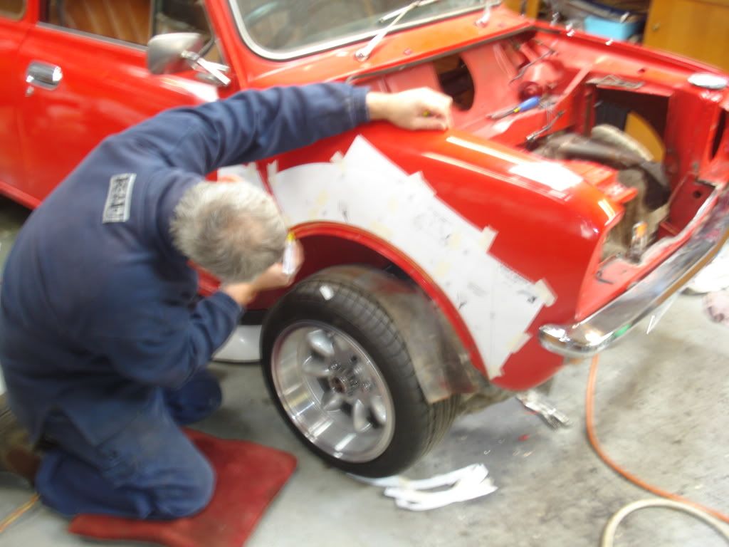

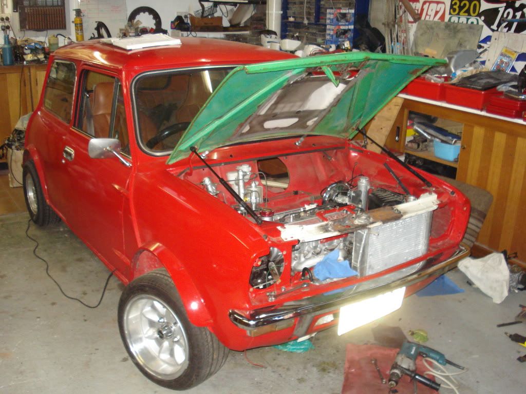

Heres the car with pretty much everything test fitted

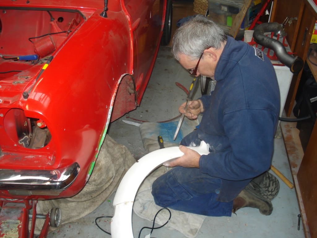

Heres my panel beater mate Ashy fitting the templates
cutting the gaurds putting a lip on the gaurds
A little bit of tweeking to fit

PostPosted: Sun Aug 22, 2010 8:50 pm
Looks good. What length and Nm are the bonnet struts?
PostPosted: Sun Aug 22, 2010 8:57 pm
Posts: 404
Hi Kennomini
They are actually my old tail gate struts off our old VN
commodore wagon,They would'nt hold the rear door up
on the VN but they work a treat on the mini.
If you need the length give us a yell
cheers Hallsey

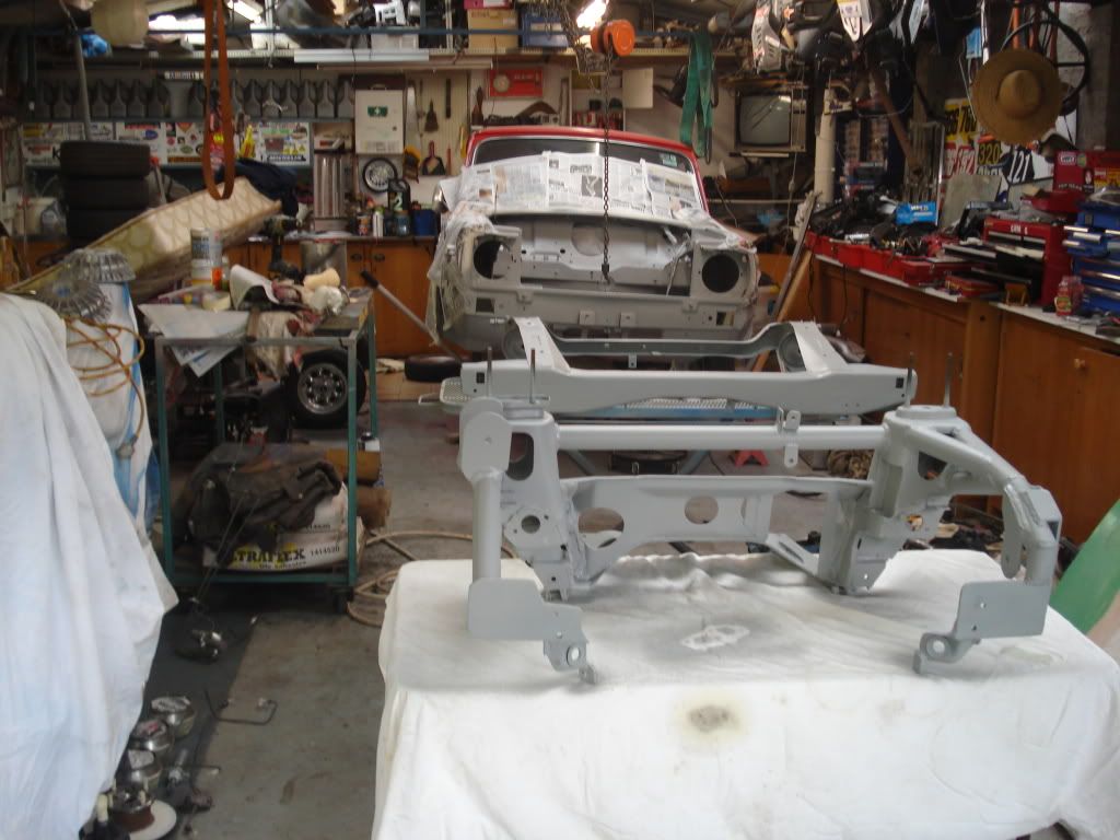

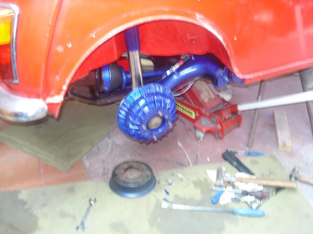

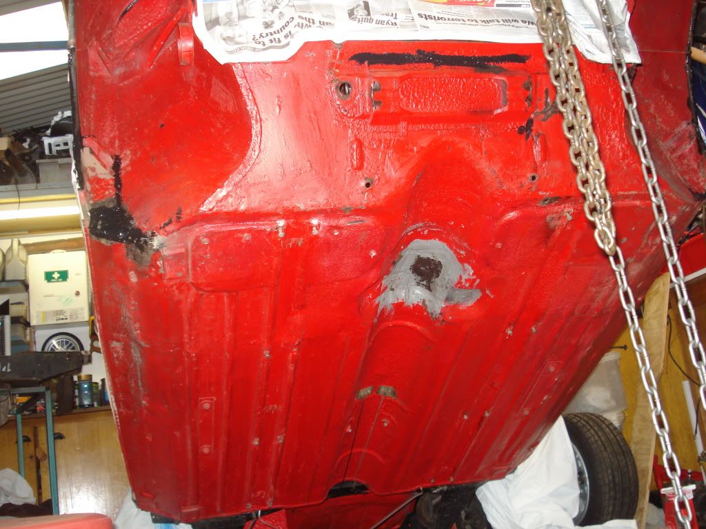

Update time

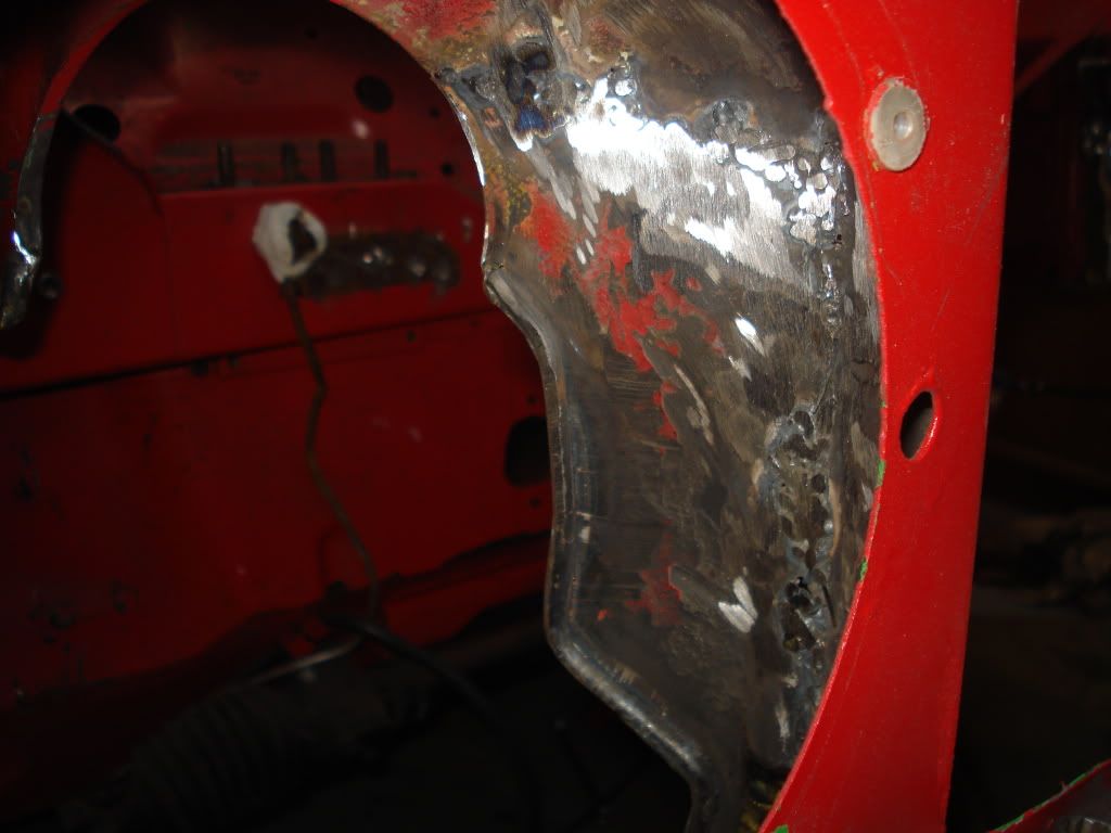

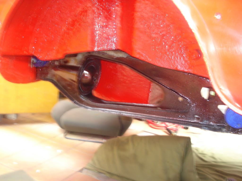

Here's one of the arches fitted

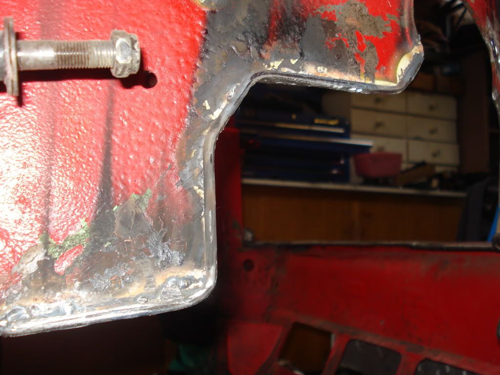

And a couple of the 6mm rod welded in place

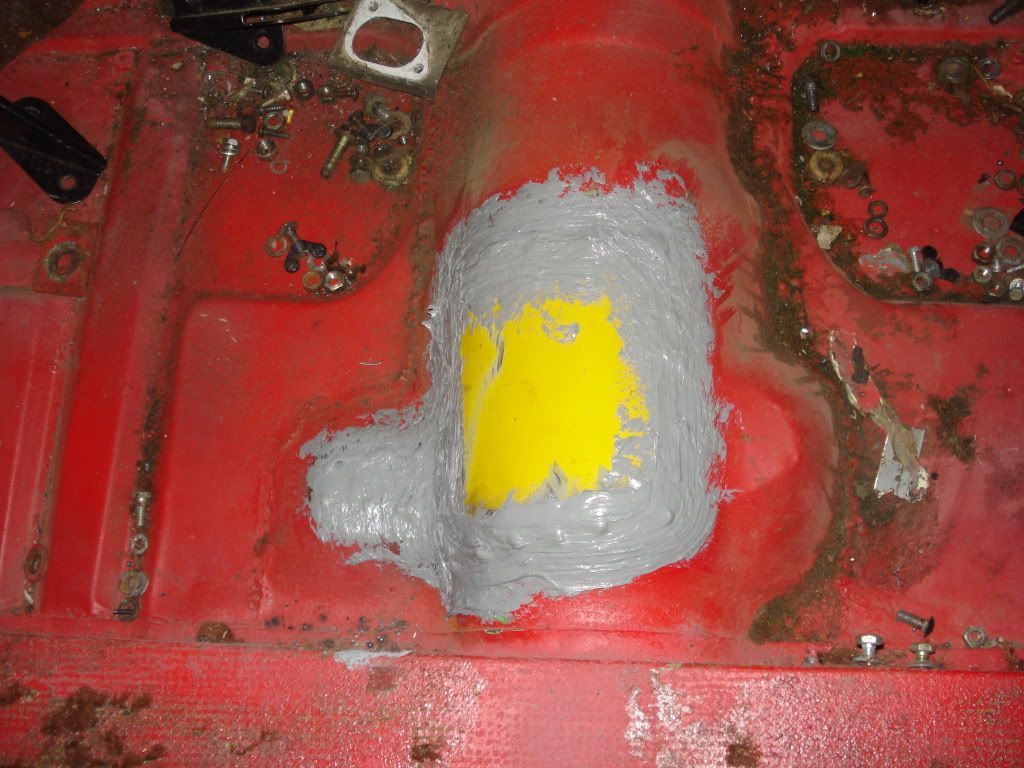

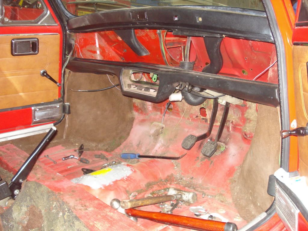

A couple of the old shifter hole filled in

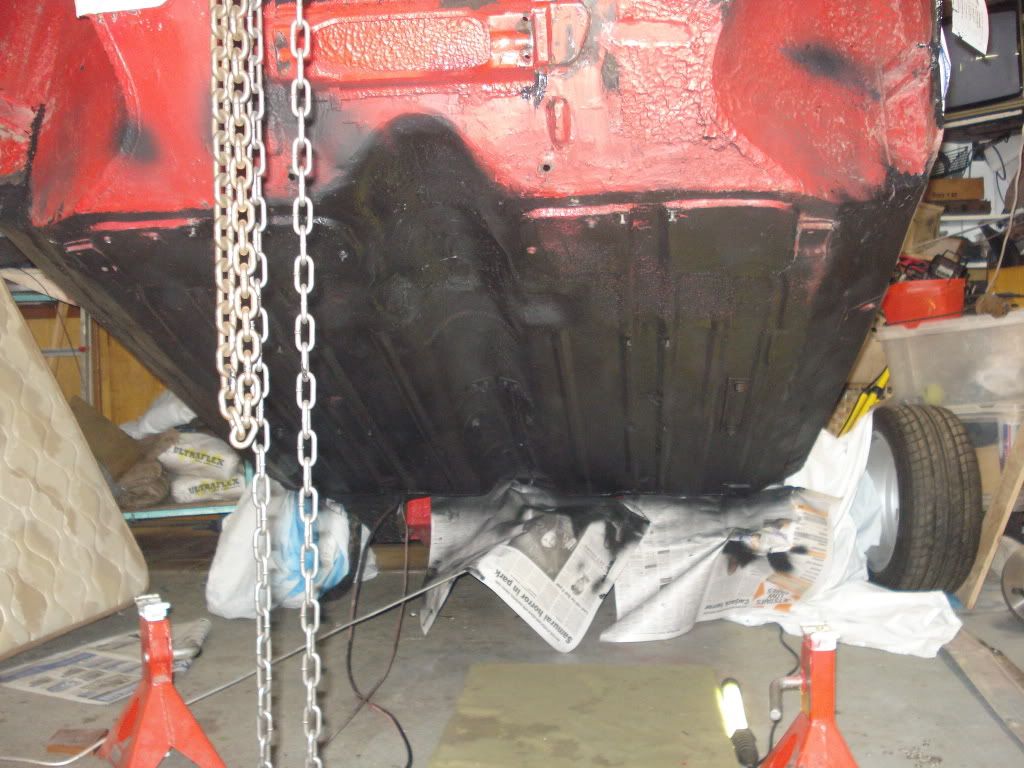

A good wash down and a quick coat of body deadner
The old girl swinging in the breeze

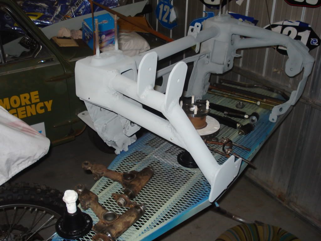

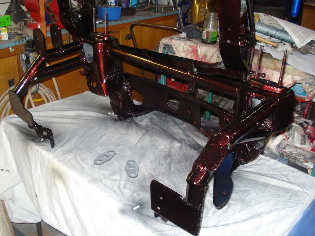

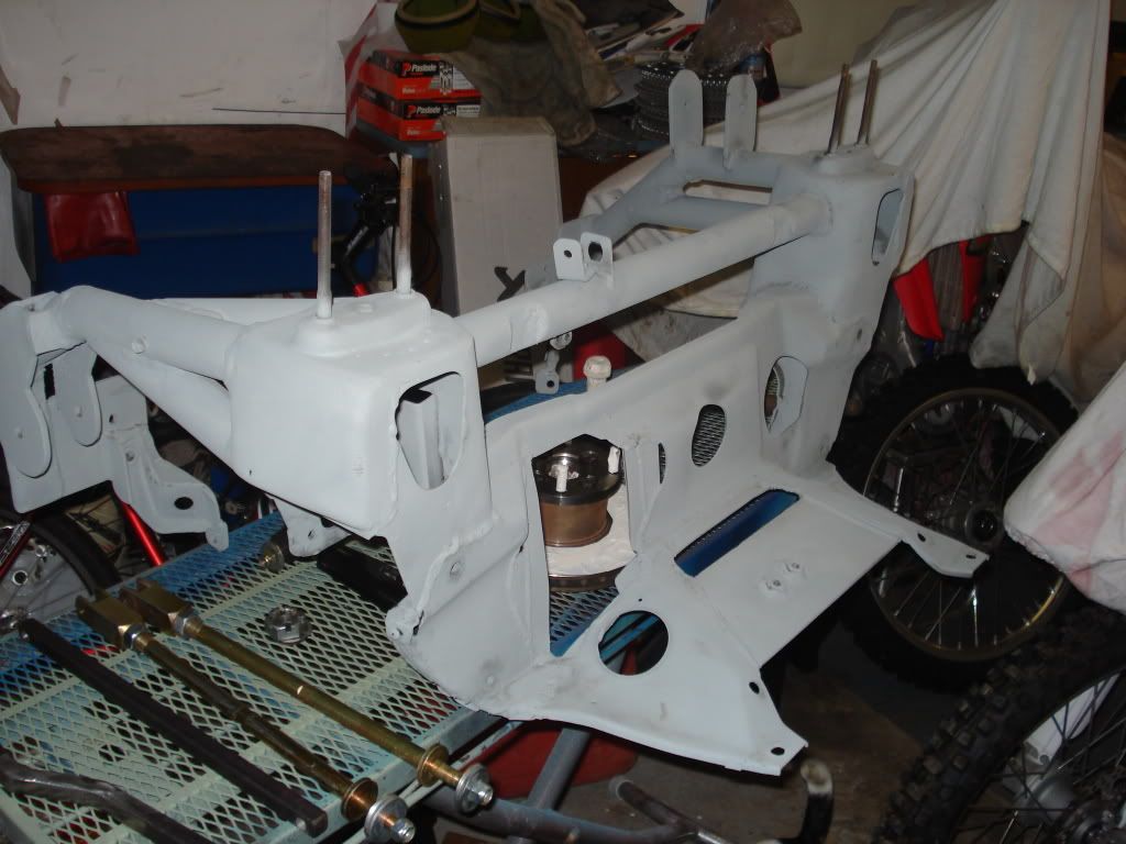

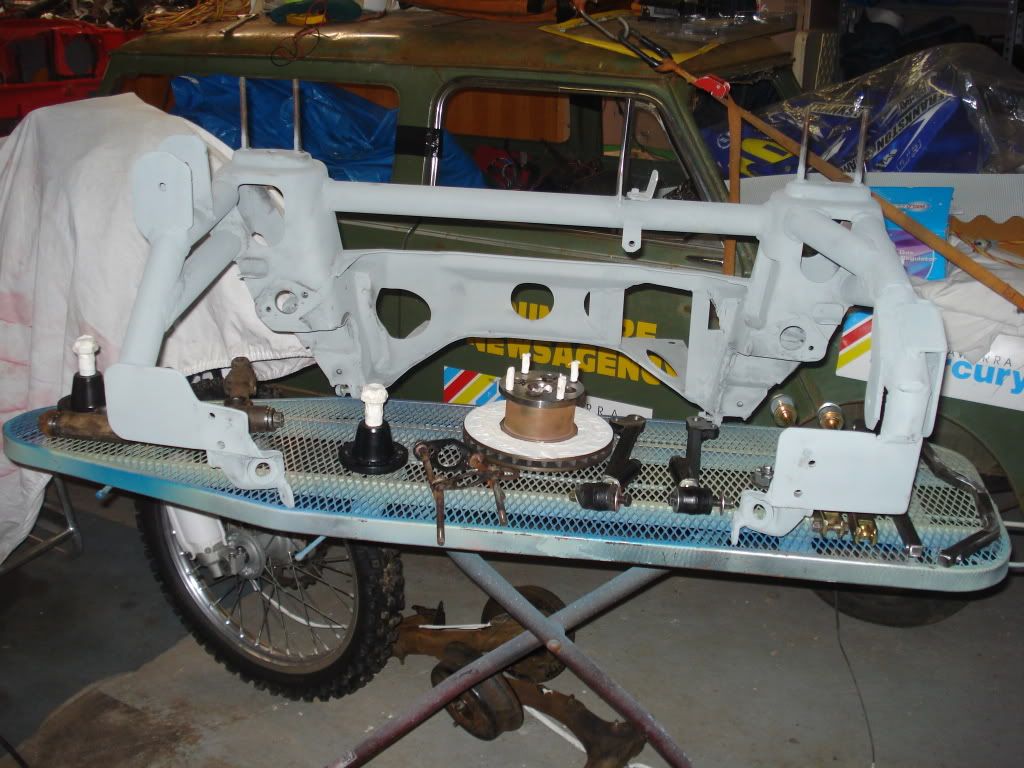

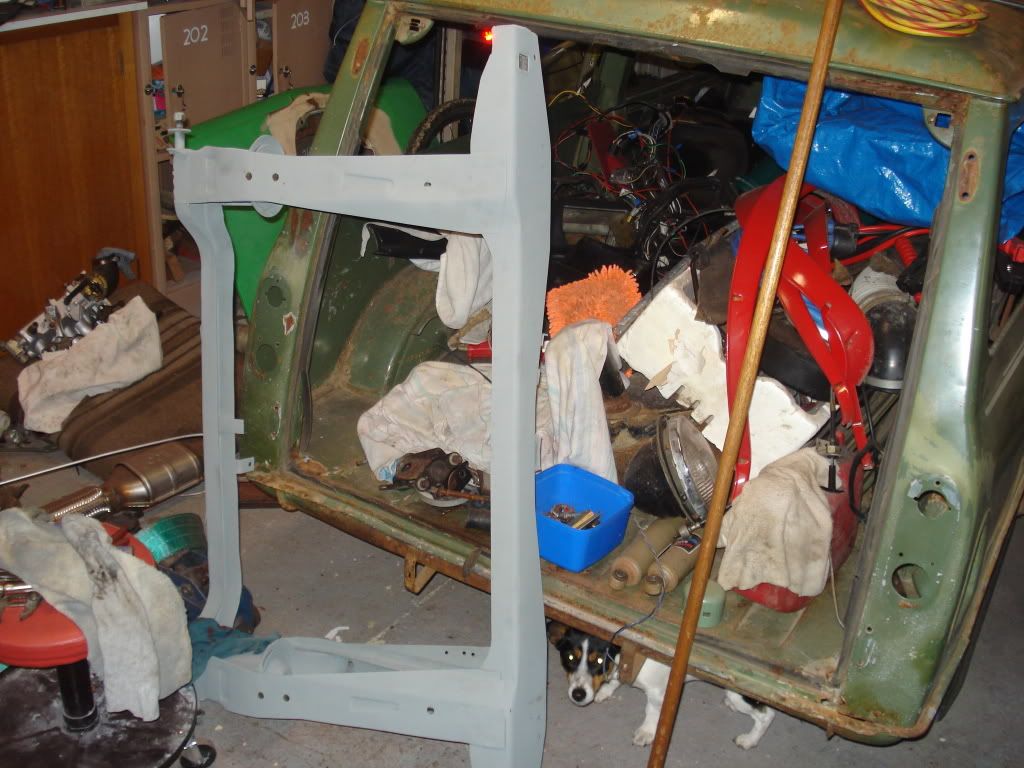

I painted the subframes tonight in primer, hope to top coat tomorrow
Rear subby
Front subframe and some other bits
Cheers Hallsey

The 6mm rod is a good idea and looks ace.

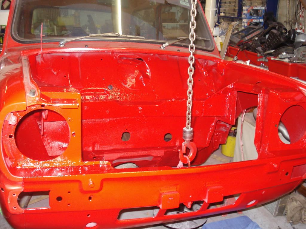

Well i got most of the stuff painted yesterday and i cant wait to
bolt it all together
The engine bay gets some undercoat
Then some color

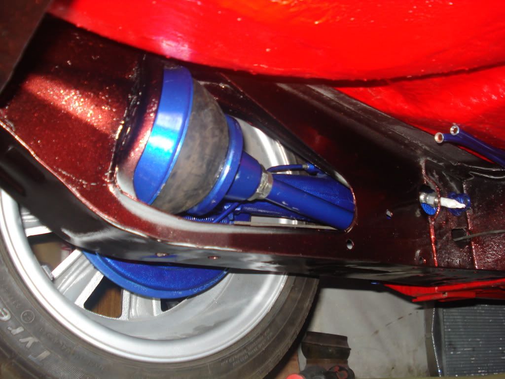

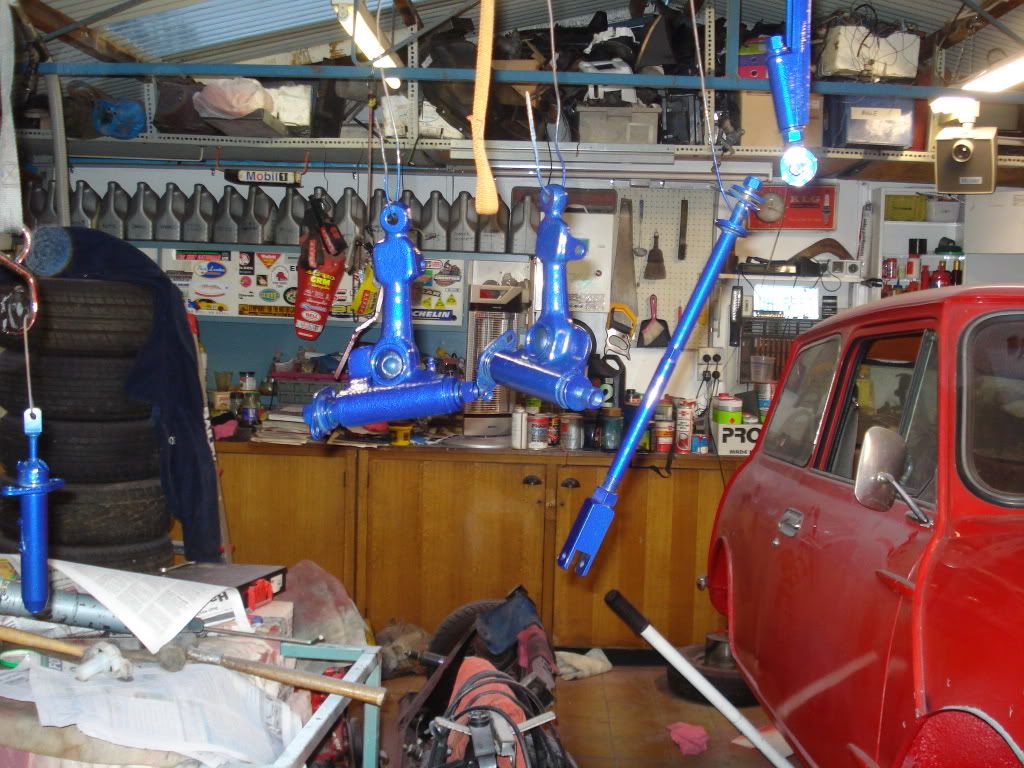

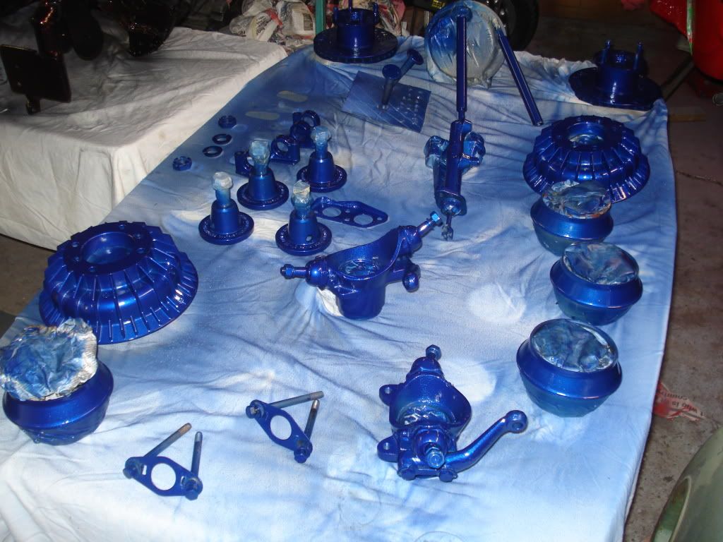

And the subframes are black with a red pearl
The flash from the camera really brings it out
And all the bits that hang off everywhere
Hope to get the rest painted during the week so i can finally put
everything on for the last time
Cheers Hallsey :D :D
PostPosted: Mon Aug 30, 2010 3:11 pm
Posts: 614
Location: Wyndham Green, Vic!
hallsey wrote:
Update time
Cheers Hallsey
ahhh.... I always wondered about the use of an ironing board - Until now! :shock:
-James.

PostPosted: Mon Aug 30, 2010 6:31 pm
Posts: 404
Yes but dont tell the missus she;ll want it back
Cheers Hallsey

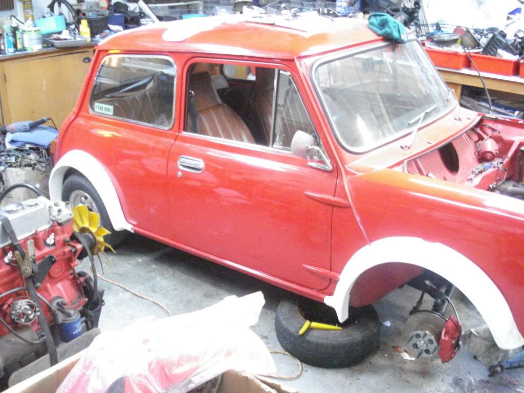

That is shaping into a very very good conversion... I need to get back into mine soon.... What are the flares you are using, they suit the car without looking too boy racerish!!

yeah its getting there, arches are Rover sports pack
fiberglass copies ,look good with the 13x7'

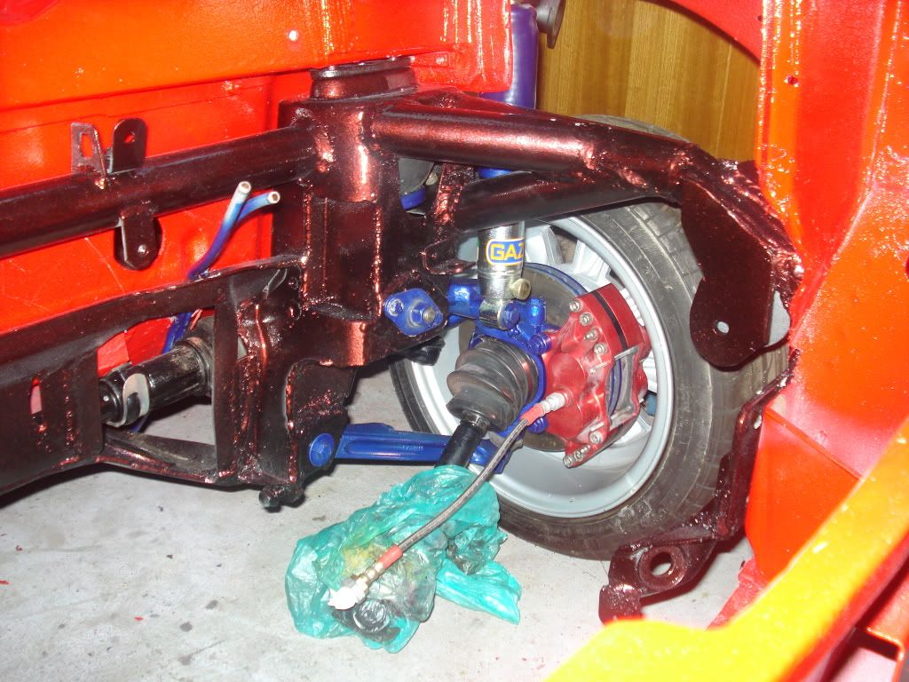

Subframes are in and she's a rolling shell again, i hope to have the motor
back in next weekend
And back on her feet again (might be able to move her out
