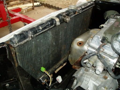

just a quick update that i thought mini owners might want to know
my new radiator is from a AE92 collorlla/ LE nova and its huge, dont think the motor will be overheating any time soon :D :D and it should work for all clubby's with original "A" series motors see pic

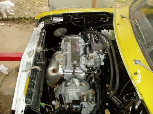

Also fitted the inlet manifold, i had to remake the middle runner because it would have hit into the bulkhead
today i added the radiator fan and air box so its getting pretty full in there, hope to start the wiring next week ,my mate who's an auto elec got me the diagrams its good enough to do the job after we when through it today :D

OMFG that is a huge fawkin rad :shock:

do you have some more detailed pics of the engine bay? and the manifold mod? naybe the airbox etc...
are you useing the sirion airbox?

hey joe i can take some close ups of different areas
the air box is from a VR commodore :shock: because its nice and square and is easy to obtain a filter anywhere i go, it sits where the old mini radiator was on top of the new gearbox
the manifold is comming of this week to get painted so i will take some pics of that 8)
I should have done some before and after shots ,my mate who welded it did a great job and you cant really tell its been changed
