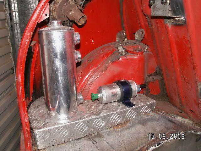

Here is a shot of the surge tank and pump in position, 2 litre capacity.
Hope this helps and thanks for the kind words.

PostPosted: Sat Sep 16, 2006 3:17 am
With a mounting flange on the top of the tank
- I did the same with a Subaru pump for my moke
sorry about the pic size :oops:
PostPosted: Sat Sep 16, 2006 6:40 am
gzeVan,
The sender is fixed in the identical manner to AWDMoke.
There are 8 x machine thread screws that screw into the reinforcing rijng at the top of the tank. The ring is clearly visible in the photo of the tank.
A rubber gasket underneath seals the whole unit.
Regards,
Andrew
