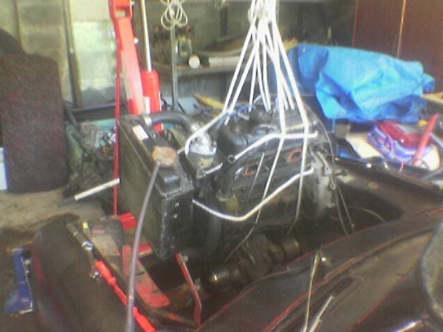

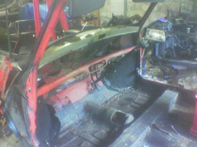

ok another semi update since nothing too big has happend since im stil waiting for queensland transport to contact me :(.

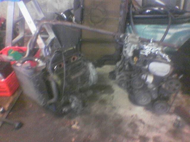

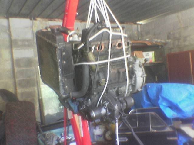

Ive removed the engine and its up for sale on ebay ( http://cgi.ebay.com.au/998cc-4-stroke-m ... dZViewItem ) so ill take whatever i can get for it. I have also removed all of the interior and the boot plus the twin tanks so now all i have is the rear subframe with brakes and wheels (so i can lift the front and roll the shell around)
A few pictures:
Appologies for the bad quality since i was to lazy to get the camera i had to use my phone
The interior with doors removed
Mini engine ad starlet engine side by side, they are pretty much the same size
Engine getting lifted out
And the empty bay
Next up will be completely stripping the paint inside and out and chucking it on a trailer to send to my uncle who owns a paint shop so i get to do most of it myself

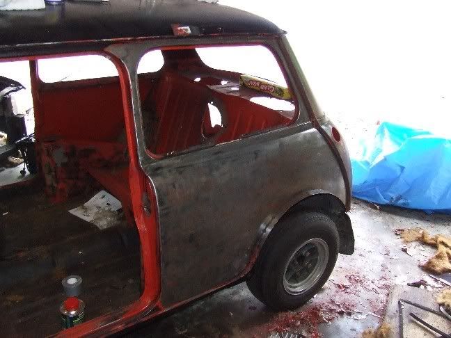

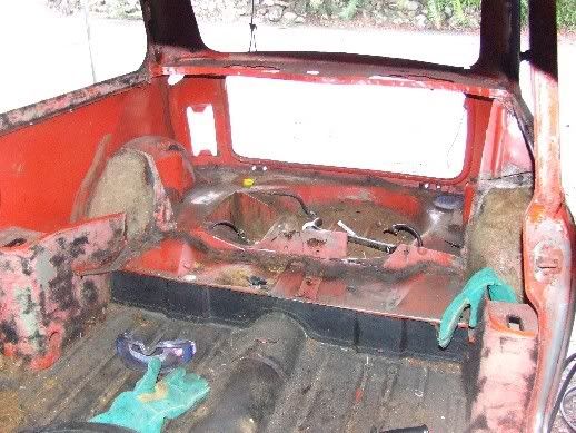

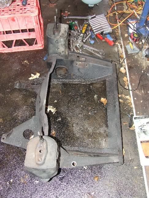

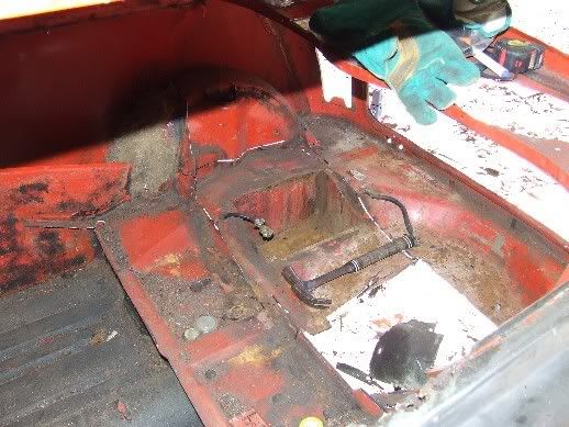

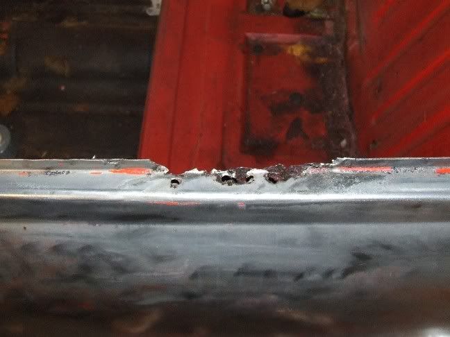

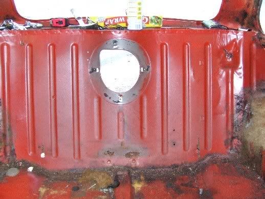

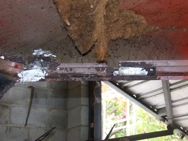

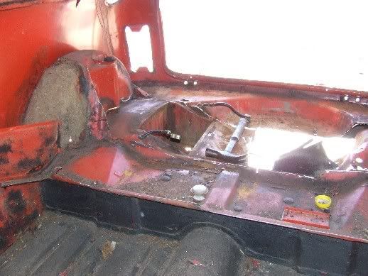

Work has been going slow due to spending my money on a daily driver since this project is taking so long i got a 1990 nissan pintara which was good for its price...

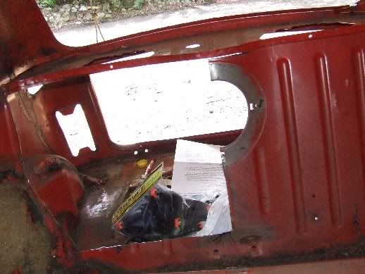

anyway back to the mini. Ive started to strip the pain from the rear panel as well as prep the other main rust areas in the mini plus some cleaning of the front subframe
Any ideas how to replace all the rust?
PostPosted: Fri May 11, 2007 4:53 pm
Weld in new sections is the only answer. That bit above the door looks bad :shock:
Preferably cut bits off a donor car, otherwise you will have to fold up some replacement sections.

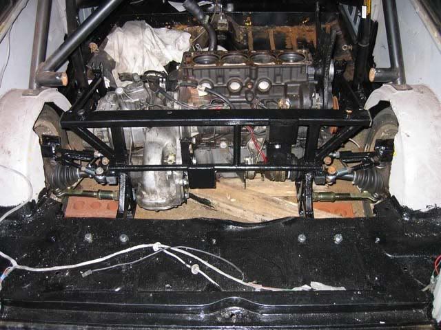

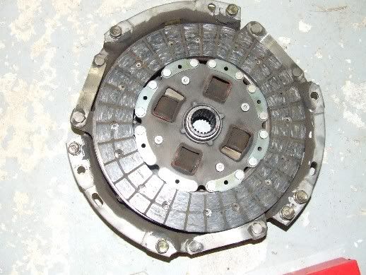

bit of progress

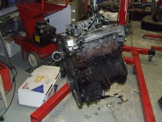

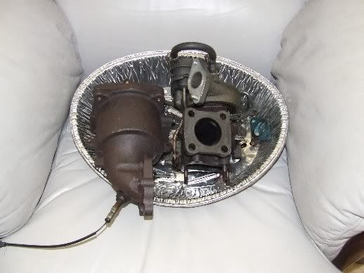

Mate and i worked on the engine too

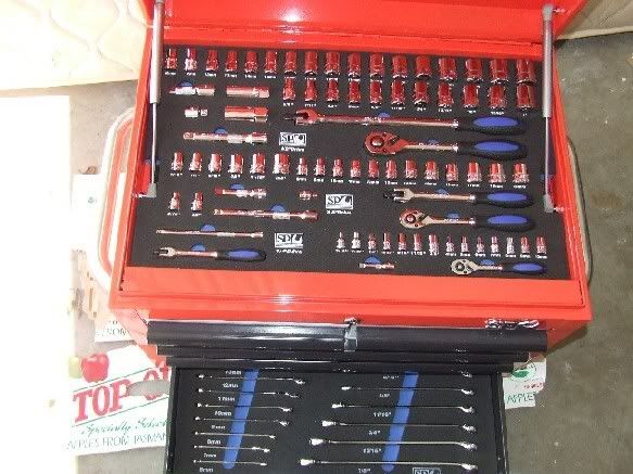

And my very cool new tool kit :D
PostPosted: Sun Jul 08, 2007 10:34 am
The Forkmeister
Posts: 1029
Location: camden
God dam!!! thats some major surgery there mate, your in up to your urm pits now.. :) ,good luck with the rest of the build mate and keep the updates rolling in.
Cheers Gerg
May the fork be with you.

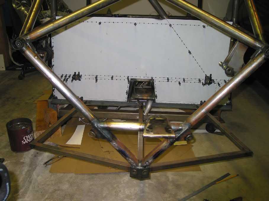

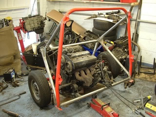

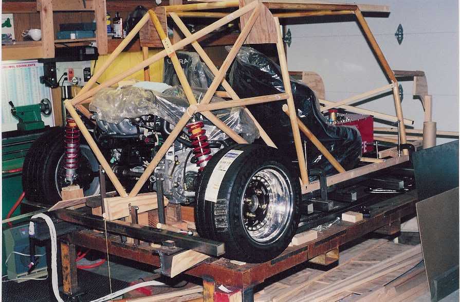

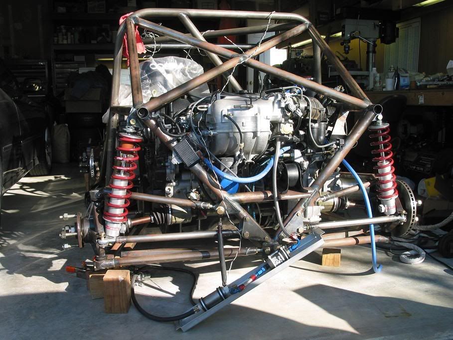

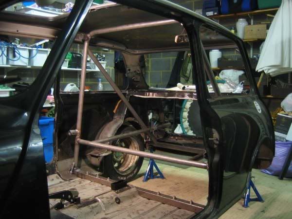

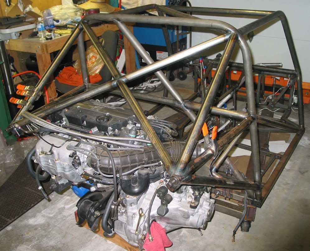

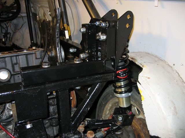

:D indeed tricky. Well the main design im using is similar to the zcars vtec kit with a bit of kimini (www.kimini.com) frame thrown in. I designed it so that i dont need a full rollcage, since i was unsure about the law regarding the door bars, and a lot of major bracing so that my rear window doesnt pop out when i turn a corner.
Basically it'll look like a mix between these designs (hopefully):
(piccys from www.theminiforum.co.uk, www.kimini.com, www.twinenginemini.co.uk)
