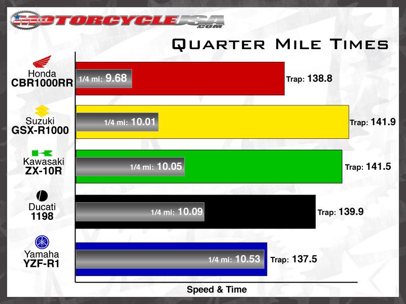

The CBR1000RR engine may be the weapon of choice according to the latest stats:
PostPosted: Tue Nov 22, 2011 8:24 pm
yeah the 2x Rage buggys that were competing in hillclimbs etc up here have just changed over to the CBR1000 things,,, they were already pretty quick before with the Kwaka engines
i was holding them both off at Mt Cootha hillclimb most of the weekend, but then i biffed the armco & hole-ed the radiator & pulled out of the last 3 runs so they ended up beating me by a pinch
now with the Honda donks i reckon they may have my measure,,, & if not then it will be real close
now i`m wishing i had enough money to afford the honda :-)

JC,
That graph to me looks like it'll be hard to go wrong!!!! Upgrading the clutches is the key to getting the power to work. Fortunately there are plenty of option available there.

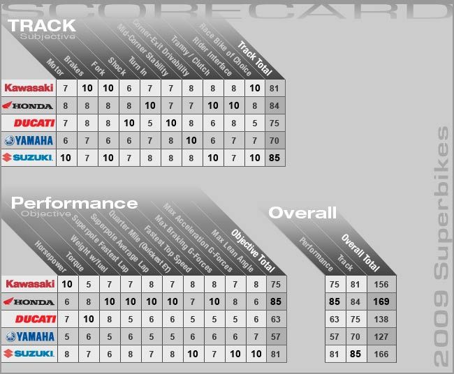

JC,
I might search the US for a motor while I'm here. They seem cheaper here.
Both the Gixxer and the Honda have 10/10 for the clutches/gearbox, so that would be a good starting point and seriously, I dont think you could go wrong with either engine!!
To me the Suzuki is all about the engine, while with the Honda, is more about the bike...

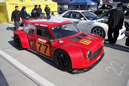

this is a few years old now but still--->
http://www.youtube.com/watch?v=eRmo55u4 ... _embedded#!
is the sort of thing i`d like to see you guys build
it`s a Hayabusa V8 , front (mid-engined), front wheel drive weapon
& it eats everything in it`s path
they did crash it a while ago, (fair enough, it`s stoopidly fast) but have resurrected it & is apparently eating everything in it`s path once again
there is a website dedicated to it`s build somewhere hidden in my computer but i can`t seem to find it atm
but anyways,,, not much on the race tracks ""Anywhere"" can keep up with this thing & it`s still only N/A,,, so you can only imagine a 4x4 turbo version yeah??? :-) ;-) ;-)
why stuff around with the baby toys boys,,, go hard or go home i say :-)
