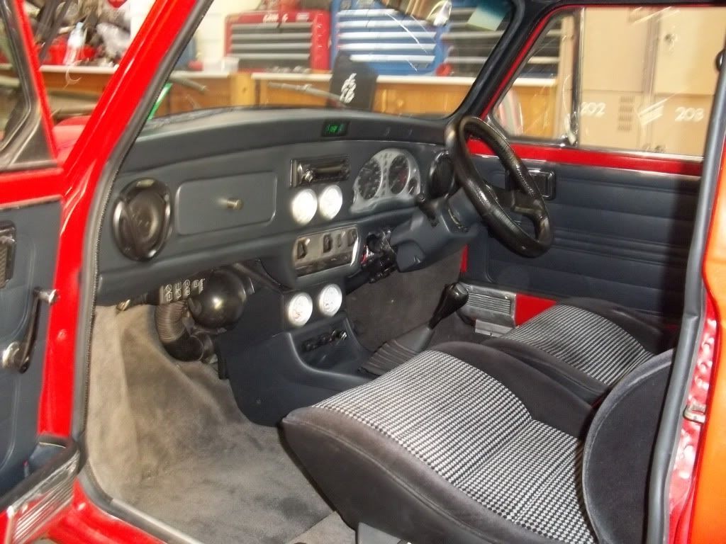

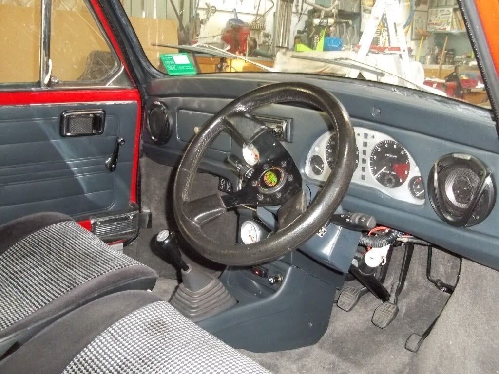

interior is nearly finished but i'm having some wiring gremlins
I only worked on the car this weekend after not touching for about a month(just over it)
Heres a few pics
I put a little toyota badge on the boot for a hint of what lies beneath :D

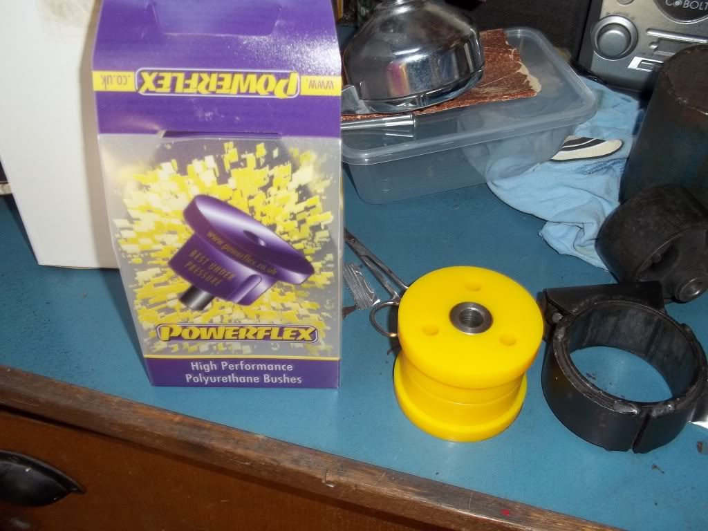

Also put some POWERFLEX poly engine mounts in to stiffen up the engine movement, seems to have worked well
Cheers Hallsey
PostPosted: Mon Jul 04, 2011 9:04 pm
Love the badge!!!
Let me know how those bushes work out for you Hallsey, I might have to get some of my own.

PostPosted: Mon Jul 04, 2011 9:07 pm
Posts: 953
Location: NOR, Perth, W.A.
I bought a set of those PowerFlex poly mounts for my conversion but ended up giving them to Rob ('arjay' on the forums). I'll be interested to see how he goes with his too. I've heard good reports in regards to reducing engine movement a lot.
-Alan
PostPosted: Tue Jul 05, 2011 9:02 am
Posts: 614
Location: Wyndham Green, Vic!
I've got a set on my car.... made a massive difference to engine movement!
Definitely recommended. :D
I've had them fitted for almost a year now and there is still very little movement of the engine even under very hard driving (track days) and less than ideal high speed down shifts (sh!t trackday driver :P )
-James.

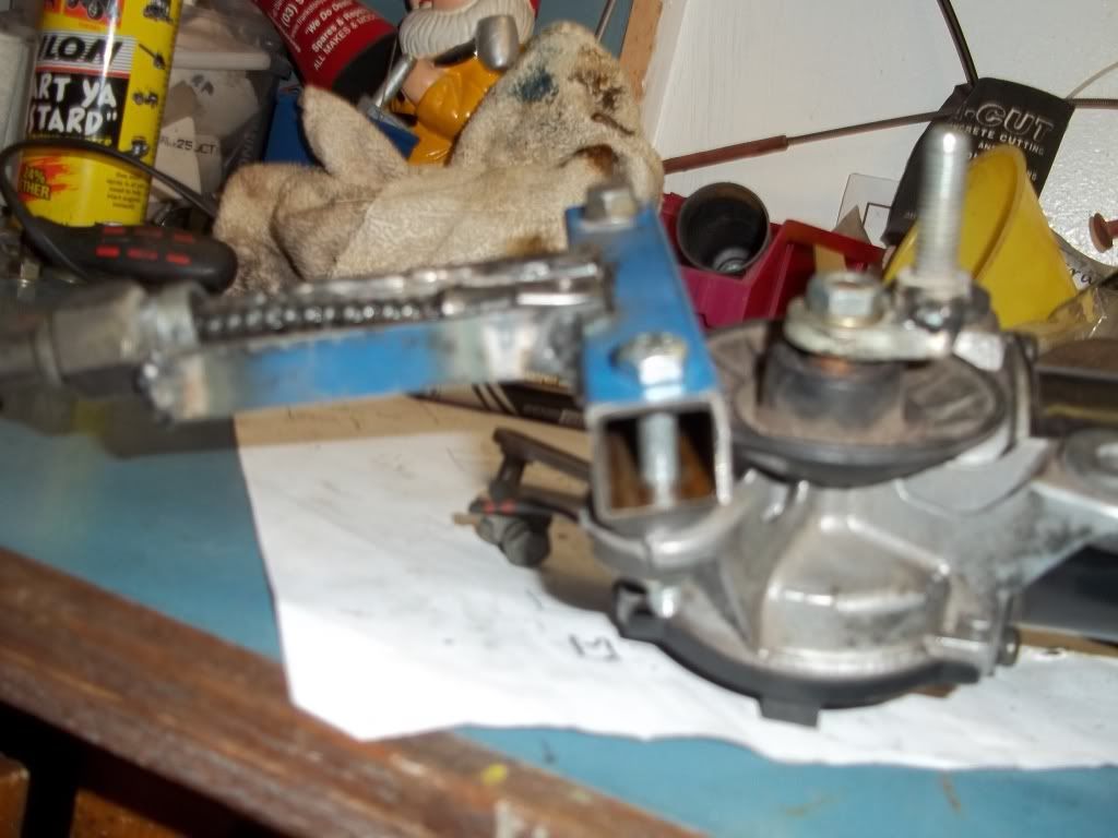

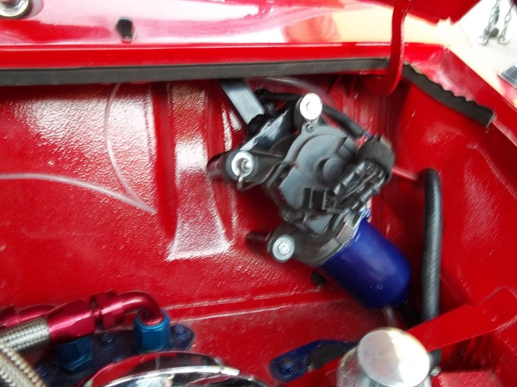

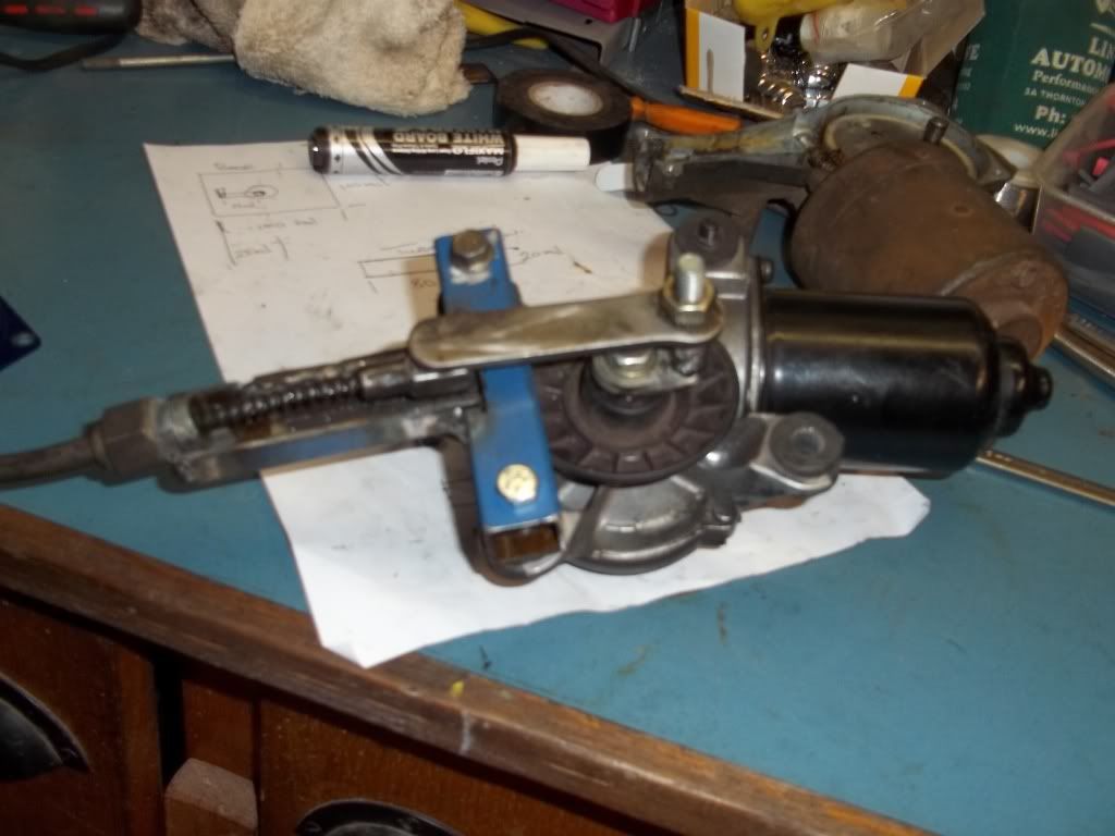

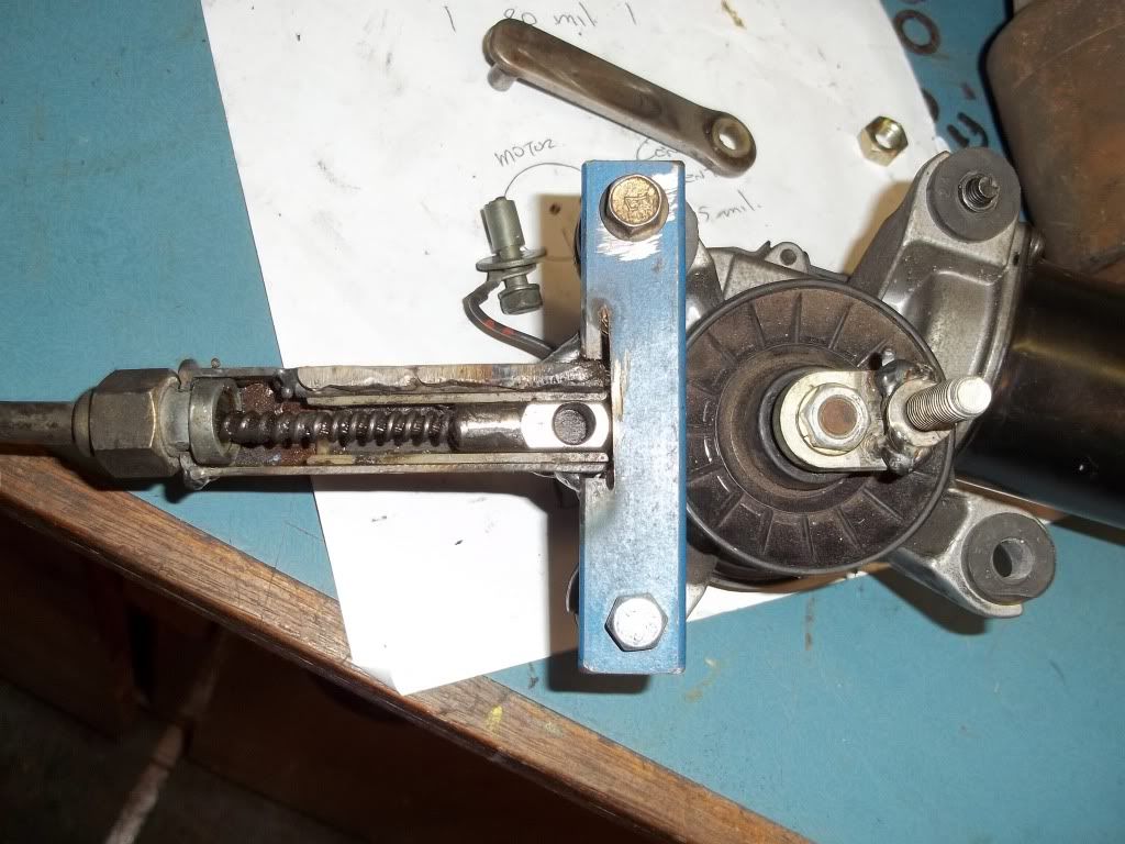

Been stuffing around with the wipers (yes had a look a the sticky's)
but could'nt get the wipers to park, so i decided to fit the starlet wiper motor, made up a little conversion bracket thingy(high tech name)
Had to shorten the mini cable and shorten the outer casing between the
passenger side wheel box and the wiper motor.
I should mention i'm using the starlet switch gear on the column and starlet wiring, anyway works a treat 2 speed ,intermitant and PARK
Cheers Hallsey
PostPosted: Thu Oct 06, 2011 5:53 pm
Now that is a bloody great idea. Good work!
PostPosted: Thu Oct 06, 2011 6:08 pm
Posts: 614
Love your work!
Good to see you got it sorted. :wink:
-James.

good on u mate what a top job.... did u make ur subframe urself??

Hi CL88MN ,yeah made the subframe myself but with collective idea's from all the builds on here
was this difficult???
i dont want to keep the mini switches in my conversion thats all,.

Was'nt to difficult, i just ground the mounting bracket for the switch gear off the starlet column and welded it to the mini column and as i'm using all the toyoyta wiring its just a matter of plugging it in
hope this helps
