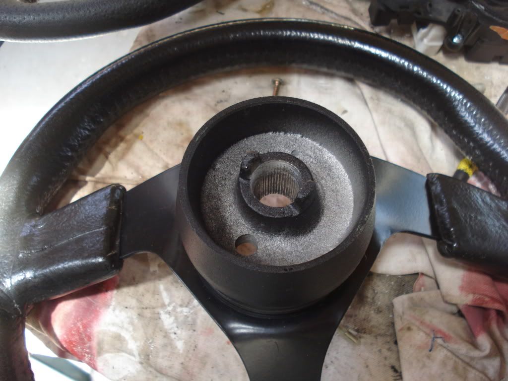

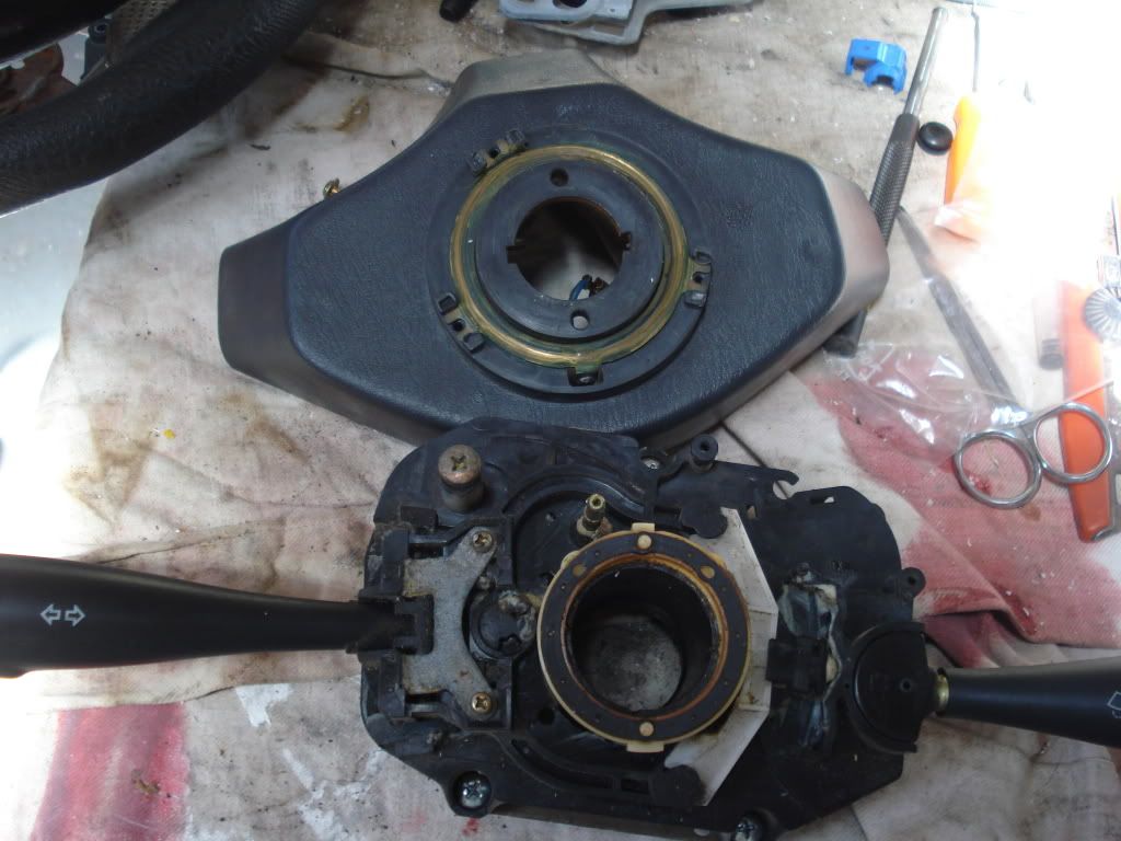

CL88MN - I have just completed this task with my Mini over the weekend (except that I didn't weld the bracket to the column)
See details on my latest blog post http://mearcatmini.blogspot.com/2011/10/starlet-mini-steering-columns.html
-Alan

Hey Hallsey,
Where did you source the replacement TMIC cover from?
The other thing is... how did you end up melding the SAAS steering wheel to the Starlet cluster?

Hey Zulu
cover is a standard 4efte cover, my original cover was stuffed and i scored this one from Tricky (archangel007)
As for the steering wheel i cut the bottom off the original starlet wheel and mated it to the bottom of the saas wheel
With the saas wheel on i then welded the starlet column bracket onto the
mini steering column( or check out mearcats good idea)at the point where the self canceling part of the switch gear was
Hope that makes sense , I cant find a photo of it after i done it
