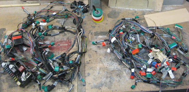

The real fun has started with me dealing with the Toyota Starlet wiring loom. I pulled all the loom tube and tape off everything and using the detailed wiring document that I made years ago, I marked each connector with electrical tape - green to keep; red to remove.
Instead of just installing the entire loom in the Mini and leaving unused wiring in place, I wanted to remove everything that I won't need - Electronic suspension, fog lights, all Air-conditioning components/sensors/relays, rear demister, rear wiper/washer, power mirrors, power windows etc. Starting at each connector, I traced each wire back to it's source, making sure it wasn't used by something else and this is what I stripped out (roll of electrical tape included for size reference :) )

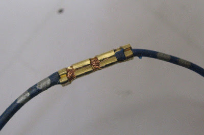

Any wires that needed to be rejoined were done with the proper crimps

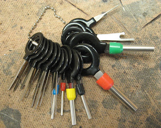

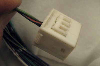

...and using a cheap eBay de-pin tool, I also removed all the terminal pins from the connectors
Just be aware that most connectors have a locking mechanism which has to be levered out before any pins can be removed
After approx 12 hours of work, all the redundant wiring was removed from the cabin & engine bay looms in the Mini. I quickly found that there was not enough room in the engine bay to comfortably fit the main fuse box so I have decided that this will be relocated somewhere behind the dash and as such, a lot of re-routing of wiring will have to be done and plenty more hours work in store...
I will also be adding wiring back into the loom for some gauges/sensors, dash lighting, stereo, central locking, power windows... and shortening/extending wiring for the modified positions of the alternator, battery, radiator, instrument cluster, ignition barrel.
