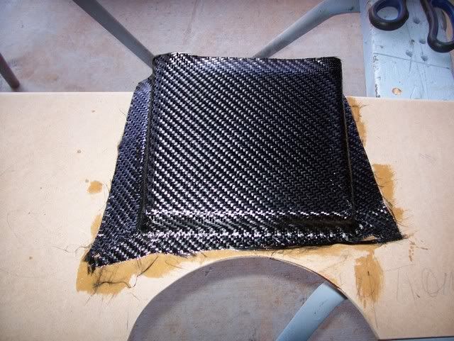

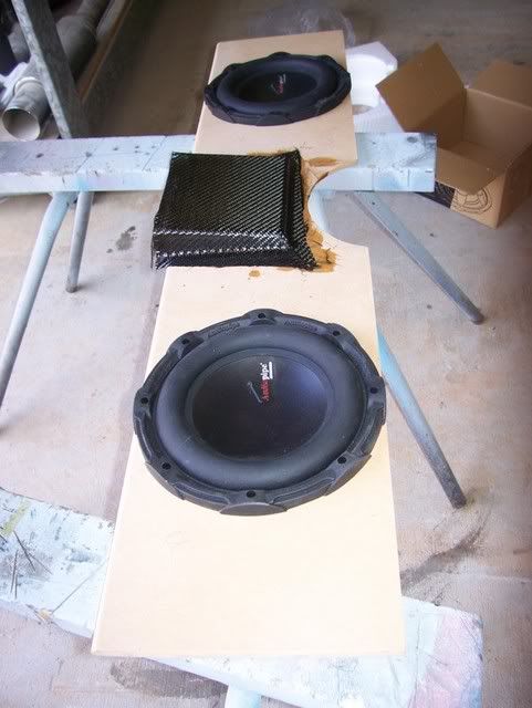

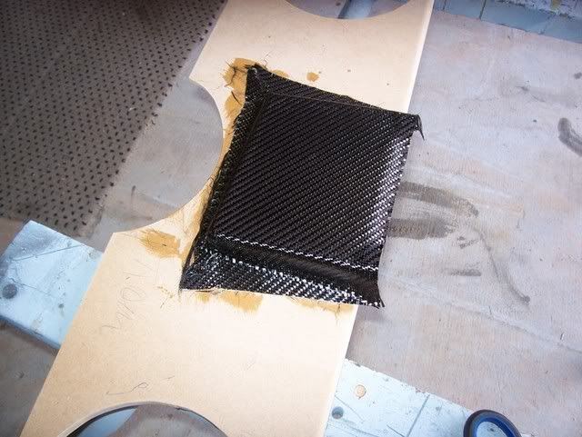

Back to the The Cat. I did a little bit of carbon fibre work on the subwoofer board just after lunch, so the small raised infill piece would have time to fully cure, before I covered the major section in carbon cloth. This will give it 24 hours to fully cure, before the next step.
This how it turned out:
Close up:

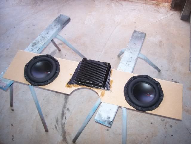

Tomorrow I will finsh it off in carbon fibre and then turn my attention to the midbass enclosure and door cards. Just for a lark, I thought I would test fit the 9" subwoofers to see how they looked. I am glad that I chose black-coned drivers, as I want them to disappear into the carbon fibre panel and not distract the eye.

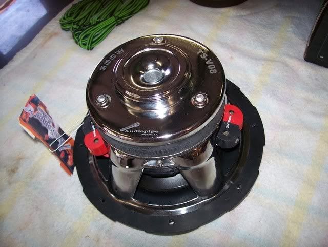

Here is a pic of the subwoofer business end - dual voice coil and 300W:
And here they are inserted in the subwoofer board - imagine if you can that the board is covered in carbon fibre - black on black (I will take some pics tomorrow of this again once the carbon fibre has been laid up):
Close up:

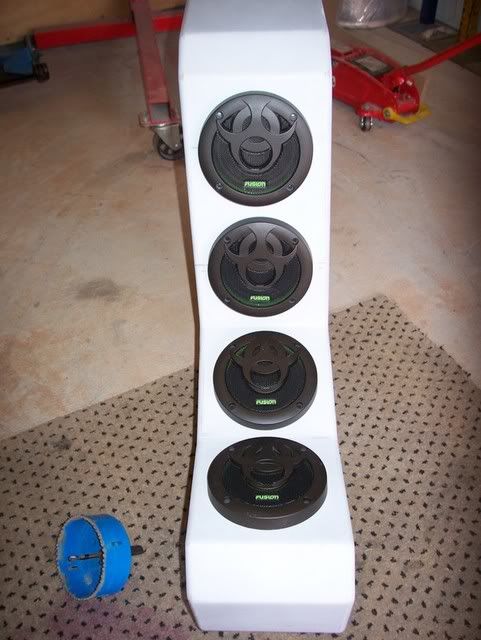

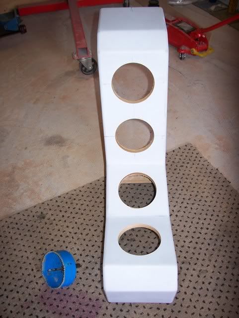

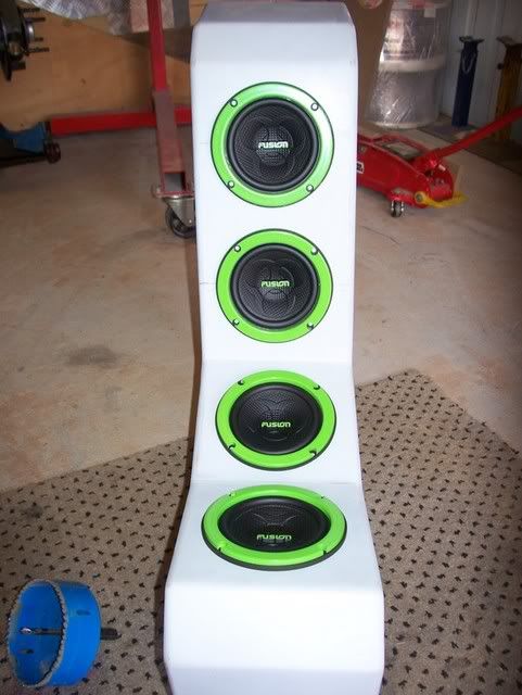

So, while all that was happening, I turned my attention to the midbass enclosure. I still had to do the holes for the speakers to drop through, so I pulled out my biggest holesaw I had and, as luck would have it, it was the right size. So off I went and drilled four holes for the 4" midbass drivers:
And then we test fit the speakers (love these little 4" blokes):
And with grills on (now imagine this in carbon fibre, with the grills on, or not - would look mega-cool:

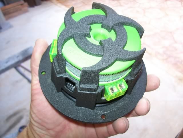

Have a look at the size of the magnet on these 4" drivers - massive. They would do justice to 6.5" speakers and I expect them to perform flawlessly:

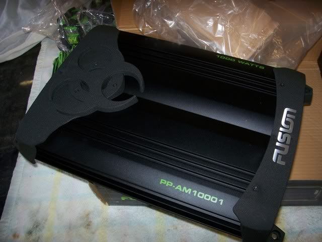

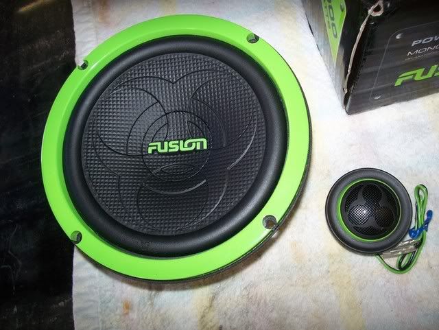

During the week the ICE gear arrived, and along with the 4" speakers shown, the 6.5" components showed up, and one of the amps - the 1000w Class D monoblock. Here it is sitting on the bonnet of Crusty Octavius:

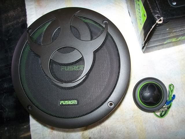

The 6.5" components are just biger versions of the 4" midbass drivers. Nice big magnet, cast aluminium basket and polypropolene/carbon fibre cone. With grill on:
And with grill off (sexy eh?):

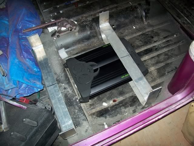

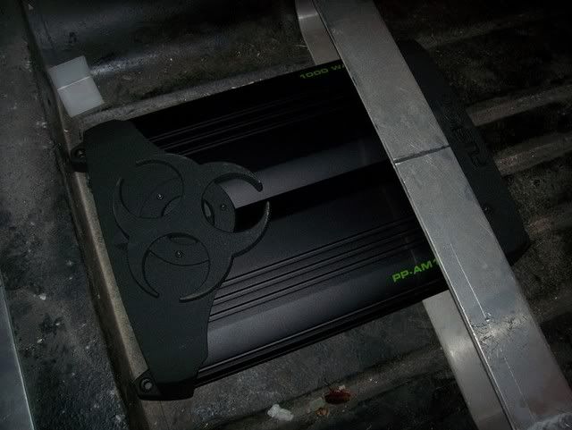

The 6.5" speakers will sit in the doors, with the tweeters high up in the dash, pointing directly at the driver/passenger. Should lift the sound stage up nicely. Now, onto the amplifier - the amplifiers will sit under the seats, semi-hidden but semi-protected as well. Here's a pic of the amp - like the speakers and boards, its in stealth black:
Test fitting the amp through the seat mounting brackets. Perfect fit, 5mm to spare:
Close up:
