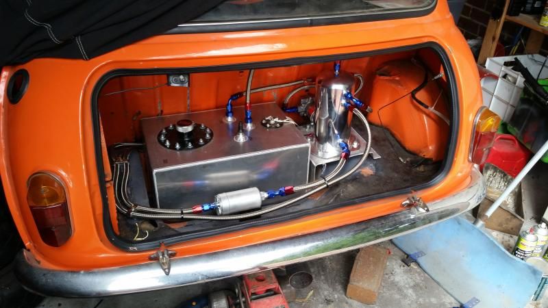

Not much of an update but I've put the pedals back in and run the brake and clutch lines from them
I got a few more fuel parts too so just sat them in the boot and made up some lines, obviously this isn't how it's going to me sitting, it will be a lot tidier and mounted on a level bracket. I've decided to use my holley pump as a lift pump for now as it's got a reasonable flow rate but if it's no good i can swap it out pretty easily. Main pump is a bosch 044
Potato

PostPosted: Thu Sep 25, 2014 3:16 pm
Posts: 4682
Location: sunbury victoria
Did some tidying and mocking up of the fuel system.
Almost ready to come back out and paint everything, just waiting on some brackets
Potato

PostPosted: Sat Sep 27, 2014 8:10 pm
Posts: 4682
Got some paint on the boot and finished up the bits on the front today as well as painting a few more parts. Didn't fuss with the boot too much just threw stone guard and paint at it as it's going to be covered by all the fuel gear.
Potato
