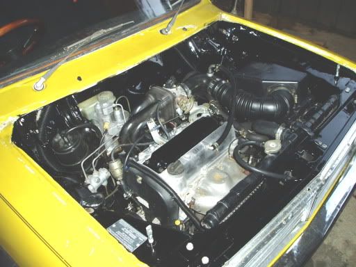

here is finished product

PostPosted: Sun Jun 18, 2006 10:00 am
Hi Paul,
Looks very neat and tidy.
Congrats on a job wel done - look forward to getting the road report.
