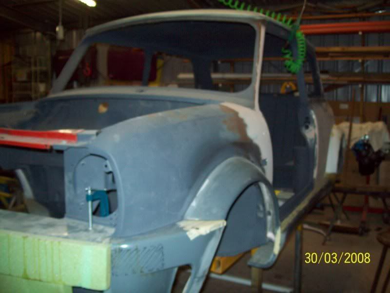

Okay, time for a quick update................
With Easter well and truly over, and no work getting done on The Cat in that time (due to picking up 4 Paw from Simon's place), its time to start back on the Mini in earnest.
At this point in time, all the bodykit is permanently affixed to the car, except for the front spoiler which has to be reshaped and wont be affixed permanently anyway, and all the joints glassed in.
Today I started bogging and fairing the glassed joints and also all the screw holes as well. The join where the fibreglass part affixes to the body will also have to be bogged, faired and sanded smooth.
I am using epoxy resin and microballons as the filler as this will entail that no shrinkback will occur (unlike bog), and also it bonds really well with the fibreglass panel.
Drivers side:

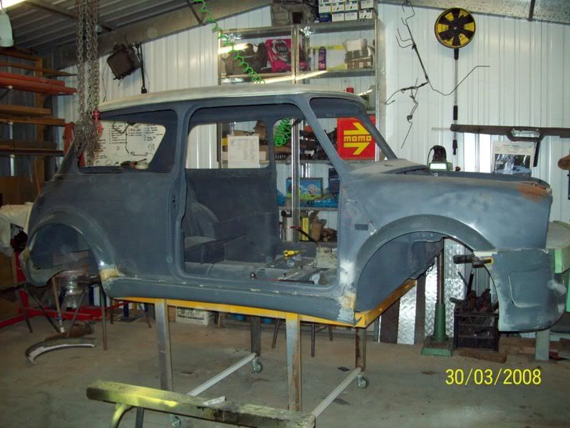

Passengers side:

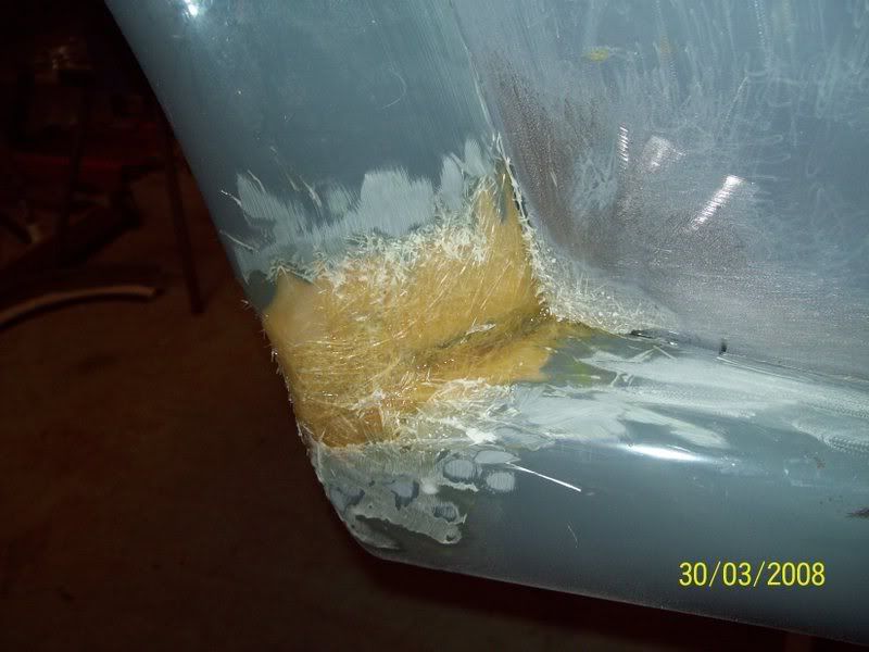

Any fibreglass to fibreglass joint has been glassed over for strength and to give that seamless look:

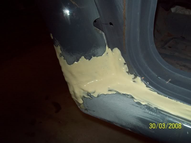

And then bogged with a mix of epoxy resin and microballons:

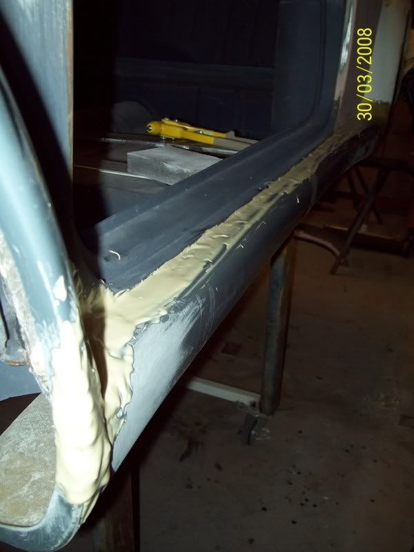

As does all the screw holes and bodykit to shell joints:
