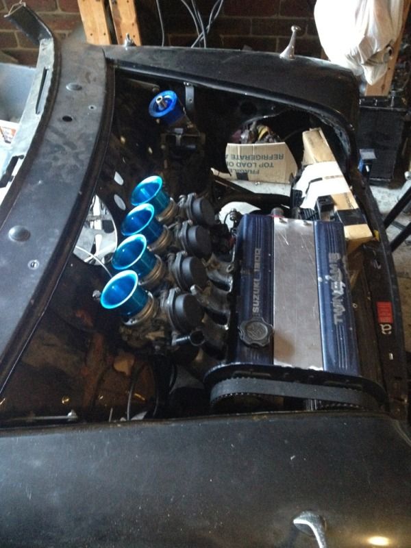

Added some ram tubes to complete the look.. Even if they suck they look awesome lol

More trumpets than the Glen Miller big brass band!
What are you doing for air filters or an air box Sean?
Tricky
PostPosted: Fri Jul 06, 2012 9:43 am
Posts: 4682
Location: sunbury victoria
I think it's going to need an air box, to pass engineering anyway, but when it's on the road Thattle come off and il just put some pipercross weber filter socks on them and take them off for shows etc.. That's the plan anyway

Nah, I have that on the race car, but testing has shown that they seriously defeat the purpose of the ram tubes to increase air flow:
:wink: No filters > Air box > Socks > Mesh
I'd like something like this, but don't think it'll fit. Just have to stick with socks I suppose.

I could tig something up fairly easily, only drama I have is space between it and the bonnet, il probably have a slight bulge in it anyway but don't want it to look too rediculous
