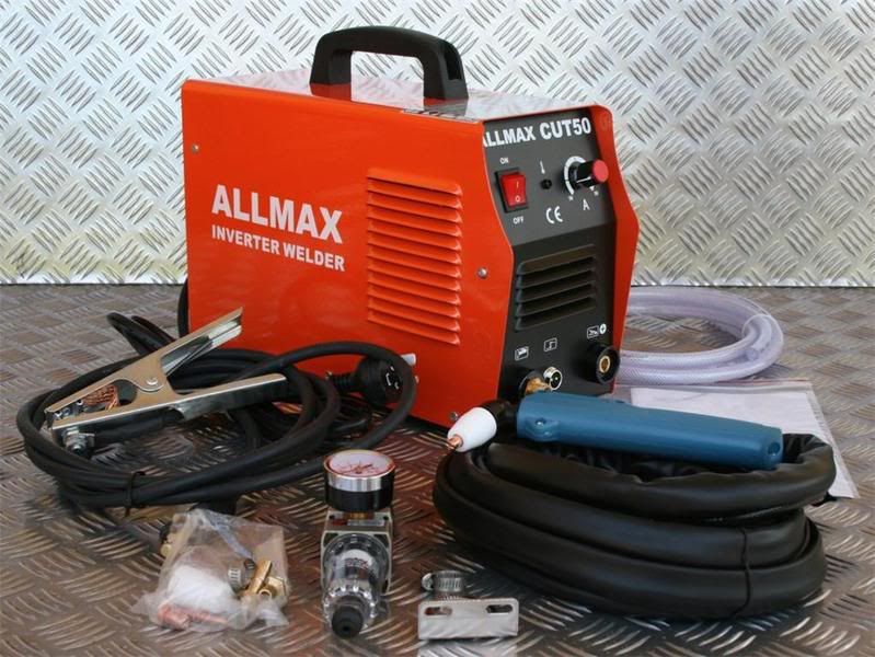

Just been doing a bit of shopping of late, I now have bought a panbrake, plasma cutter and pipe bender to go with the new TIG.
I used the plasma cutter for the first time on the weekend, man, what did I ever do without this little machine, they are awesome. It is rated at 50amps max, and they state it will cut up to 16mm plate :shock: Intricate shapes are a POP, and even though I was only doing 4mm thick 50x50 RHS (making the stand for the pan brake) on the weekend, it cut like a knife through butter on 10amps. It is so easy to cut straight lines pencil thin freehand.

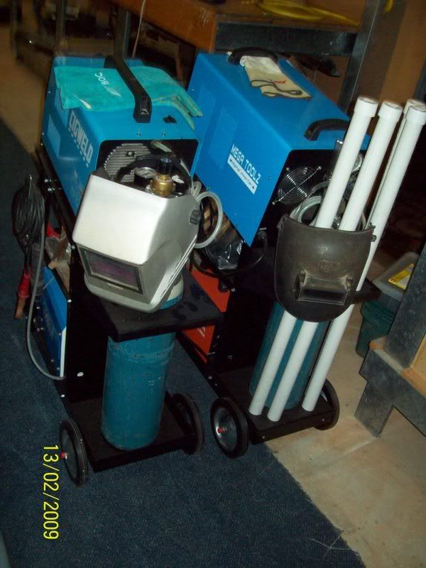

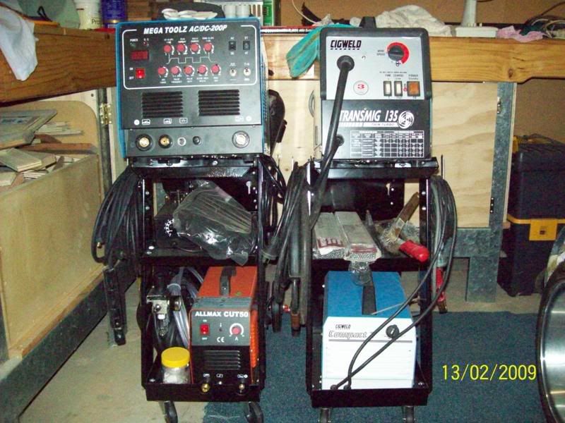

Here is a pic of the 'boys' altogether - 200Amp TIG, 50Amp Plasma, 135Amp MIG, and 150Amp Arc. I made up the trolleys so that they could be ultra portable and flexible. Thats the end of my welding machine purchases for good I should think.
The gas bottles are all held securely, and the vertical PVC tubes on the TIG stand hold all my rods - mild steel, alloy, stainless steel and CrMo. As you can see, nice neat self-contained and totally portable units.

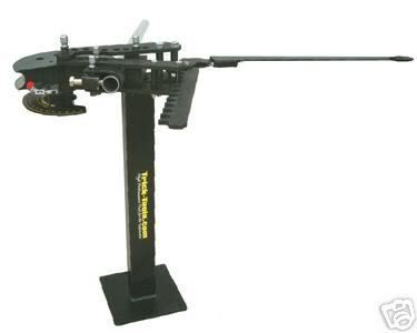

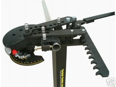

And this is the pipe bender I am waiting on. I have the plans for this on my laptop (if anyone wants them), and I got all the steel laser cut here in Brissie for $400. The retails price from Sydney was $750 plus freight. The dies are of course extra (about $500 per die). It will bend up to 50mm tube/pipe, and 50mm RHS.
It is not a true mandrel bender, but a 'friction' bender, that draws pipe along a die to maintain the shape. It doesnt crush the pipe like a compression bender. It will do up to 5.0mm wall thickness on 50mm pipe.
