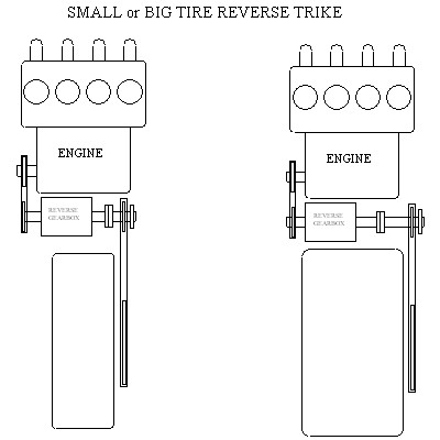

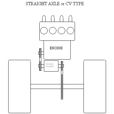

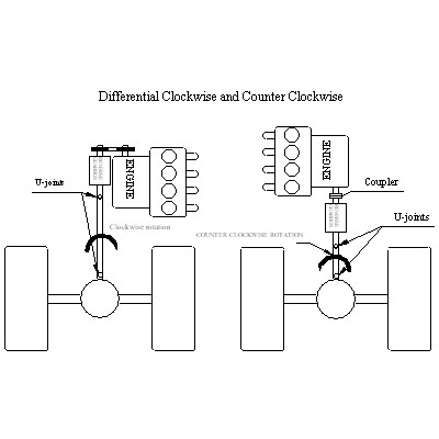

JC - does that reverse box sit inline?? I would like to see how they are setup. I dont think you would need that pan JC as the output shaft on them are mounted very low. You could always modify it later of course! Good buy on the Spax too - man this thing is coming together quick!!
A number of possible configurations.
