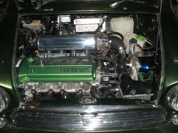

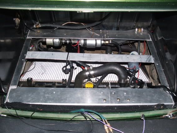

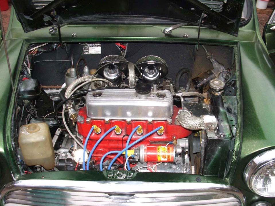

I decided it was time to show you guys what i've been up to since the purchase of the motor last August
i wanted to keep it under wraps to make sure it would work i took heaps of pics ot many to show but here are a few to show you the end product
THE CAR
THE OLD MOTOR
the NEW MOTOR
THE BOOT
THE RAD/FUEL SETUP
IT WAS ALL POSSIBLE WITH A LOT OF HELP FROM A GOOD MATE ADAM,JOE AND MY BROTHER THANKS ALOT TO THOSE PEOPLE
HOPE YOU LIKE IT

You sneaky bugger!
That is insane.
LOVELY work!

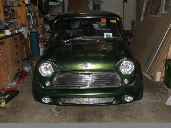

That looks awsome, what body kit is on it?
What did you get the engine out of?

the body kit is majic kit from auto fashion in England
the motor toyota 4efte

how did the surge tank go ?

hey paul yes decided to do it
the surge tank worked had other dramas but they are all sorted

Wats the body kit worth?

I paid $1100aus 3 years ago i do beleive they have gone up in price
and i think there some local guy making them now just do a search on the forum

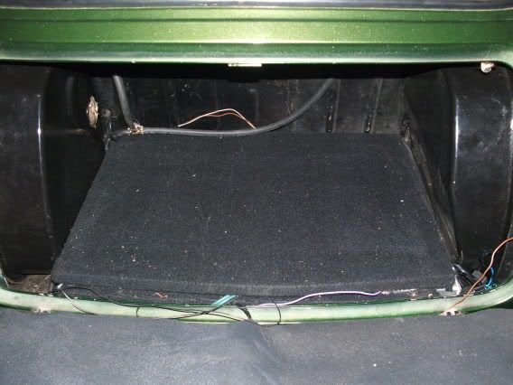

PostPosted: Mon Aug 07, 2006 11:10 pm
Very professional & damn HOT 8)
Impressed by the way you still have a useable boot space!

Does this car breach the conditions of a car that is able to be driven by a "P" plater in NSW?
PostPosted: Mon Aug 07, 2006 11:43 pm
Almost every damn one!
* Modified X
* Turbocharged X
if it was V8 it would be a pinup poster of what's not allowed!
