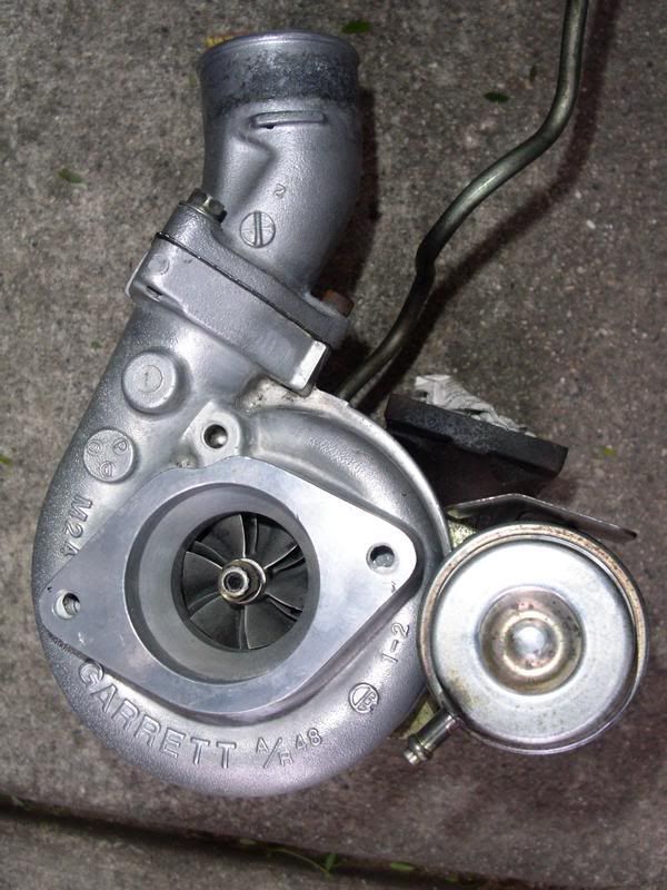

i have a t25 turbo with an A/R 48 compressor wheel... the same turbos found on the CA18DET engines!
i will be using it with the standard actuator which runs the turbo at around 7-8 pounds of boost.

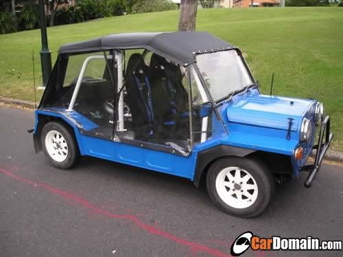

this is the moke before the engine conversion started!

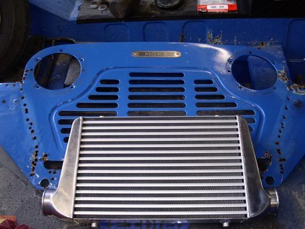

this is approx where the intercooler will be mounted

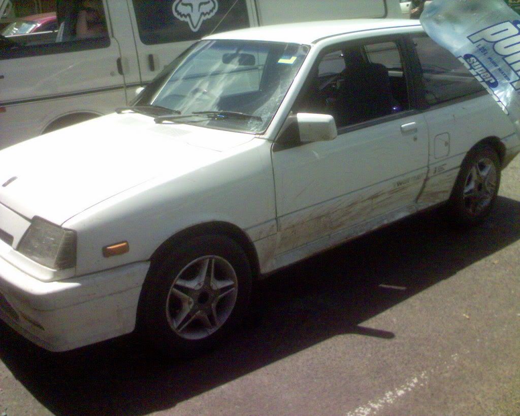

this is the donor swift gti

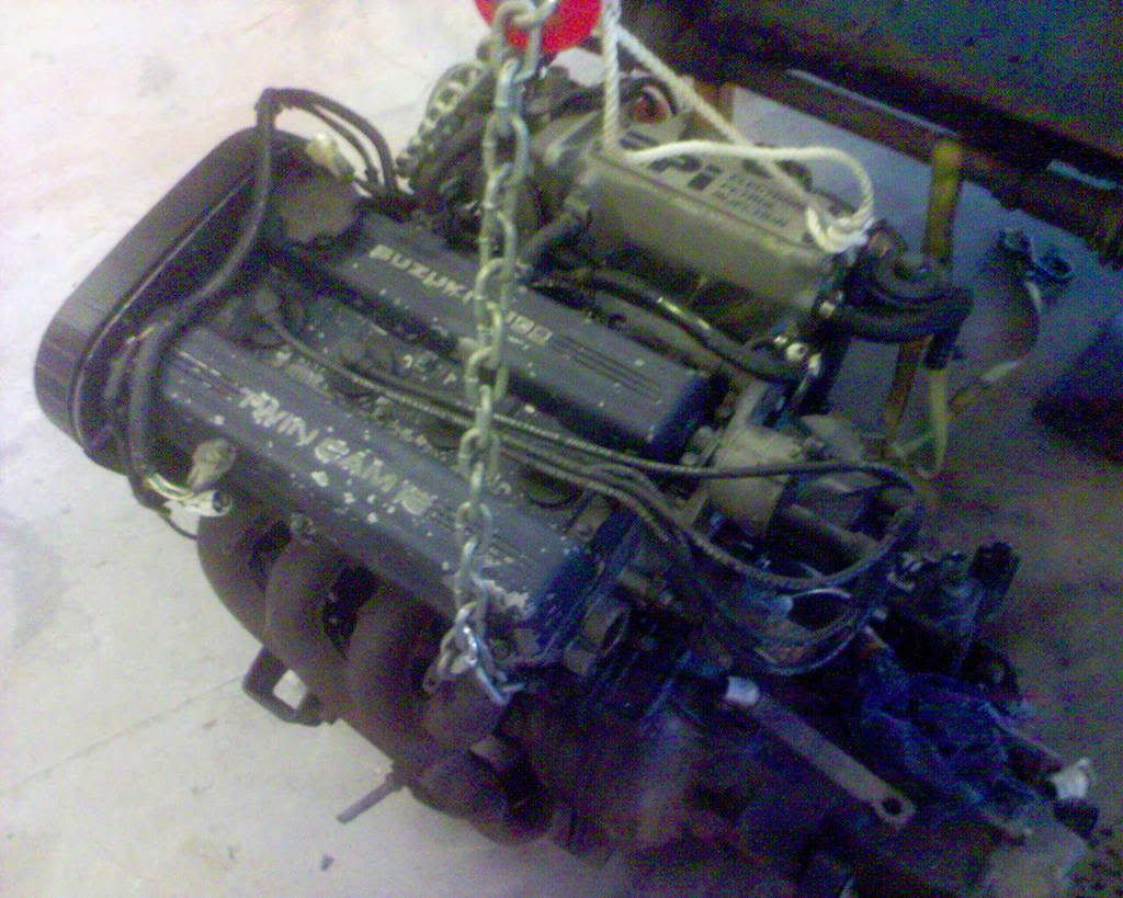

this is the G13B engine

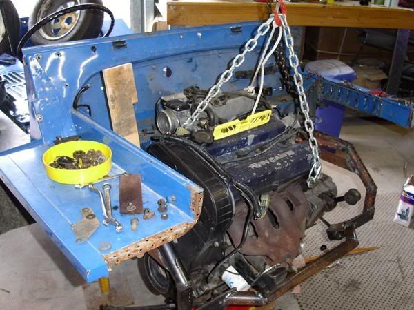

this is the engine in the newly made custom subframe, its fully supported by the sumbframe at this point, there is slack in that chain!

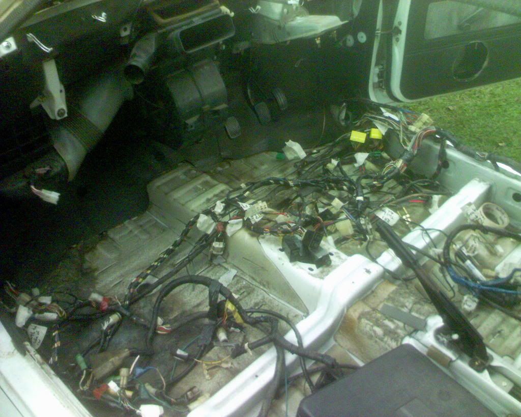

this is the wiring harness that i pulled out of the donor swift, the majority of this will be going into the moke!
and this is the turbo that i will bu using!

looks cool, i hope your build goes as you hope and doesnt cause many dramas. your going to catch many a bug with your cooler up front. if i had a moke i'd be going for a dihatsu diesel 4wd engine and spray the car olive drab with rattle cans :lol:
