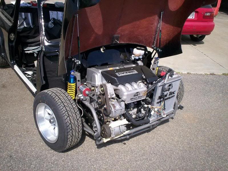

K series Honda. If only you didn't have to extend the front....
oh yeah and the original kit for sale on ebay
http://cgi.ebay.com/ebaymotors/MTB-Kit- ... 6586QQrdZ1
which is $1000US cheaper than their stock price.

K series ... interesting...
PostPosted: Thu Apr 19, 2007 10:54 am
I've just secured my order for one
PostPosted: Thu Apr 19, 2007 11:05 am
Posts: 11847
extended front = buh bow.... :roll:

Is the flip front engineerable here in Aus? I guess so as the MINI has the same sort of thing.

They look like they're all 2.0L or bigger. I'm pretty sure the new national regs (which aren't quite in yet, but are coming - thankfully! Victorians might be sad, but the new regs are generally less restrictive than current Qld regs) say that you're allowed the vehicle's advertised Tare weight for that year's production multiplied by 3 as your capacity naturally aspirated, or multiplied by 2.5 for a Forced Induction engine. So, given a weight of between 620kg and 700kg (depending on your vehicle's year of manufacture), that would mean you can't legally put a blown one into a Mini, and some Minis wouldn't be allowed to have them at all... I think my old '63 roundie was listed somewhere near 635kg? Might be wrong, been a couple of years. :roll: That allow 1905cc atmo, or 1587.5cc FI. If you've got a car a little heavier (year of manufacture listed at 638kg or heavier, giving 1595cc FI), you might be better off with an old B16 with a turbo... :? If you could find room for the turbo! Of course, if you've got a Rover and you don't mind lengthening it, go for it! :D
I don't know if flip front is legal here, but I get the impression that, if it is legal, it's not a simple thing to get passed... :?
