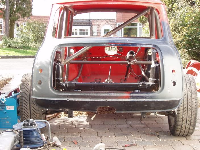

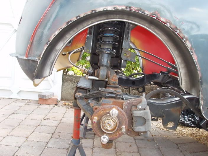

ok.. I did a bit of searching around..
Went to 16vmini site in UK and some guys have done their beloved vaxhaull conversion in the rear using a MGF frame.
The track seems enormous! :shock:
and these are fully inset modern wheels..
dont know what the engineer will think of this :?
The frame looks very good though.. these guys get rid of the original suspension and put on coil-overs
One way to avod this I thought would be to chop the frame in half and shorten it track wise and get rid of those suspension towers! :P
:twisted:
This is certainly one good way to do it..
Another thought I had was to just get a half cut of a MR2 and make a tube frame to use all toyota suspension bits and pieces which bolts on to the exsiting mini rear subframe mounting points. This obviously would be a bit more difficult than the MGF solution..
Any ideas welcome....

Also with the one in the picture you can steer the car from outside, I guess you have to be a fast runner...
But seriously I would go the MR2 route, as the engine configuration is already suited to mounting rearward. As for the frame I would go custom though this is a lot more work and you would have to be ultra perfect in relation to fabricating the rear suspension mounting points which the use of an existing subframe gets around. As for CV's and driveshafts. The Mini CV's have worked well for me for 2.5 years, replaced bearings once but these had been on the car for 5-7 years. The tyres will smoke up before you break the CV's unless you use huge tyres...

The pics above were of a an MGF subby and he was mounting an MGF engine into it.
