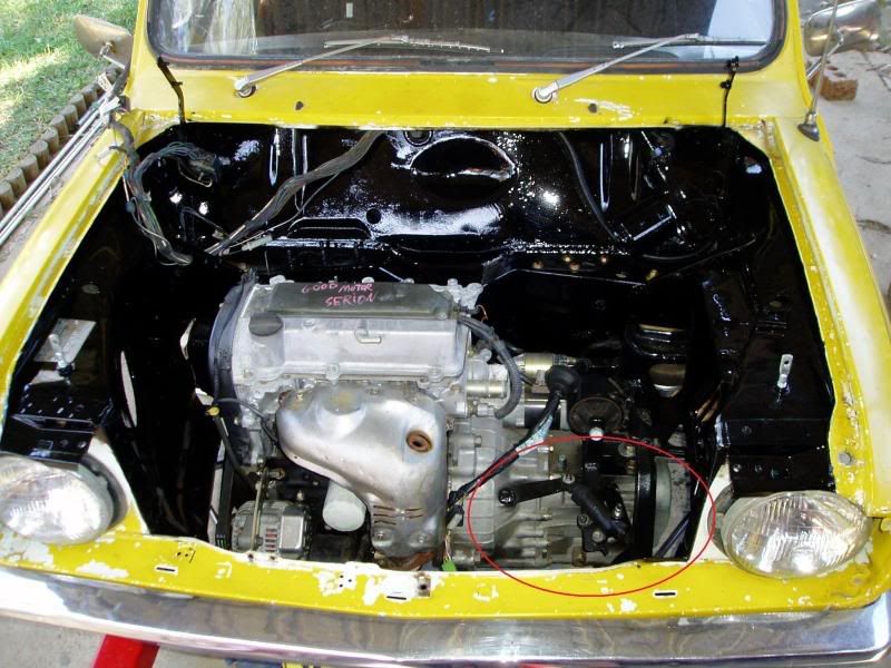

Because the mini is already hydro I would make a slave cylinder push the arm that the cable pulled as it would possibly be easier then making the mini pedal work a cable
I think the subframe mods would be very simular to toyota & suzuki subframes
I will post up a pic of my old cable to hydrolic conversion to give you an idea

like this
