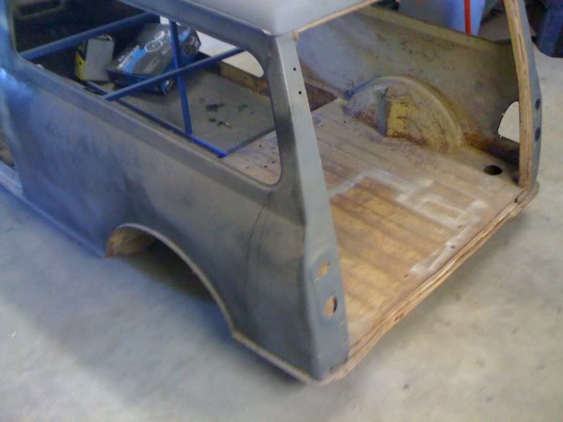

I replaced the front driver’s floor about 6 months ago and am really happy with the result. I also did the rear floor as it was rusted through in many places however I am not so happy with the result and it will come out and be replaced again soon.

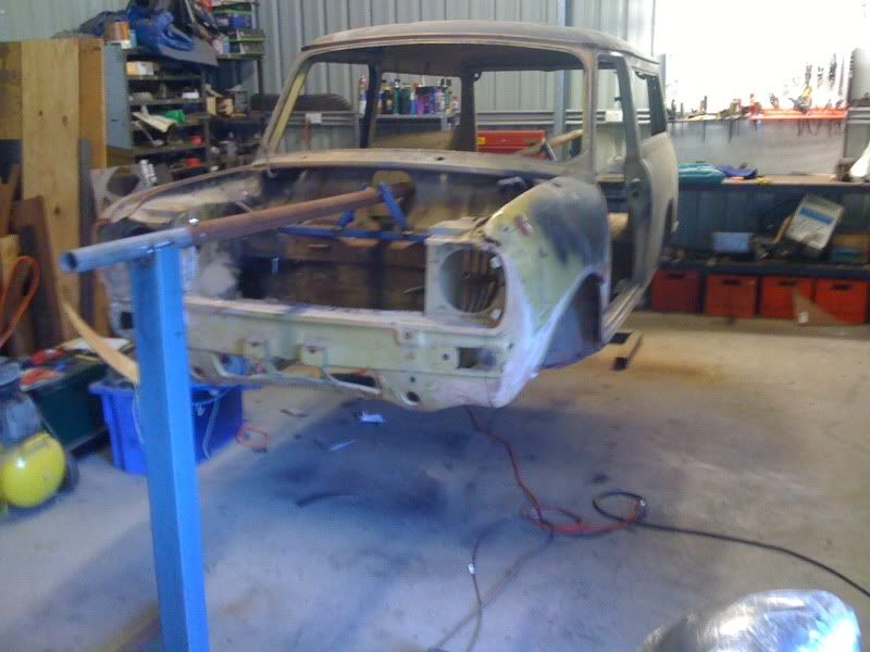

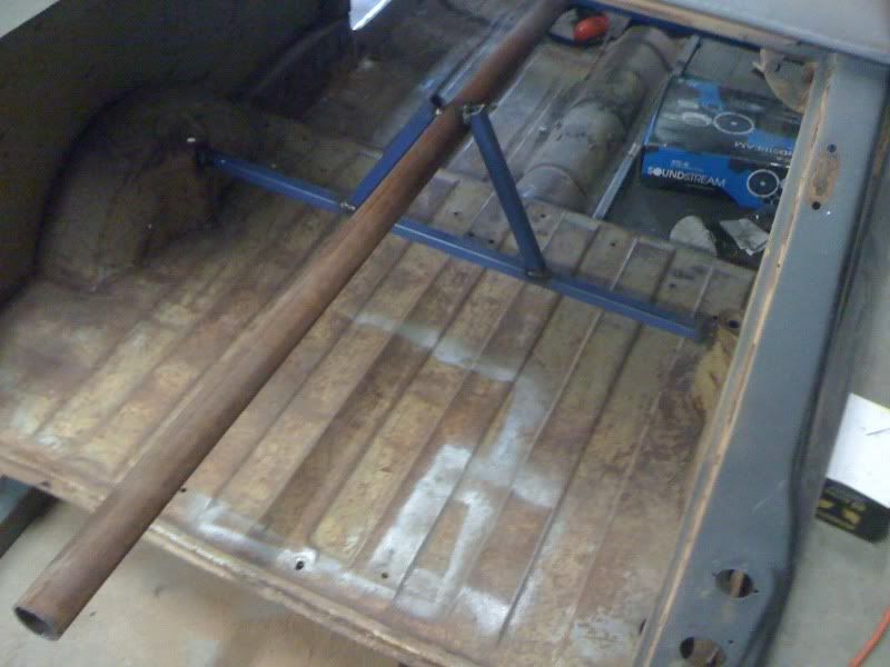

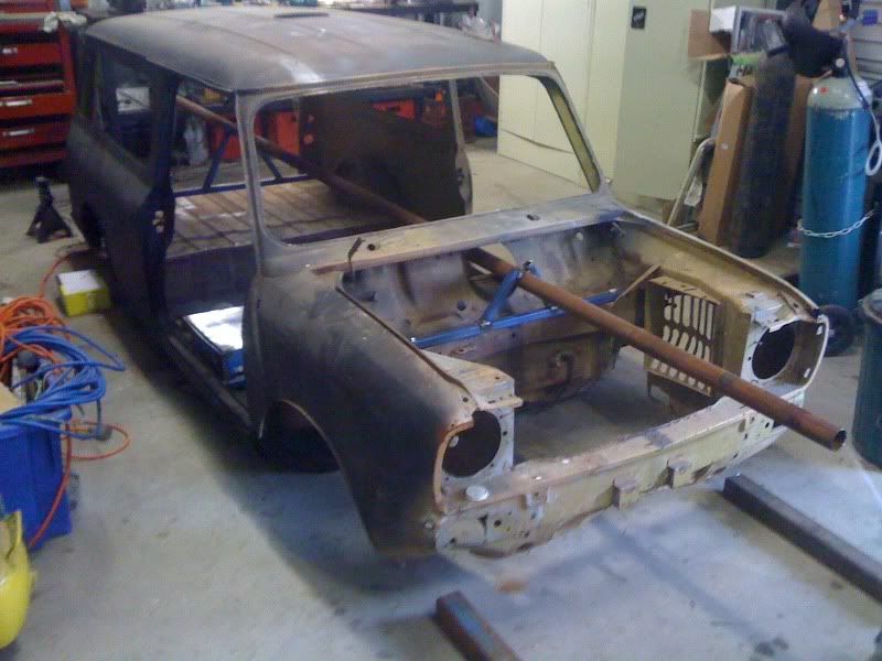

This weekend I decided the best way to tackle this shell (which in all honesty should be thrown out its in that bad condition) was to build a rotisserie. Here's some progress pics. I will get my decent camera back up and running this week for the next instalment of the build.
This is the shell before work on the rotisserie. I had welded in a couple of brackets between the B pillars - now which are gone.
I am planning on making the pole height about 1.1m. Does this sound like emough? I have measured and am sure that the car won't hit the ground when spun, but does anyone have experience that may be able to give me a pointer???
PostPosted: Tue Jul 28, 2009 9:14 am
The measurement from the center of the pipe, to the outer door sill is the minimum height you will need. Confirm by measuring from the center of axis to the outside edge of the roof gutter.
Add a little to this measurement and you won't have a problem.

Thanks Mick - thats basically what I have done and it all should stack up quite nicely. Can't wait to get it rolling about this weekend.

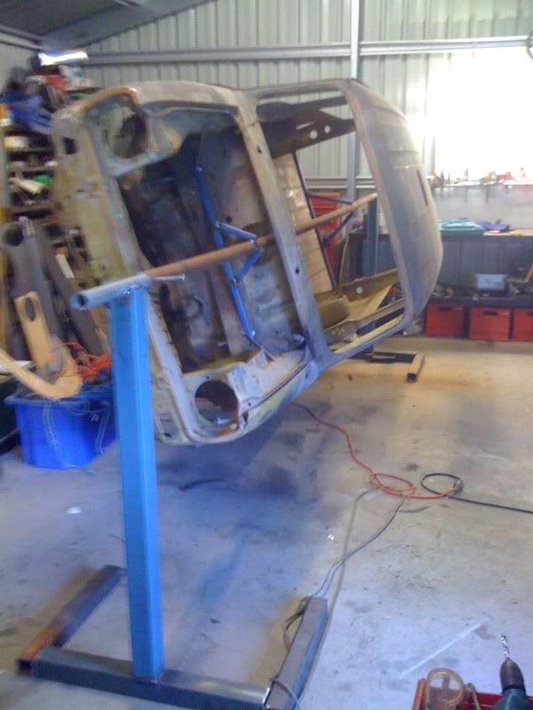

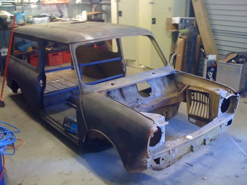

I have finished the rostissrie and got the panel van up on it!!!
I have replaced the front drivers floor, cut the passenger front floor out. I have purchased new sills and rear passenger floor.

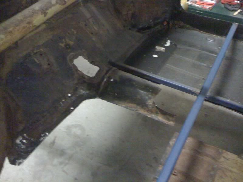

The rostisserie makes life so much easier! When I did the front drivers floor pan it took me ages to cut the old one out. With the rotisserie it only took me minutes!
The new pan is in the drivers - and all new support panels made and welded in for the firewall and subframe strengthening. Progress pic of the passenger side.
