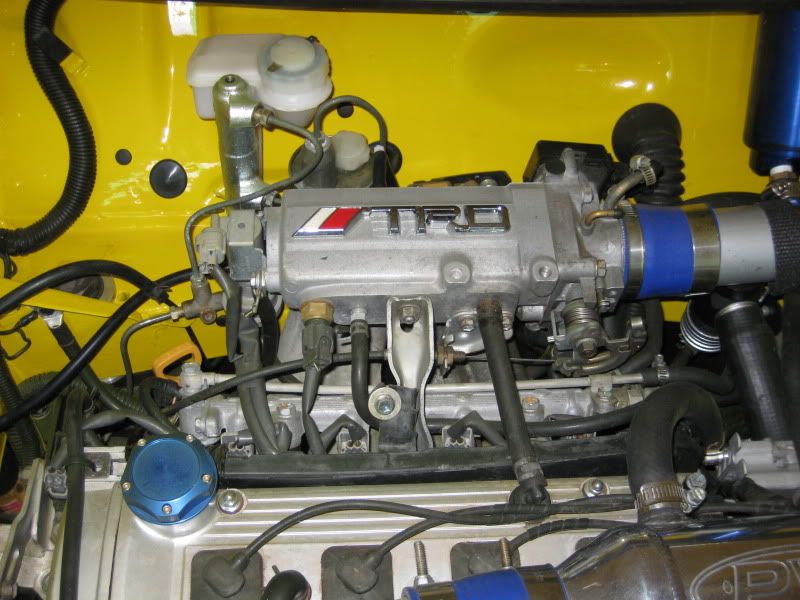

Yep, I'm afraid he's right. The front brakes go to the top of the M/C and the rears to the bottom.
I remember getting them wrong when I first hooked it up. I got no fluid to the front calipers. :oops:
This pic was taken after I fixed them up.
-James.
