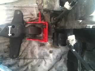

Has anyone else used an auto engine as a base for their conversion? Just putting my observations of parts that are different when swapping a manual box onto an auto engine. I used a 6 speed manual on mine, but its the same case as a 5 speed.
-The two top gearbox mounting bolts need to be swapped to longer bolts as the manual bell housing is thicker.
-The rear gearbox mount is a different thickness, like in the picture below.

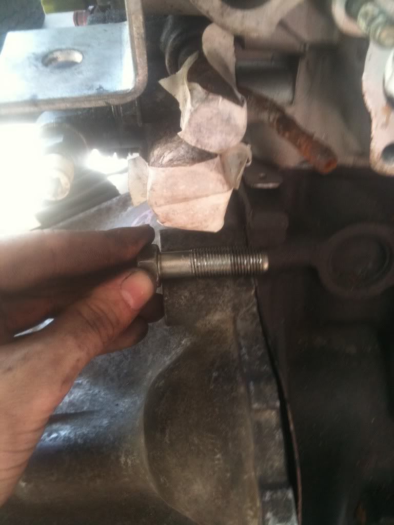

Few more findings on this,
Does the auto have a diffferent starter motor mounting than a manual?
The auto one i pulled off had a bolt that went through the bellhousing and into a thread on the starter motor, and the other bolt went through the starter and into a thread on the bellhousing.
Ive swapped to a 6 speed manual, but theres no thread to bolt the starter motor onto. Anyone had this happen?

blue_deluxe wrote:
...Does the auto have a diffferent starter motor mounting than a manual? ...
Must be - My (manual 'box) starter motor has two bolts that mount the starter motor to the bell housing, and they are both through the starter and into threads on the bell housing.
