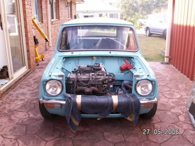

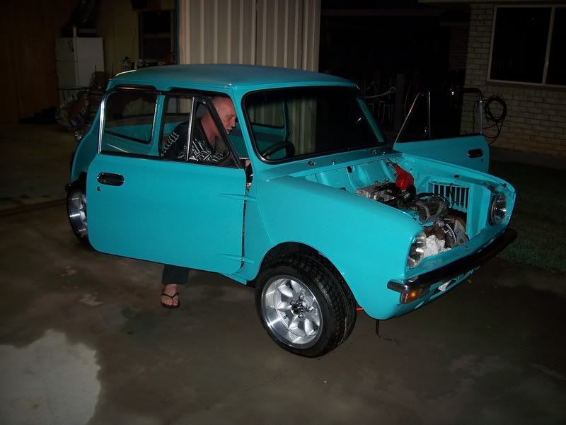

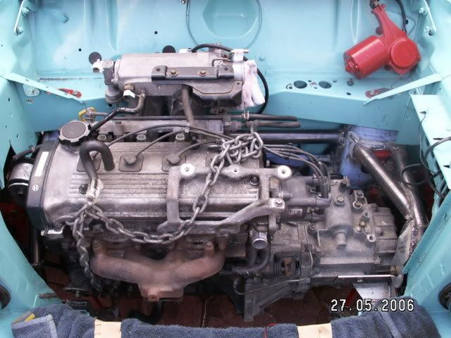

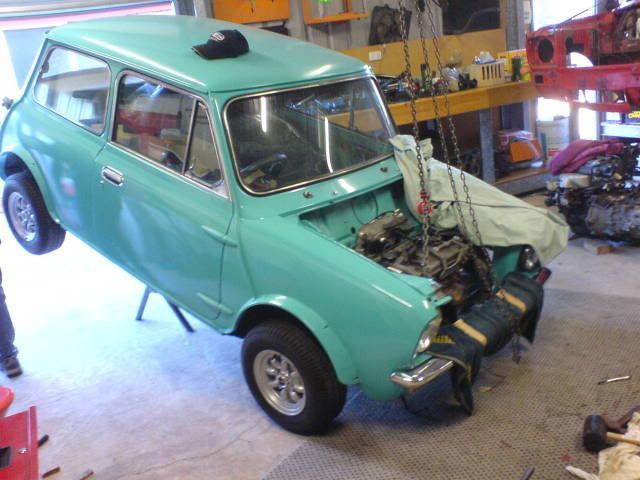

The car was booked into the workshop and work was begun in earnest. After three days of toil, Barbie had a new heart and everyone was happy and the minstrels did sing. This is a pic of the car near the end of the operation. Cant remember why we had it jacked up like that - seems kinda silly now though.

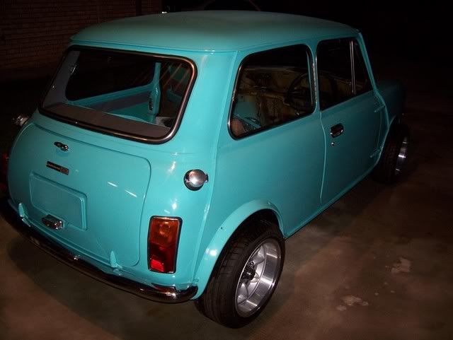

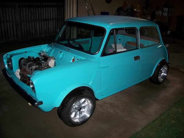

And here she is outside getting some sun:

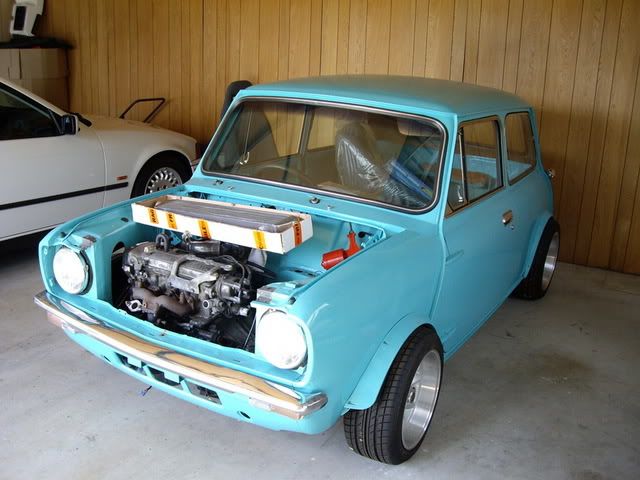

And the fruits of our labour. Barbie is modelling for us the latest QBR Mk III subframe for Clubmans. All you Morris owners, check out how much room there is!

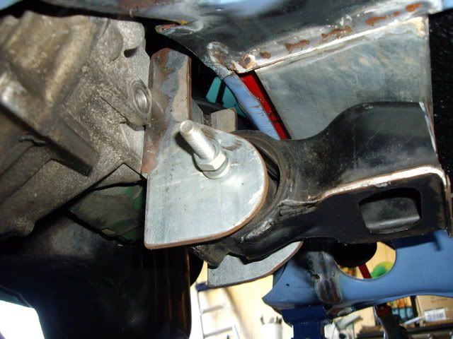

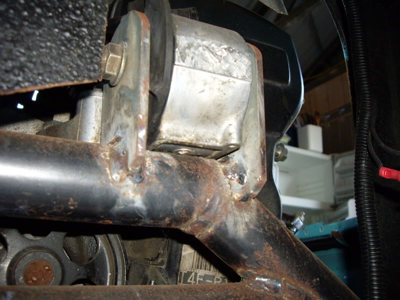

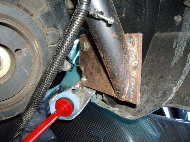

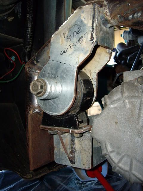

Now for some close-ups. Here is some pics fo the passenger side engine mount and engine mount bracket:

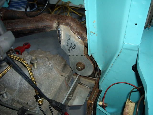

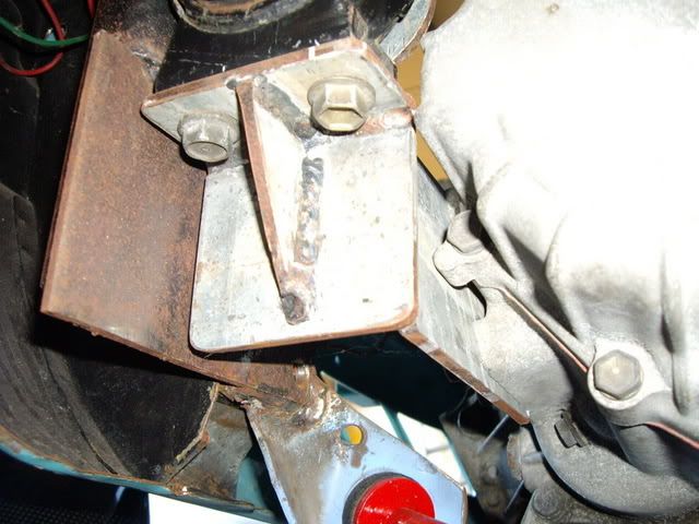

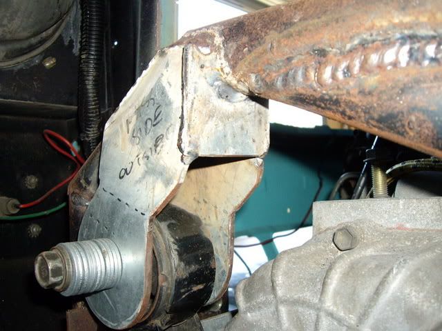

Lets not forget the drivers side engine mount bracket:

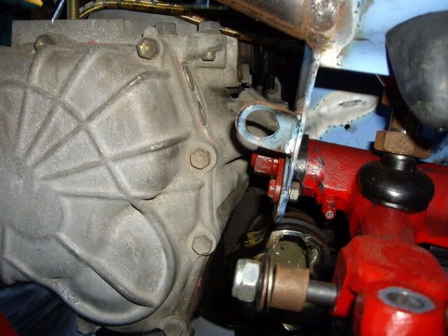

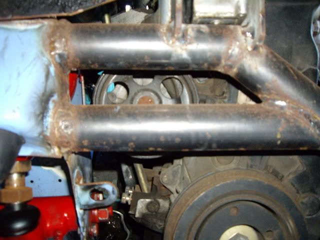

This is the passenger side spar - note new brake line tabs and how close the water pump pulley is to the tower.
And a shot of the passenger side showing the clearances we have to deal with:

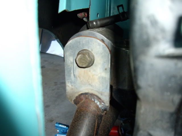

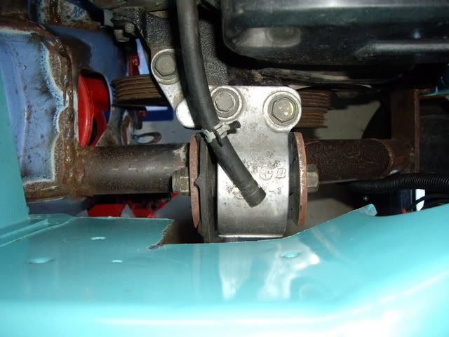

And finally, a close-up of the rear engine mount.

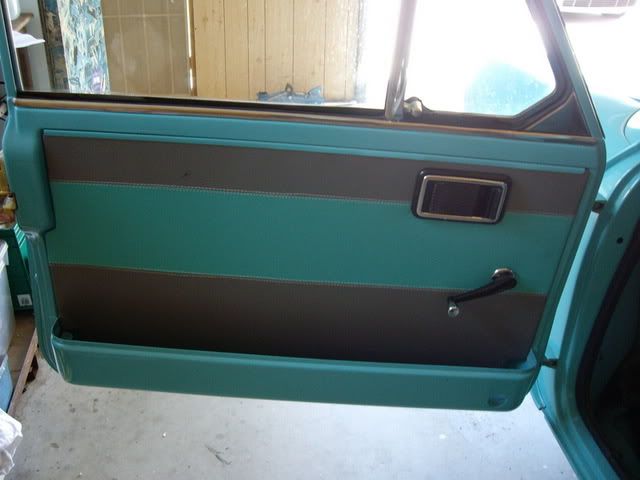

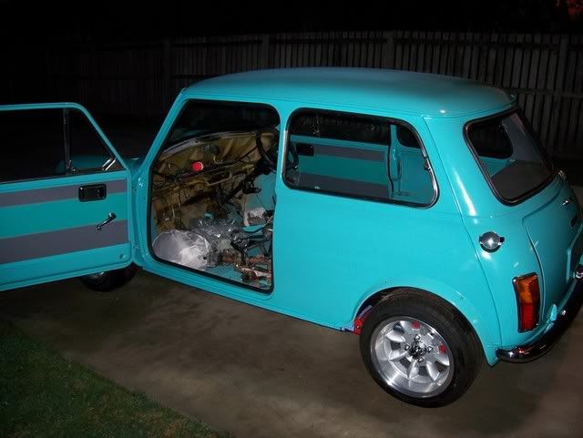

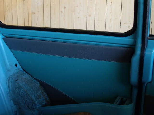

Now, before Barbie even came to QBR to get the engine conversion done, Tony had spent quite a bit of coin on getting the interor done. I kinda like the simple, yet elegant use of colours. Its not underdone, and certainly not overstated:

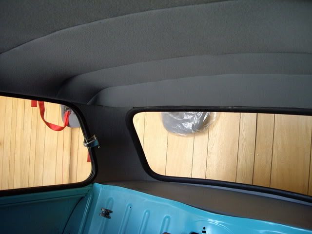

And even a new, home made hoodlining:

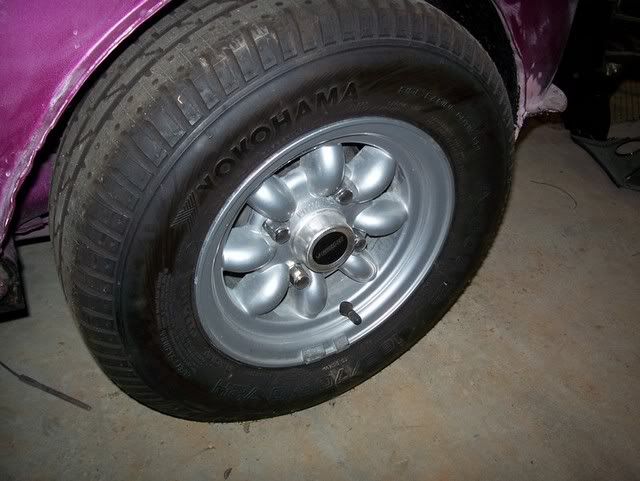

And here are the new hoops. 13 x 7 Superheavies with Sime 175 tyres (all brand new):

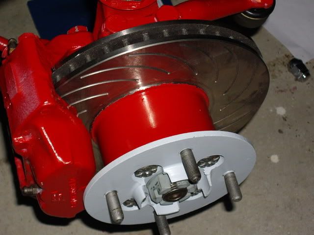

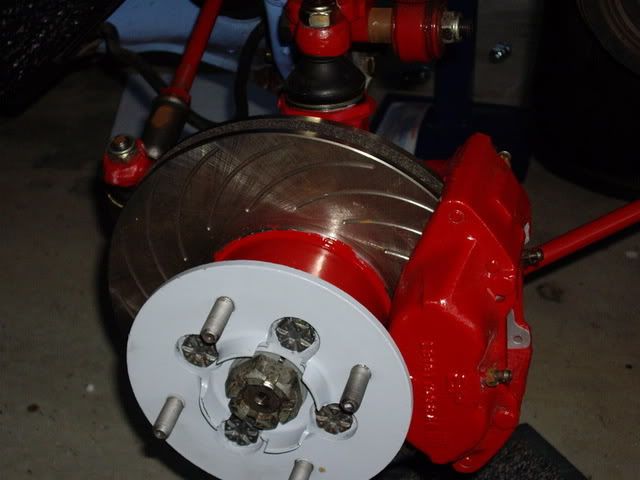

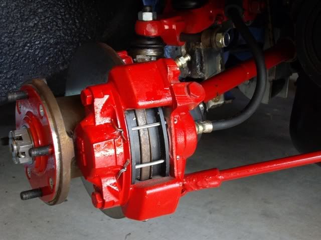

And this is the reason why. Tony was running 7.5" solid discs on the front of his Clubman. As we all know these have to be uprated to ventilated brakes. So it was out with the old, and in the new:
And Tony scored these Metro 8.4 vented, with hubs and flanges for a miserly sum. They were in need or reconditioning though:

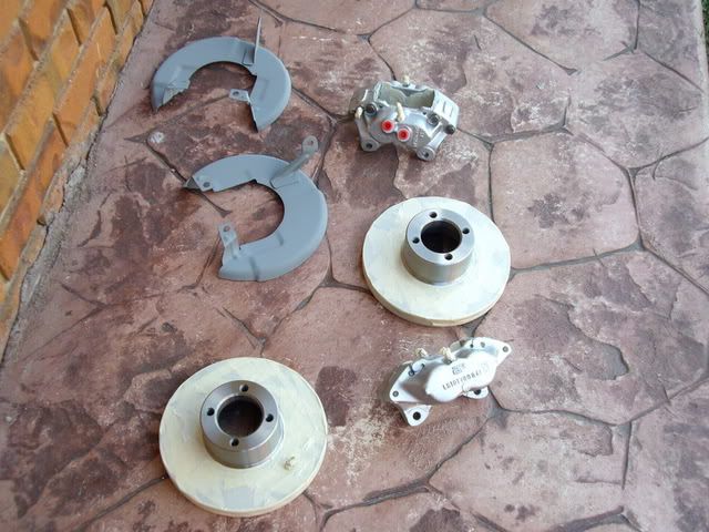

And after reconditioning and ready for painting:

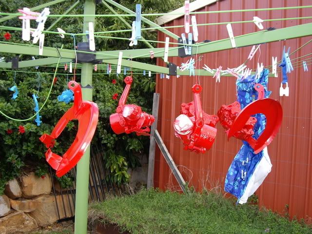

And here they are drying on the clothes line. Its a nice blood red to match the previous brakes colour and other suspension components:
And then, some more waiting. Forever waiting. Here is a picture of Barbie looking all forlorn and in need of some love and attention. She has got the big hoops on though!

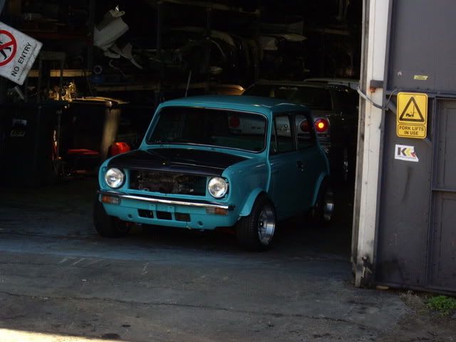

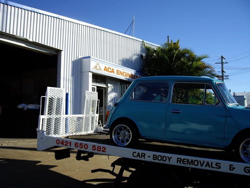

Well Barbie had her big day out Saturday, and she stepped out in style. As a matter-of-fact, she got a lift. The nice man in the flatbed arrived promptly to escort Barbie to her first date for the day, ACA Engineering.
The nice gentleman at ACA Engineering warmed their hands and gently put them up Barbie's skirt, to have a quick look at her shaft - drive shafts that is. Some thing that is best left to specialist machinists with specialist machines I'm afraid. Once all the measurments are taken, the lads at ACA will cut the standard Starlet shafts to length, then turn a Mini spline onto the end - simple stuff (not!).
Well Barbie stuck out her tongue, coughed when she was suposed to, and then it was all over - they were very gentle!! After getting the once over from ACA, it was off with the rubber gloves and onto our next appointment, which were the lads at STZ Automotive at Northgate in Brisbane. Here at STZ, Barbie will get her exhaust manifold fabricated, as well as her dump pipe and exhaust system, they may also have a look at adapting the front mount intercooler so it sits behind the beaver panel - quite a bit of work.
Here's Barbie on the truck, obviously showing a bit of wheel must work!
And visitng the nice men at ACA Engineering. Barbie like the ride so much she didnt want to get off!
And here we are outside of STZ - she will be here for a couple of weeks while all the work is getting done.Lets hope she gets on with everyone and she doesnt get too homesick!
At the end of the day - good bye Barbie, see you soon!

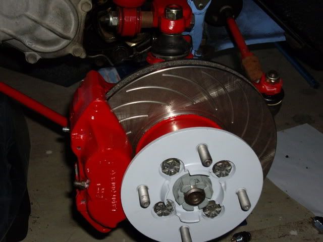

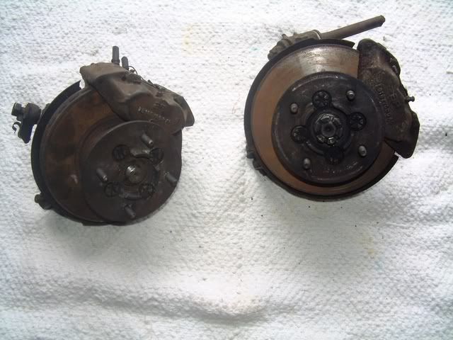

On another note, got a request to show Barbie's replacement brakes. Off with the old solid 7.5's, on with the new vented 8.4's........................
Obviously looks a little underdone with the drive flanges still in primer, it will look a bit better when they have recieved their coat of red topcoat.

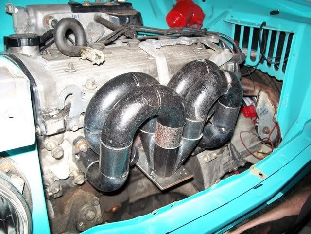

The car has been left in the hands of STZ Automotive to get the manifold, FMIC and plumbing done. Also, they have to fit the radiator as well.
That's a lot to go into a small engine bay like a Clubman, not to mention an even smaller engine bay like a Morris. So it all had to be done right.
STZ were struggling with the concept of performance, weight, aesthetics and fitment - some of these were diametrically opposed goals - what would work for one worked against the other ones (after all, they had never done a Mini!).

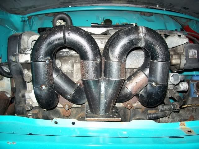

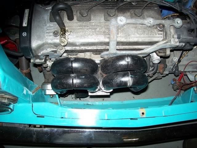

After having a chat with them about how they wanted to do the EM (I didnt agree with there proposal), I went home and decided to design the EM to try and do all of the above, and I believe I have triumphed. It had to flow big volumes (I said twice the original), it had to be tuned equal length, it had to have uni-directional flow at the collector, it had to position the TD04L in the right place, and of course it had to be strong and robust enough to endure the rigors of Tony's driving.
This is what I came up with, and the boys at STZ cut and tacked it together, beautiful!!
I think its a work of art - thanks SolidWorks!!
And I have an equally ingenious solution to the intercooler probelm - stay tuned!
