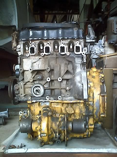

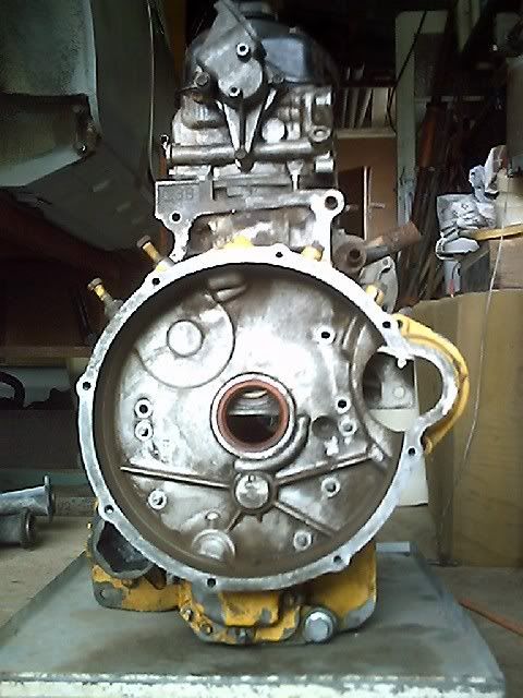

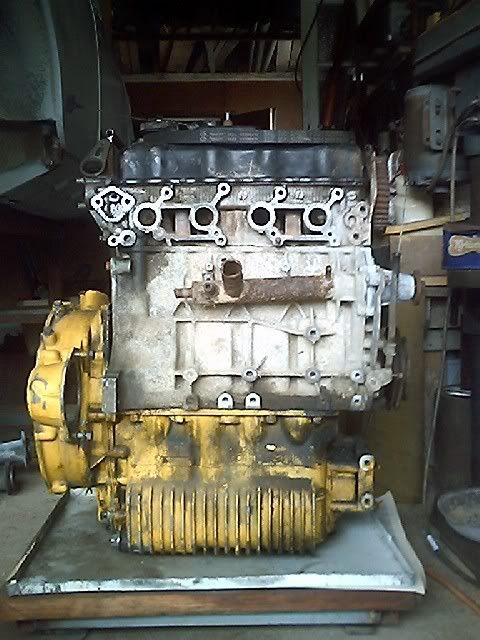

It's been brought up before http://www.ausmini.com/forums/viewtopic ... e+mini+box and now I'm foolish enough to try it myself.
This is what the guys in England have done so far http://www.minicooper.org.uk/ and http://www.16vminiclub.com/forums/viewtopic.php?t=9394 and this is what I've done:
If you look at their photos you'll see that they've cut about 2-3 inches off the top of their box and of course I only noticed that when I put mine together :evil:
So a couple of Q's. What's easier/better, cut the box down with the angle grinder or find a machine shop that can machine it down perfectly level and to the exact height? Obviously I'll need to weld a new plate onto the mini box so the Suzi engine has something to bolt on to so I figured their would be some distortion :? . My idea is to cut the box down, weld on the plate then machine it to level.
What do yous think?
