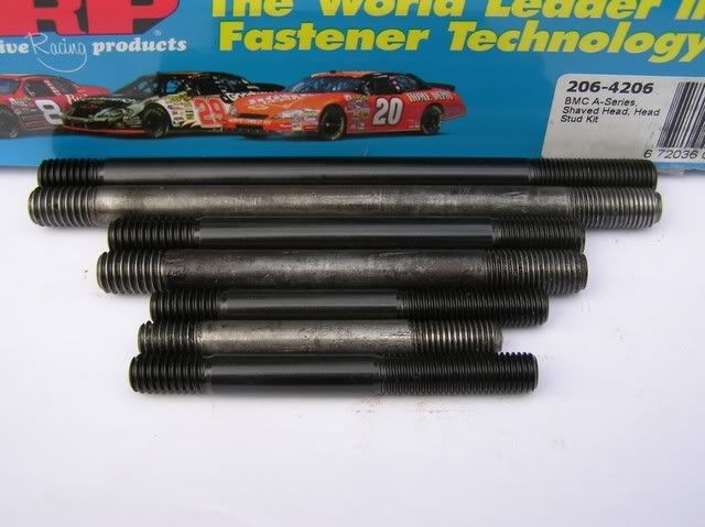

Just got my shaved studs from the US of A, part number 206-4206 and this is what they supplied
2 @ 3.0
2 @ 3.125
7 @ 4.0
4 @ 5.45
The shaved ones are the same length as the S ones I've removed (ones with the dimple in the end) although thread engagement in the block is different. Photo is a comparison of ARP versus "S" studs. Its an optical illusion but they are the same diameter. Washers supplied are very thick and maybe a problem.
Member VMCI #19
PostPosted: Sun May 18, 2008 9:53 pm
Posts: 1084
The washers should be .120" thick, your head has been shaved more than mine, shouldn't be a problem. Let us know tho.
